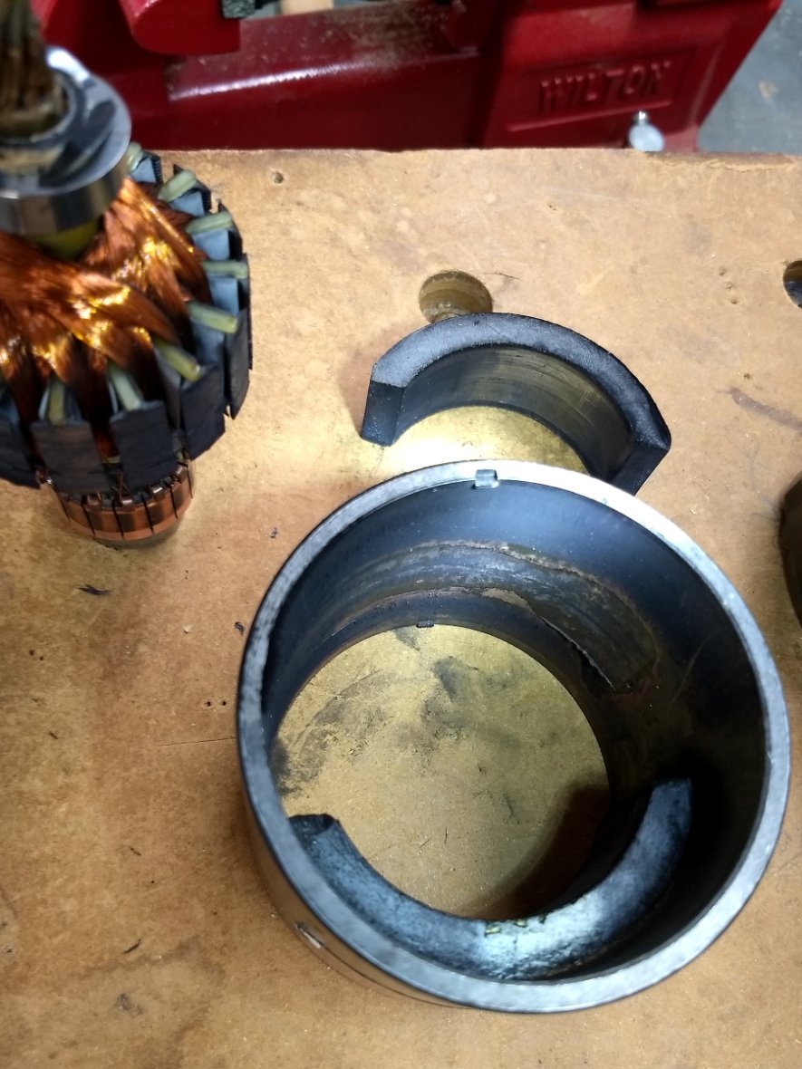

My Pro Planer feed motor died yesterday while taking light cuts in pine. The motor measured open-circuit, so I pulled it apart to see what I could see. Inside, I found a failure mode that I've never seen before. The root-cause problem was that one of the magnets on the stator had come detached from the stator housing.
- Detached magnet.JPG (170.14 KiB) Viewed 2000 times

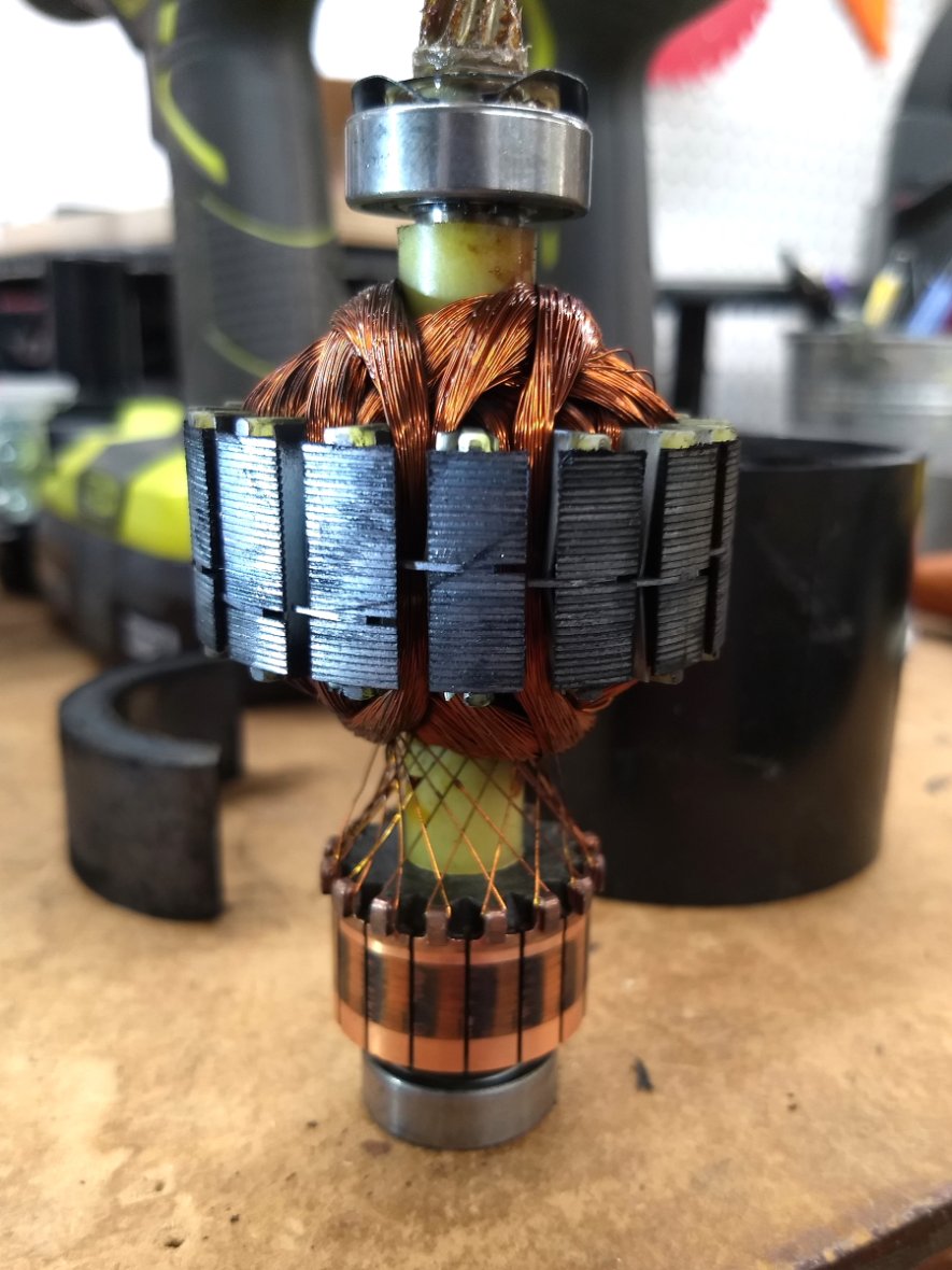

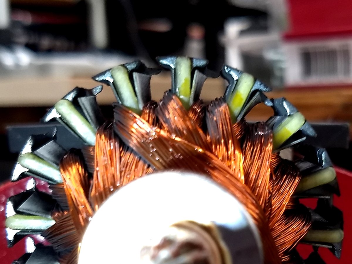

The magnet was trapped in roughly the correct position by the rotor and the mounting screws, and the motor had continued to run for a while. I didn't hear anything amiss, probably because of the noise from the cutterhead and its motor. Anyway, the armature had obviously been grinding against the magnet, eventually bending several of the iron laminations.
- Bent laminations 1.JPG (142.79 KiB) Viewed 2000 times
- Bent laminations 2.JPG (164.42 KiB) Viewed 2000 times
I think what eventually killed the motor was that one of the bent laminations cut a winding. I found at least one completely open-circuit segment on the commutator.

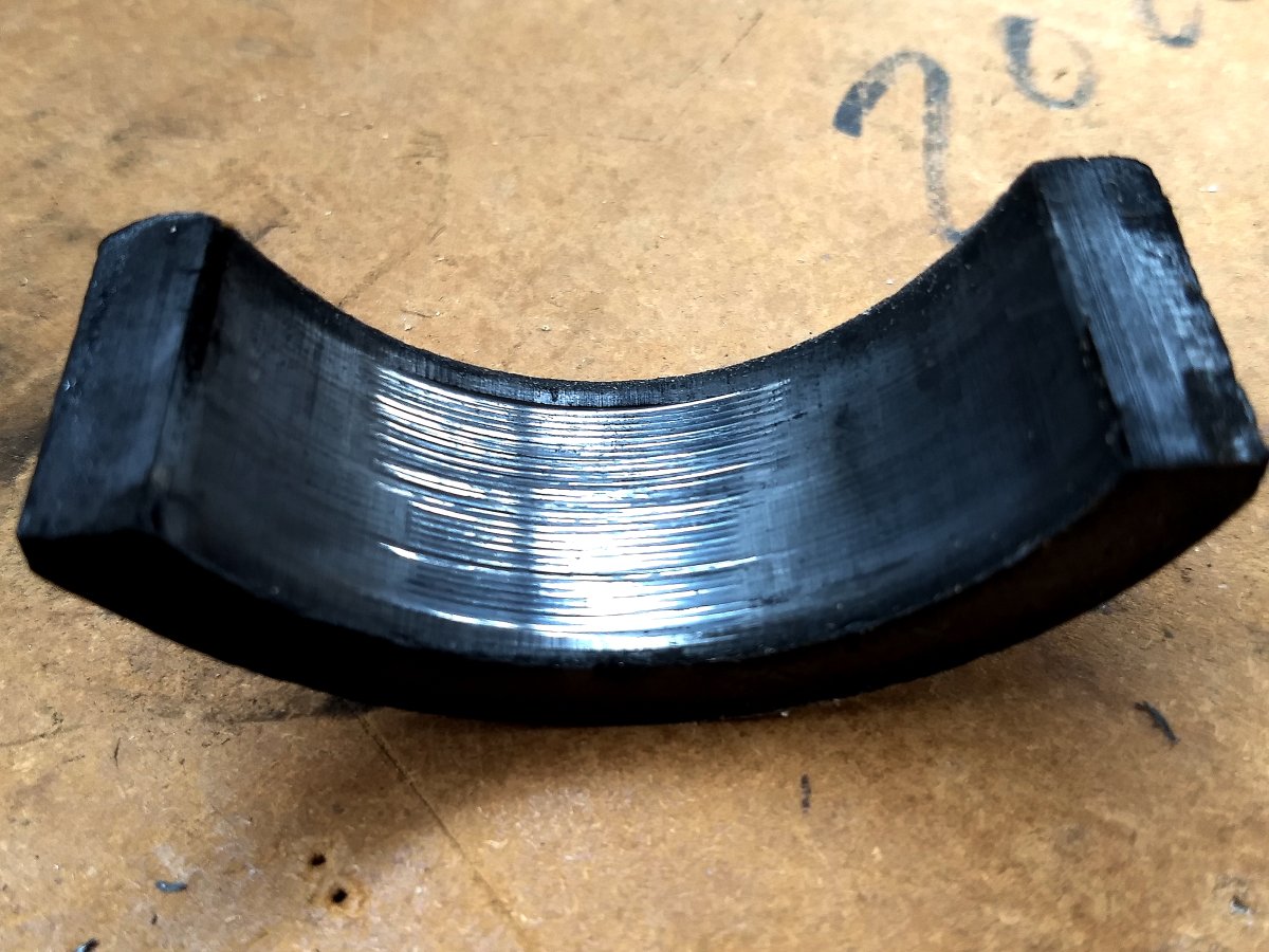

You can see the scoring on the inside of the detached magnet, where the rotor was rubbing on it.

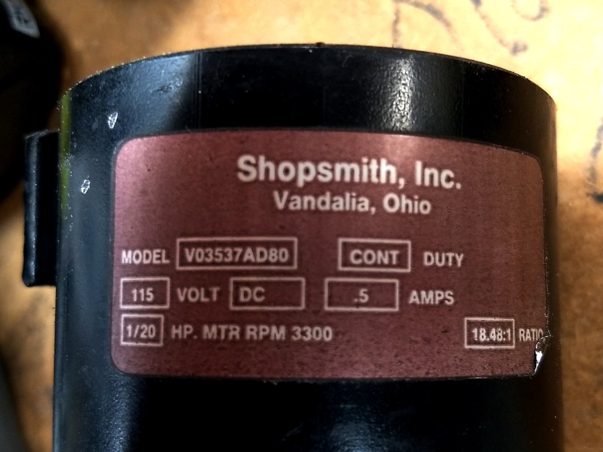

I'm the second owner of the planer, but the commutator shows no significant wear, and there is a lot of brush length left. So the motor was nowhere near the end of its design life. But as you can see, this particular motor is well and truly trashed.
- Motor label.JPG (139.57 KiB) Viewed 2000 times
The Mothership shows new a feed motor
here for $495, but the part number doesn't match my Pro Planer manual. Maybe it's the one for the Shopsmith-mounted planer? Regardless, I can buy a complete used planer for less that that. If anyone has a better solution, I'd love to hear about it!

Hmmm. That is indeed the part number given in my Pro Planer manual. When I checked the SS website for it a few days ago, the service-parts list for the Pro Planer showed it as unavailable,and it still does. But when I search for the part number on the website, it takes me to the product page for that part number, which shows it in stock and on sale. Maybe they found some inventory hiding in a dark corner of the warehouse.
I believe that the Pro Planer feed motor has a higher max RPM than the Mark-mounted feed motor, presumably because the planer-stand motor has more horsepower than a conventional Mark V motor. I’d bet that the only difference on the Pro Planer feed motor is a winding with a lower back-EMF constant.
