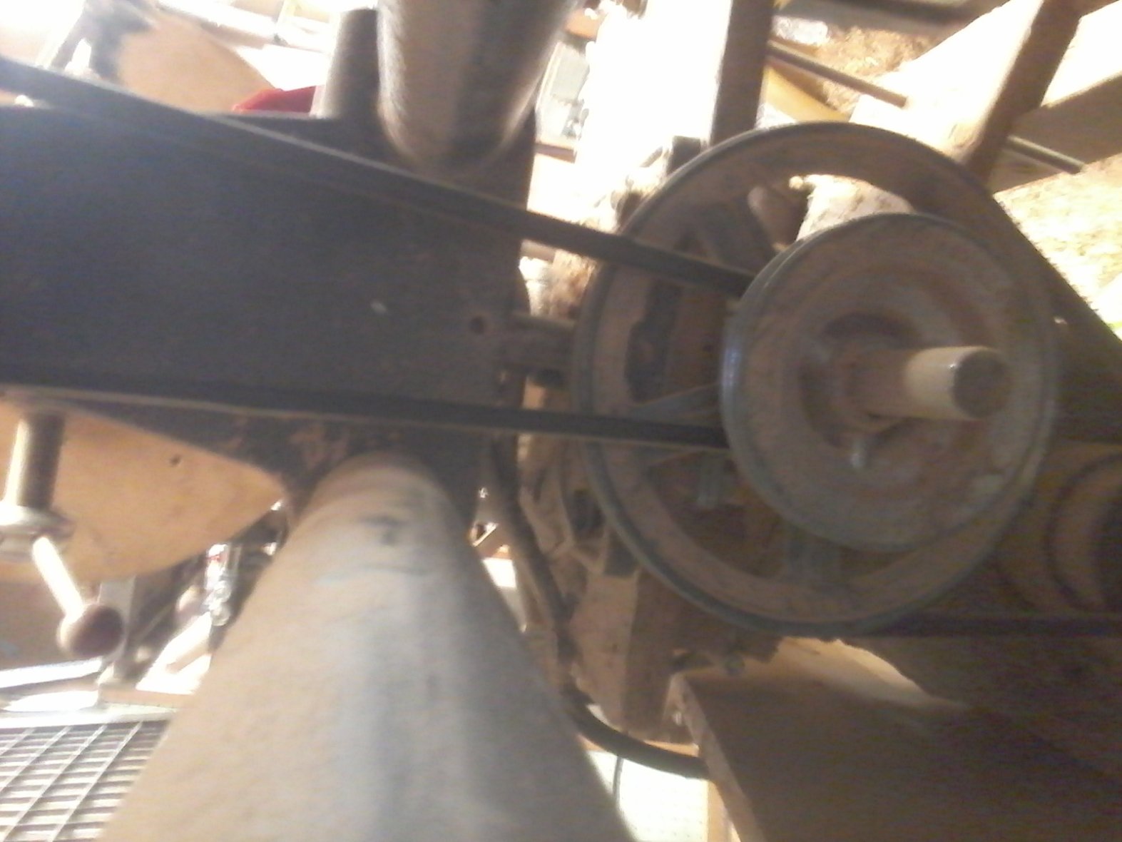

Posted: Mon May 30, 2022 9:14 am
by BobCoates1953
Not electric but changes speed for lathe work.
The motor three-speed pulley was moved from motor to jack shaft, and
then add 4" split sheaves pulley on the jackshaft and a split sheaves
on the motor. The motor and jackshaft were mounted on ¾" plywood and
hinged at back. A crank of thread rod was put in the front to adjust
the hinged V to get tension on the belt between the split sheaves
pulleys.
If I remember correctly I bought the pulleys at Grainger. Here is
description from the web site.
Motor SHEAVE,VARIABLE PITCH part 3X273
Single Groove Variable Pitch Sheave, OD 3.15 Inches, 3L Belt Pitch
Diameter 1.7-2.5 Inches, 4L or A Belt Pitch Diameter 1.9-2.9 Inches,
5L or B Belt Pitch Diameter 2.4-3.2 Inches, 3/4 Inch Bore Size, Cast Iron
Jackshaft SHEAVE,VARIABLE PITCH part 3X266
Single Groove Variable Pitch Sheave, OD 4.15 Inches, 3L Belt Pitch
Diameter 2.7-3.5 Inches, 4L or A Belt Pitch Diameter 2.8-3.8 Inches,
5L or B Belt Pitch Diameter 3.1-4.1 Inches, 3/4 Inch Bore Size, Cast Iron
Standard ¾" rod, don't know where I got bearings for jackshaft.
