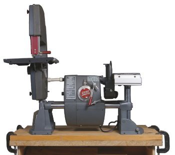

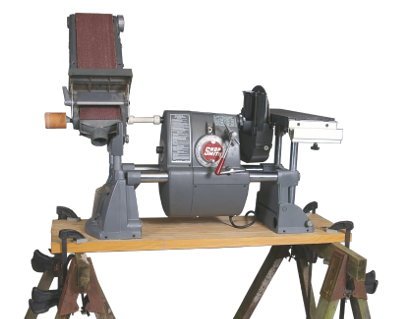

Below are pictures of the Shop Deputy from the Shopsmith online catalog to give you an idea of how it looks with the 26" Shop Deputy Way Tubes.

You may also be interested in the following thread if you haven't seen it already.
viewtopic.php?t=29285
