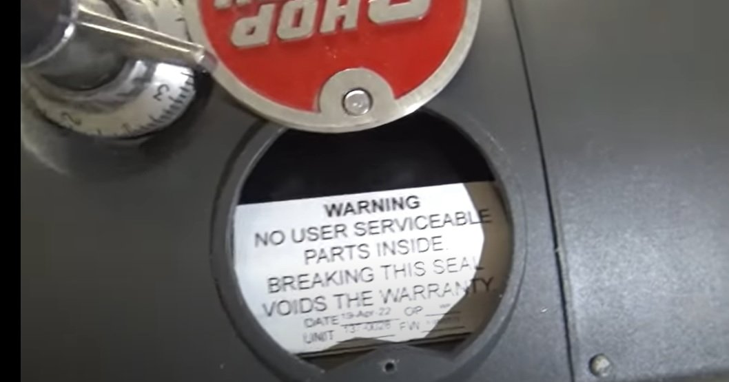

This Woodshop Nerdery video, maybe the same one above, at 8:57 shows a seal over the inspection port on the back side of the headstock. I hadn't heard about that so far, does that mean a new headstock has to be returned to Shopsmith if it has a problem under warranty?
The new fasteners on the sides clearly go through the casting, and could be the motor mounting screws, but I think the mount must have changed for a new position. Not hard to do if it's only the intermediate mounting block. The current service parts diagram for the Mark 7 headstock doesn't show those fasteners.
Ed from Rhode Island

Is the inspection port completely sealed off now on new PowerPro's??? IF so, that is very disappointing. I would want to install supplemental cooling for positive air displacement in the headstock should I ever purchase a PowerPro. Disappointing if Shopsmith has blocked off this access port now...

edma194 wrote: Thu Jun 23, 2022 4:25 pm This Woodshop Nerdery video, maybe the same one above, at 8:57 shows a seal over the inspection port on the back side of the headstock. I hadn't heard about that so far, does that mean a new headstock has to be returned to Shopsmith if it has a problem under warranty?
I hadn't watched that one yet. I think the seal is just on the Power Supply, I have the same/similar seal but I'm not sure if it is in the same location.
Please look at the video again and LISTEN to what he says. It is not a seal on the inspection port. It is a warning label on the computer control box inside the head stock that happens to be visible from the inspection port..

DLB wrote: Thu Jun 23, 2022 8:03 pm

jsburger wrote: Thu Jun 23, 2022 8:28 pm Please look at the video again and LISTEN to what he says. It is not a seal on the inspection port. It is a warning label on the computer control box inside the head stock that happens to be visible from the inspection port..
Well that was kind of dumb. I was looking for shots of those screws and didn't have the sound on. Should have at least turned on sub-titles.
