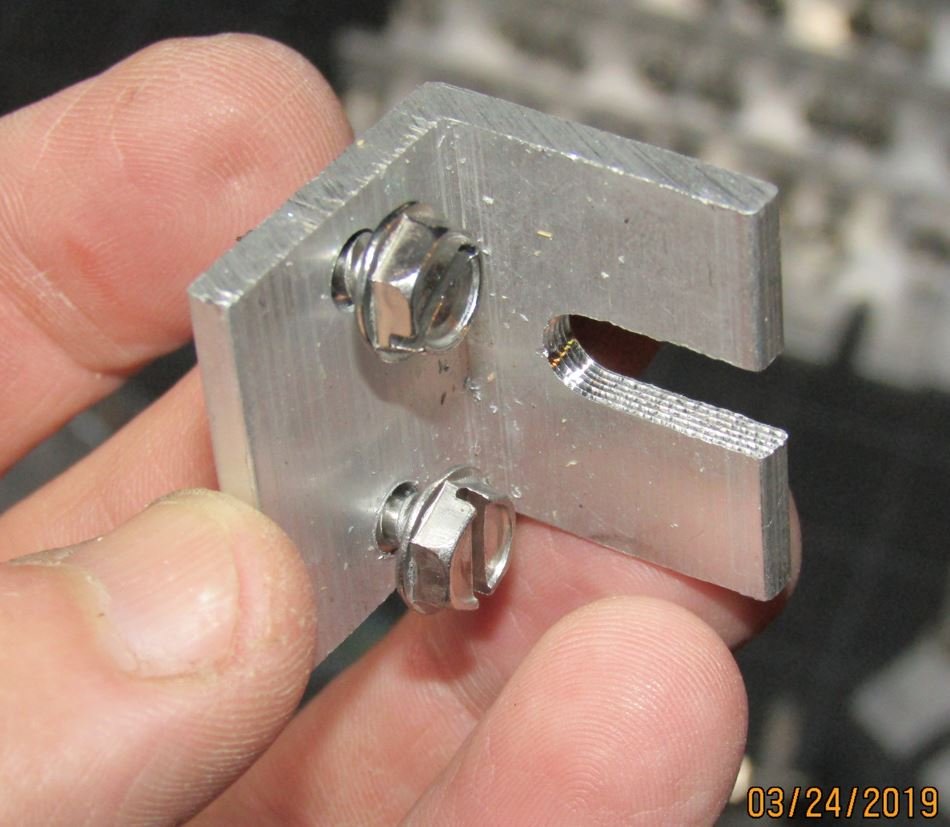

I made up a lot of these aluminum angle brackets using the Shopsmith and a 3/16" diameter milling cutter + drill press + bandsaw.
I got useable brackets but a lousy finish and positional accuracy/repeatability. Shopsmith RPM is too slow and frame/table just does not have the rigidity needed to get results comparable to a milling machine. Better fixturing and a speed increaser would have helped but I did not invest the time/money. Not the fault of Shopsmith really...

Brackets like above can be made from angle stock, but mainly through cutting with saws and drilling. I want to find a heavy cross slide and see if actual milling operations can cut cleanly but vibration is the main enemy.
