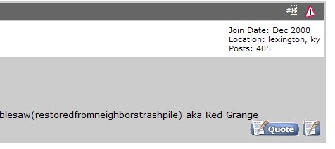

ED How did you do the single post link????

When you get to a thread the post number is to the right, as shown below the post was number 8. If you click on the 8 you see that post only and you can get the URL at that point. There are other ways but that is an example of one simple way to do this.
[ATTACH]3235[/ATTACH]
jpg40504 wrote:ED How did you do the single post link????![]()
Dusty: Just noticed you added the MArk 5 manual while I was 'typing'. Looks like a 1960's version . . . . Point?
- for example.jpg (11.72 KiB) Viewed 7913 times
Looks easy! I will try it!
http://www.shopsmith.net/forums/showpos ... ostcount=9
YEP It WORKS! Thank You!
