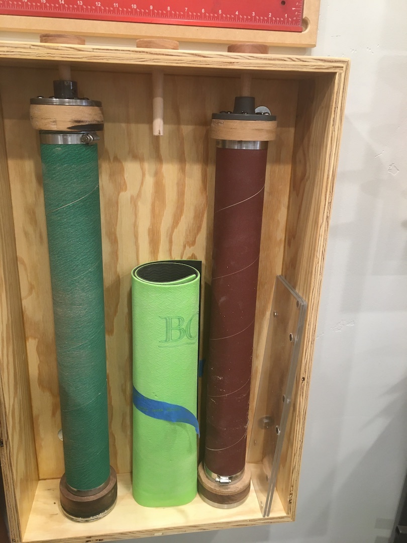

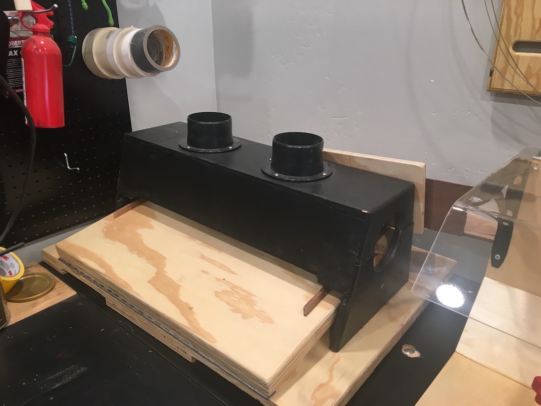

I built a drum sander for my SS using the design from Keith's Shop (https://www.youtube.com/watch?v=SHbhHCmVTIg). I mostly followed his idea, but did add a plexiglass window so I can see inside the sander when sanding. I also have two 4" dust ports on top and no dust escapes the sander. As for the drum, I worried about the flex of PVC and so purchased two, 24" long 3" diameter aluminum drums. I have 80-grit mounted on one and 150-grit on the other. The drums mount to the SS via 4" faceplates which makes them easy to take on and off.
The sander can handle a width of about 21" (I glued bumpers to the table to prevent workpieces contacting where I secure the sandpaper to the drums with hose clamps) and thicknesses from 1/4" to 2" (change thickness via a hand crank). Works great for both end-grain cutting boards and rings!
