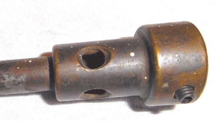

edma194 wrote: Sun Jul 24, 2022 1:27 pm Is 10 made of brass or copper? Just from the side it looks a lot like a torch tip. The shadow shows an opening at the end by those holes on the side.
Thanks edma194!
Ah, the ol' Shopsmith torch attachment 🤣

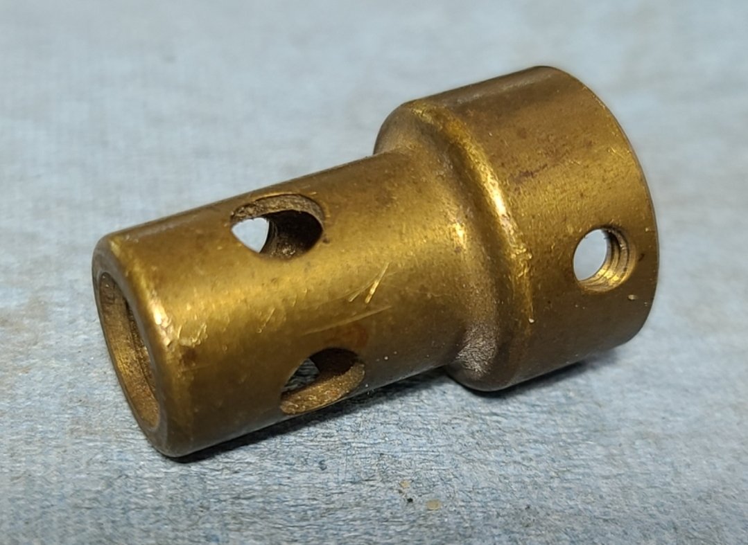

It really could be an old torch tip, here is a better pic
Definitely brass, the hole on the larger end is threaded like it had a locking screw at some point. That is why i thought maybe an adapter, but brass would be an odd choice for that...
Those vent holes do kinda maybe look torchy though
It looks very similar to the soldering tip for an old Bernz torch shown at this site, without the flat end tip attached. The 4th closeup pic shows this kind of part with the tip attached. Brass body torches used to come with a set of tips including a flame spreader and soldering tip. This could have been part of any of several specialty tips. I think brass construction makes it very likely.
Ed from Rhode Island

edma194 wrote: Sun Jul 24, 2022 5:28 pm It looks very similar to the soldering tip for an old Bernz torch shown at this site. The 4th closeup pic shows this kind of part with the tip attached. Brass body torches used to come with a set of tips including a flame spreader and soldering tip.
Nailed it!
It even has the threads where the soldering tip would screw in.
My dad had an old bernz-o-matic he would solder with.
Excellent catch!
