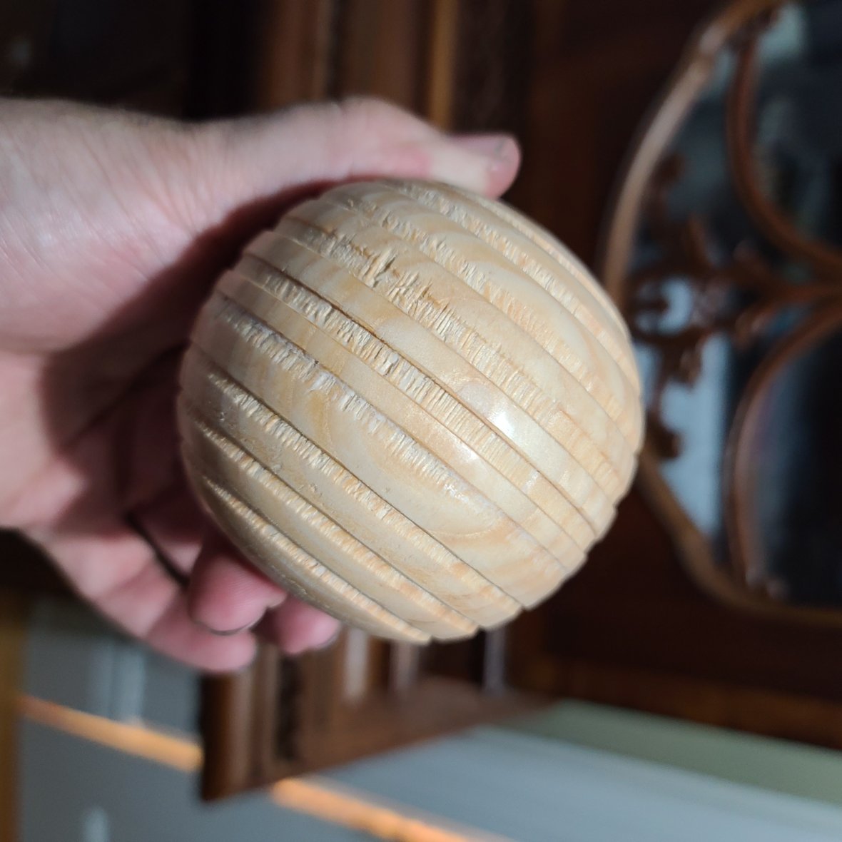

rpd wrote: Mon Jul 25, 2022 3:49 pm #3 might be the handle for a ball valve, or shut-off valve of some type.
That could be, i stuck it in a bin to see if i need it later.

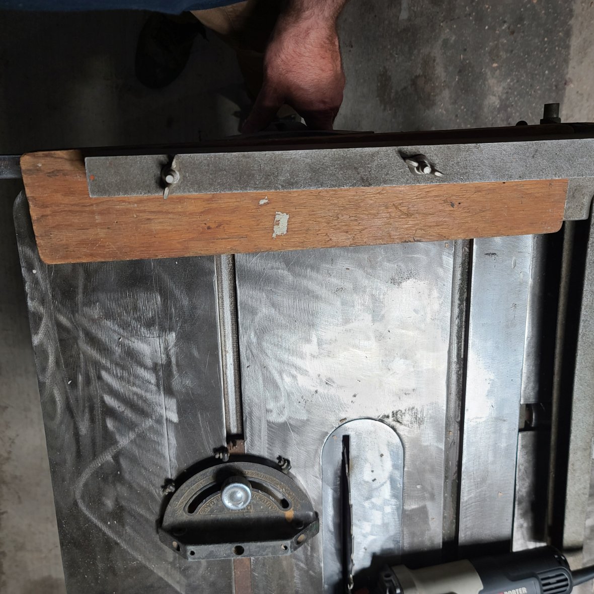

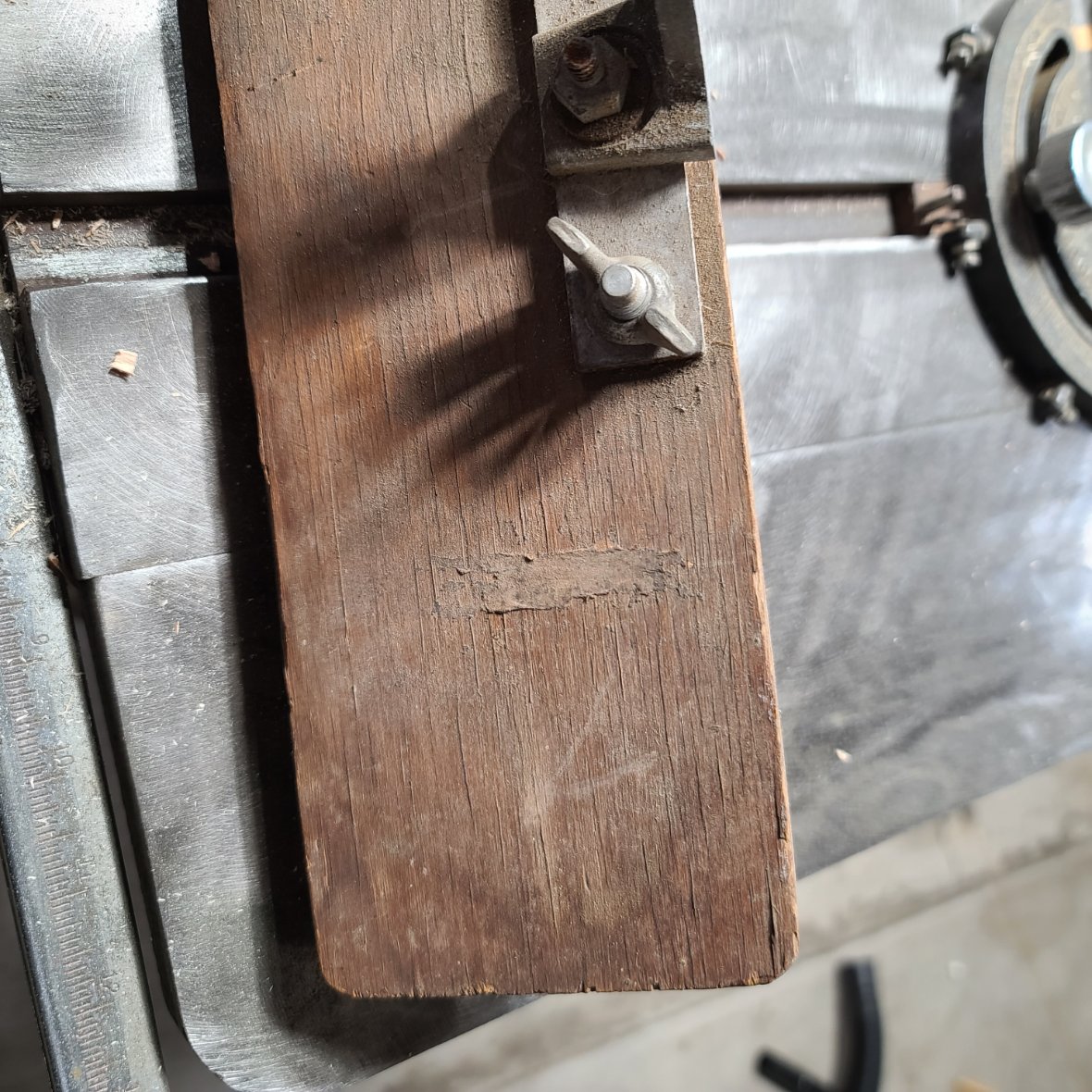

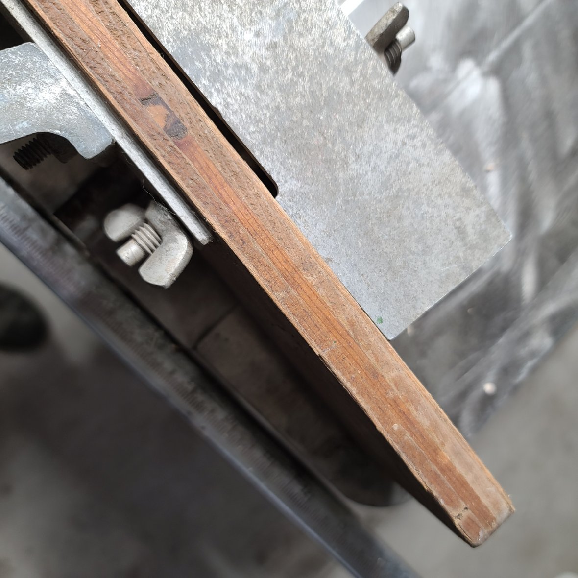

How can i tell if this is the original extension table?
The plywood is antique, but i am not sure if it is 1948 antique.
Joel Gardner
1948 SS 10E #1143

Your plywood extension table looks identical to my 10E. (except for the weathered part)
P.S. Your miter gauge looks third party.
