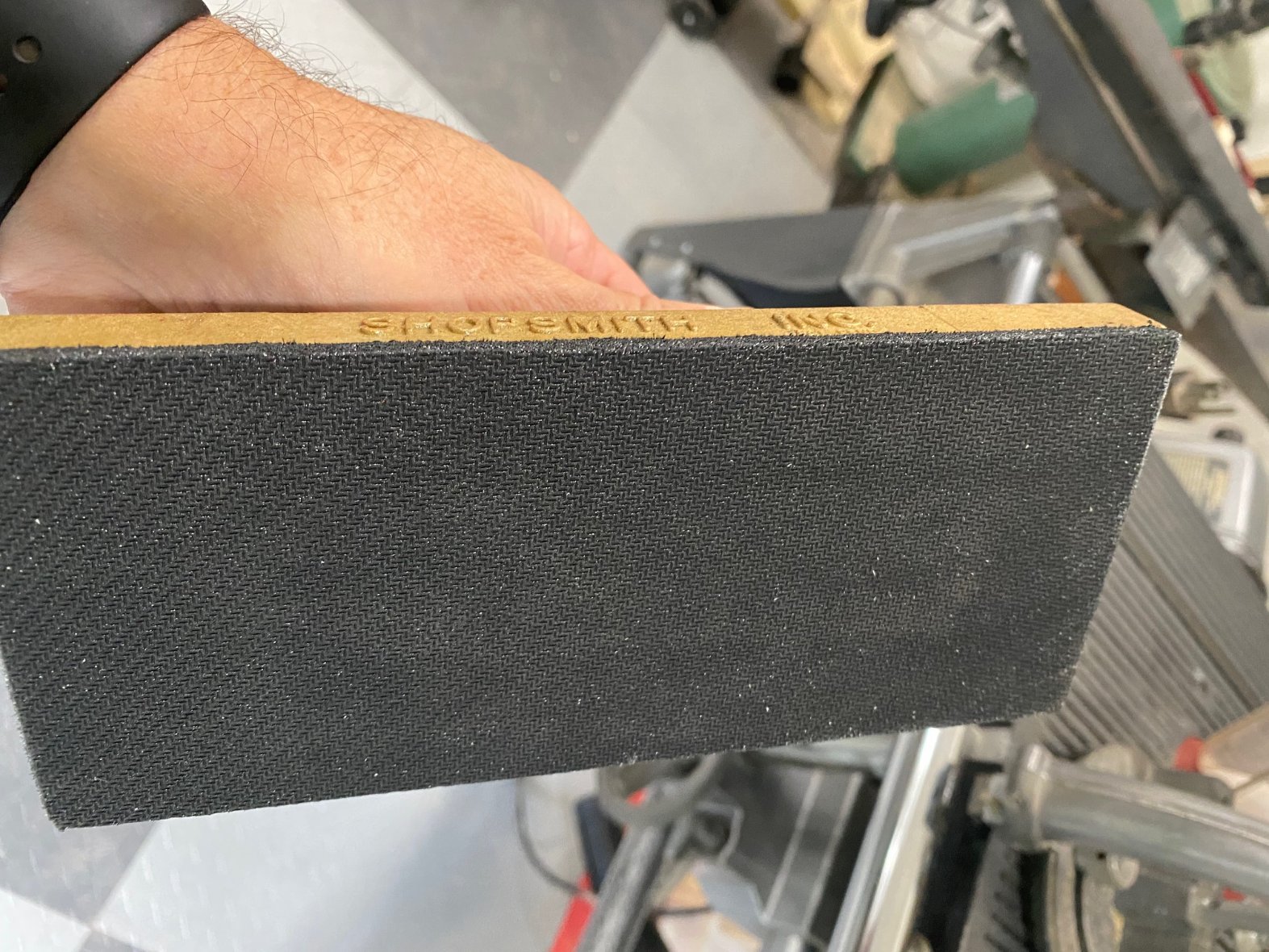

The bottom of a couple of my old Shopsmith push blocks are deteriorating. Has anyone redone them? If so, what did you use?
This one is not terrible
Push Block 1.jpg (363.49 KiB) Viewed 1207 times
This one is toast...
Push Block 2.jpg (347.77 KiB) Viewed 1207 times
Posts: 21368
Re: Push Blocks
I cut some mouse pads to size, cleaned the old pads off the push blocks and reattached to mouse pads to the push blocks.
Apply the adhesive to both the push block and the mouse pad. I don't recall what adhesive I used.

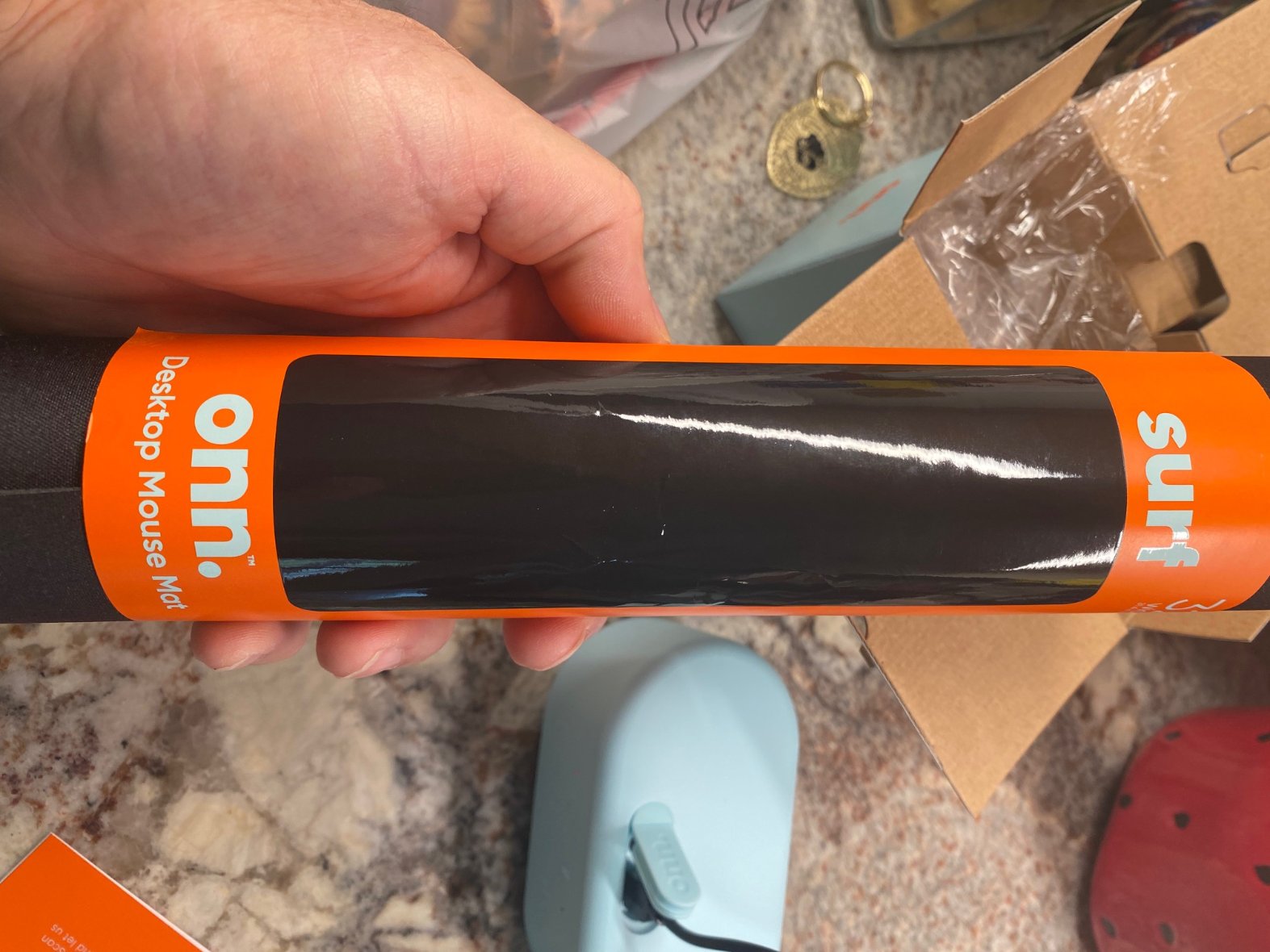

As an update, the mouse pad material seems to be the trick. I found these desktop mouse pads at Wal-Mart. Cleaned the old stuff off and scuffed the block with 180 grit and used spray adhesive to attach the new material and trimmed it with a razor knife.
Push Block 3.jpg (213.04 KiB) Viewed 1110 times
Push Block 4.jpg (388.81 KiB) Viewed 1110 times
Came out great
