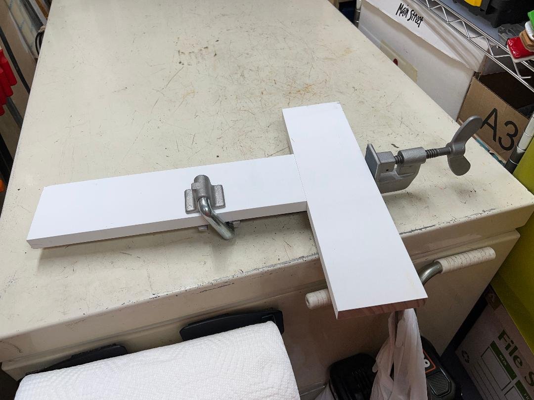

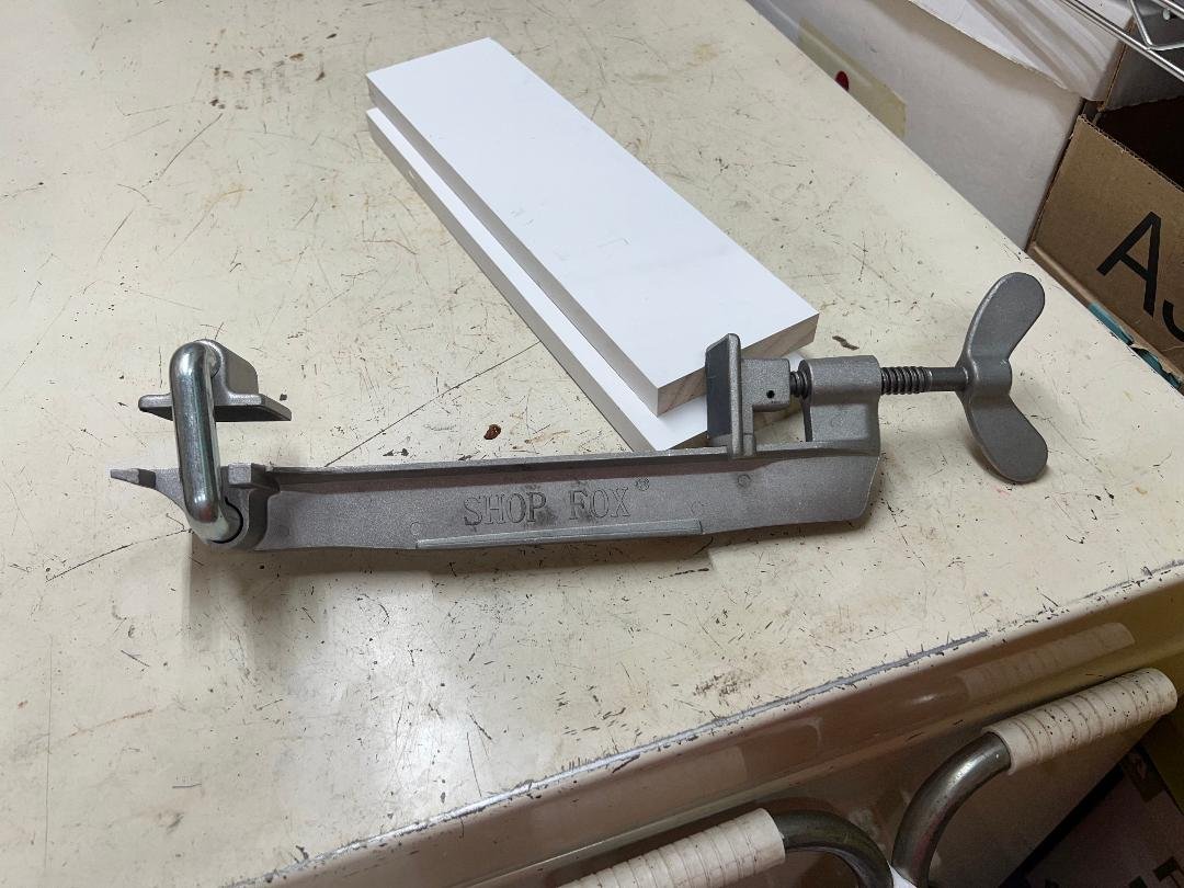

A current project would be a lot easier with a pair of these face frame clamps. I have only one. And to be honest I do not love it.
So we are all on the same page here is couple of picture:
They let you clamp pieces that would normally require some much long clamps and in general they can make your life easier especially if your shop is space challenged.
I have found that they are still made and can be ordered online. But, as I mentioned I don't love it. I seem to recall another company making a clamp with this function but different design. I was unable to find that I seem to remember but that could be for a lot or reasons. First the name, a lot of different face frame clamps but meaning various things. Second perhaps the company no longer exists or no longer makes them. Third my memory if faulty.
Since we are broad category of wood workers I was wondering if someone owns or remembers such a clamp the holds one board along its edge and then forces a second board into it via some sort of screw clamp. Anything that resembles the function but with a different look would be welcome.

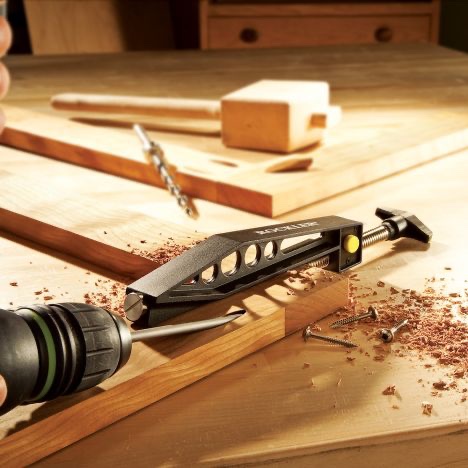

As I was researching this morning to solve my own dilemma, I found a couple of options if you plan on using pocket holes and screws. I typically use dominos for face frames but may need to go the pocket hole route for this build.
Kreg has a clamp that engages one of the pocket hols and clamps the joint, but it doesn't provide for alignment of the faces.
Rockler has a version as well that provides for alignment of the back faces which works if your stock is the same thickness. There are clones of these on Amazon that come in two packs for less than the price of a single clamp from Rockler.

reible wrote: Mon Aug 08, 2022 8:16 pm A current project would be a lot easier with a pair of these face frame clamps. I have only one. And to be honest I do not love it.
The Debuque Clamp Works makes a clamp similar to the Shop Fox. They have been making them for a long time. I think the Shop Fox is a knock-of of the Debuque design. The one you have holds the wood horizontally, but they also make one that holds the wood vertically--far left in the attached photo. These clamps are sold through a number of stores online. I took a screen grab for Lee Valley because they show all of the different accessories. I always liked the ones I have (Shop Fox, like yours), but you need to have at least 4 of them to be really useful.
