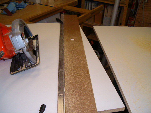

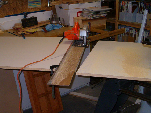

I use my homemade straight cutting guide and my expandable workbench along with a circle saw.
This board was also supported by the Mark V. Bench outrigger in background.

[ATTACH]3291[/ATTACH]
straight cutting guide.jpg (118.59 KiB) Viewed 8058 times
straight edge circle saw.jpg (118.86 KiB) Viewed 8137 times
