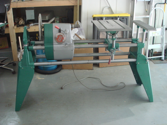

To show off a little, here is the Greenie I restored last year that started the whole craze for me. Found it rusting behind the house we moved into in summer 2007.
Colors in you attached picture look like Deep Green and Silver...is that correct? I just painted my greenie with Deep Green and Verde Green

Dave - the unit pictured in my avatar was painted with the Verde Green and Silver, hammered finish from Rustoleum. The original Greenie paint is quite a bit paler than the Verde Green, but the final application leaves a much more vibrant look, in my opinion.
