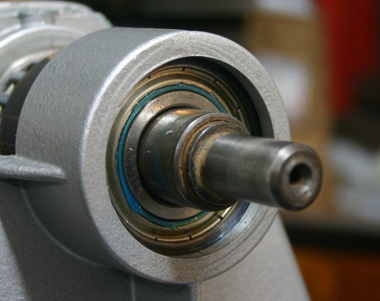

Grease leaking out of bearing
Post by mickyd »
When I had my belt cover off, I notice the brand new drive sleeve assembly bearing oozed some lubricant. The unit has only been run for about 1 minute since the bearing was installed. Concern? Wrong type of bearing?
[ATTACH]4328[/ATTACH]

mickyd wrote:When I had my belt cover off, I notice the brand new drive sleeve assembly bearing oozed some lubricant. The unit has only been run for about 1 minute since the bearing was installed. Concern? Wrong type of bearing?
A little leakage is normal. The metal seals on the bearing are not air tight and as the bearing heats up some grease may push out. You could probably eliminate the grease seeping with 2r seals.

judaspre1982 wrote:Mike , where did you get the replacement bearing for the drive shaft? Where is the knurled bearing keeper that goes on the quill shaft? Do not run the machine without the bearing keeper on the shaft.---Dave
What image are you looking at? This is the drive end of the headstock in the posted picture. The bearing spring washer is in place.
Got the bearing at an industrial supply store here in San Diego. Why?
If your calling this:
[ATTACH]4329[/ATTACH]
the bearing keeper, it's mounted on the quill end. If you mean something else that should have been shown on the photo with the oozing bearing, I don't have anything and need to know what it is that I am missing.
