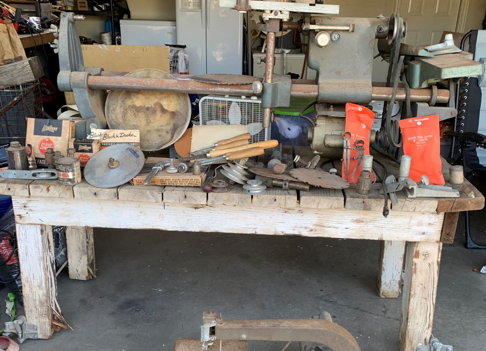

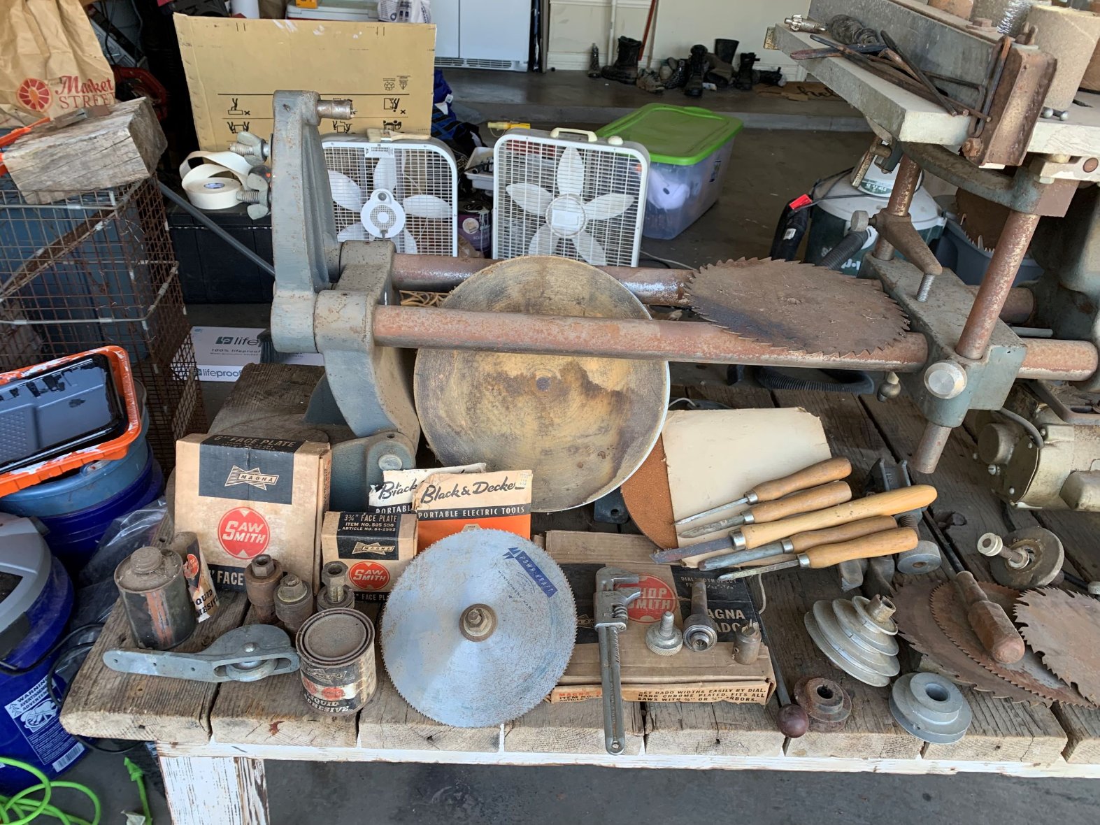

Just picked up a 10E - probably paid too much for it after reading up on it, but I got excited thinking it was a great deal.
Anyways - it has a lot of stuff with it, I'm not sure if it has all the parts, and I don't even know if the motor runs since the plug is damaged and I have to rewire it. The motor and power head turn freely with no noise.
Serial number 18644 - I know that probably won't put a date on anything, but if it does I would love to know.
I'll try to post pictures of the actual unit without all the 'goodies' that were included when I get a chance to take the pictures, but here's what I have.

Welcome to the Shopsmith Forum and congratulations on your new to you Shopsmith Model 10E. Serial Number 18644 would have been made in 1948. I can't tell from the pictures if it has everything that originally came with it but there are some extras. The most notable extra is the Magna 4" Jointer Model 620 on the Special Jointer Mounting Headrest. That is definitely a plus and increases the value of what you purchased. A previous owner made a rear fence lock for the Rip Fence. I don't see the Upper Saw Blade Guard but the Splitter for it is there. The Wood Extension Table and Bracket it should have are not visible in the pictures. Some of the Saw Blades shown look a little big in the pictures. The Model 10E and 10ER used 8" Diameter Saw Blades. The condition of the power cord is not surprising. I replace the original power cords and switches on all my Model 10 restorations. The motor probably works but may need a little cleaning out inside. I have yet to have one of these old A. O. Smith motors fail. With less cluttered pictures we can help you identify items you may be unsure of. There are items that are not Shopsmith parts in your pictures.

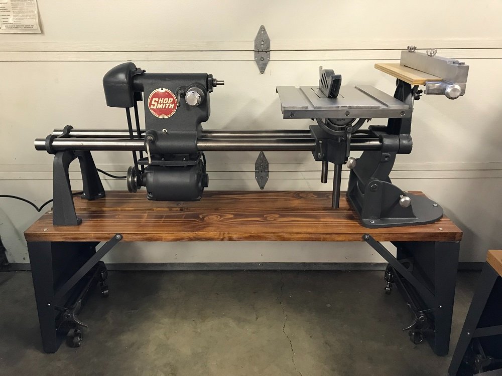

A Model 10E (S/N 19541) I restored that is near to your 10E is shown in the picture below. It is complete with everything It would have come with from the factory plus Lathe Chisels and on a bench.

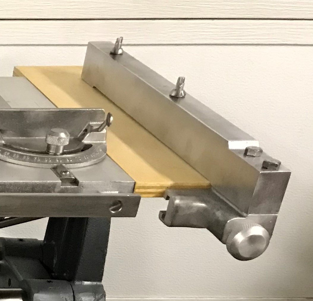

I have made replacements for several Wood Extension Tables. I make them from 3/4" Plywood, cabinet grade that has 5 layers. In fact I have two of them cutout and waiting to have the holes drilled followed by a Varathane finish to help protect them. They are for Model 10E's serial numbers 1033 and 1076 that I am close to finishing their restorations. Original Wood Extensions Tables I have had come on Model 10E's generally are not in very good condition and I believe were unfinished. There were two versions of the Wood Extension Tables made for the Model 10E as shown in the picture below. Both have extra holes drilled in them by previous owners.
_ .
The top one is the later one and should be the version yours would use. It attaches to the Base Top Bar and Extension Bracket using 1/4" flat head machine screws, washers and nuts. Below is a close up of the Extension Table Assembly with the Fence mounted on S/N 1077. Unfortunately, the Fence covers the mounting of the wood top to the bar and bracket. This Model 10E uses the early Wood Top version.
_
_ .

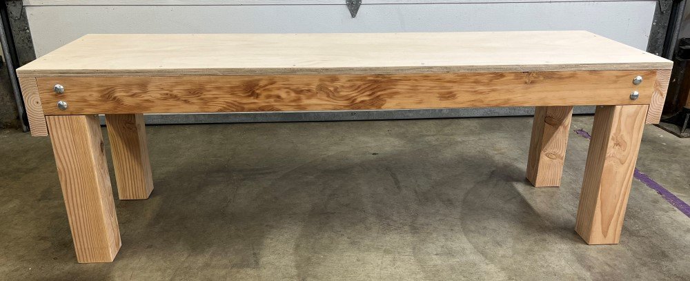

Originally Magna Engineering Corporation only had plans for a wood bench which was included with the Owner's Guide and other paperwork. There are a couple different versions of the wood bench plans. Later Magna came up with a pair of metal Bench Ends that uses two 2" x 8" x either 60" or 57" long boards for a bench. The difference in the board lengths depends on when your Model 10 was made and the size of the Base and Headrest. Even later Magna came up with retractable casters for the benches that went on the metal bench ends and could also be used on the wooden benches.
Below is one of the Wood Benches I made following the Magna plans.
_ .
I made 2 of these and they will hold S/N's 1076 and 1077. These benches now have the retractable casters mounted on them. This bench is similar to the frame of the bench you have but yours has different top boards.
Below is an example of the Metal Bench Ends and 2x8 wood top Bench. This one is 60" long as it has a Model 10E on it. It has the Retractable Casters mounted.
_ .
The bench in my previous post is one I made using an angle iron welded frame and locking casters.
