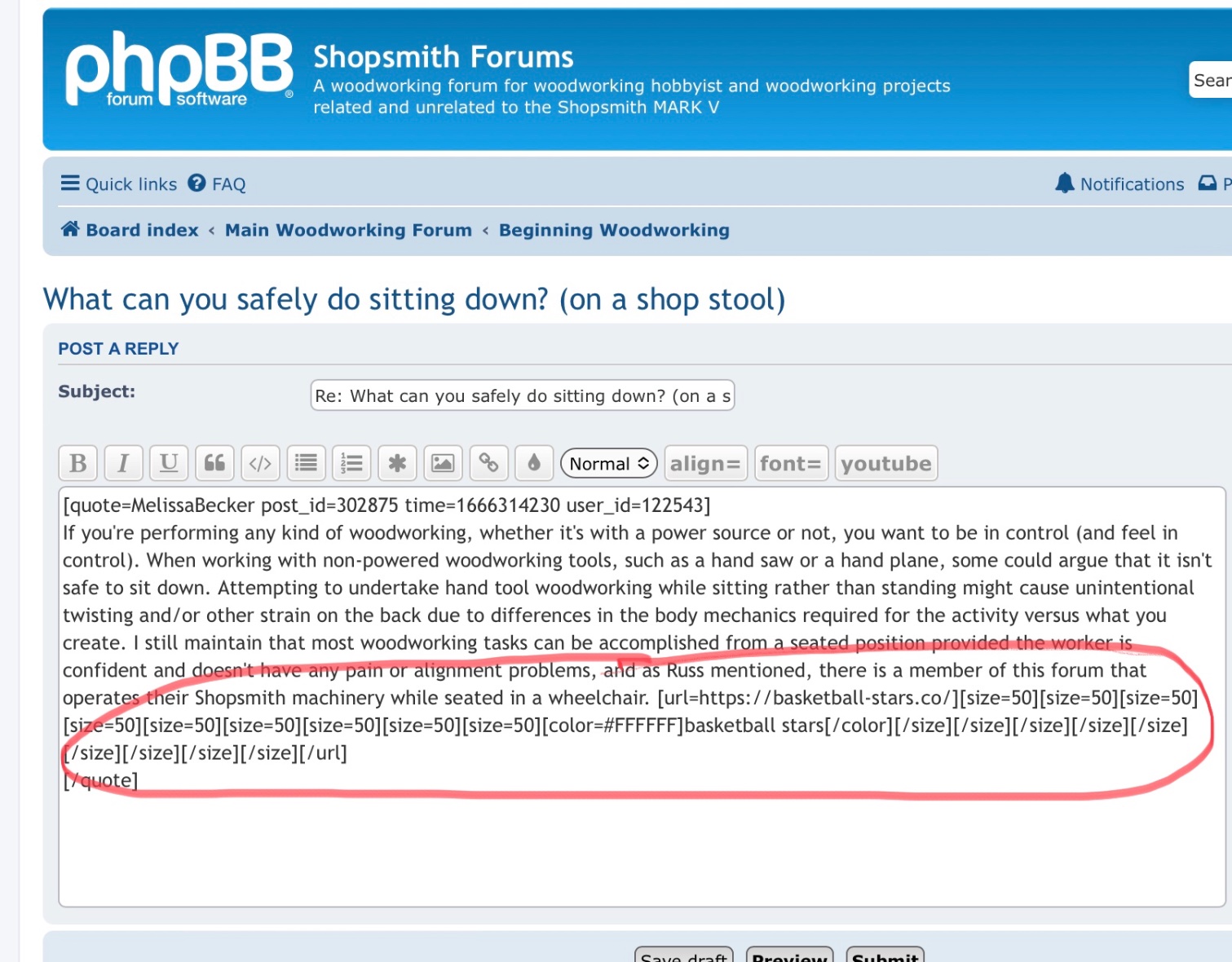

MelissaBecker wrote: Thu Oct 20, 2022 9:03 pm If you're performing any kind of woodworking, whether it's with a power source or not, you want to be in control (and feel in control). When working with non-powered woodworking tools, such as a hand saw or a hand plane, some could argue that it isn't safe to sit down. Attempting to undertake hand tool woodworking while sitting rather than standing might cause unintentional twisting and/or other strain on the back due to differences in the body mechanics required for the activity versus what you create. I still maintain that most woodworking tasks can be accomplished from a seated position provided the worker is confident and doesn't have any pain or alignment problems, and as Russ mentioned, there is a member of this forum that operates their Shopsmith machinery while seated in a wheelchair.
MODERATOR,
Can you investigate the post above and the account that posted it? It looks like a fairly sophisticated chatbot to me. It is essentially a re-ordered version of what has already been posted by myself and perhaps others above. There is SIGNIFICANT plagiarism in this post above and nothing new added to this thread.

Posted: Fri Oct 21, 2022 1:09 pm
by HopefulSSer
There’s link spam at the end of it.

HopefulSSer wrote: Fri Oct 21, 2022 1:09 pm There’s link spam at the end of it.
Thanks for pointing this out.
Wait...so a MODERATOR edited it so that the URL won't show on viewing the post (because I can't see it with Chrome browser), but yet the offending link is still available in the code of the post if you go to quote it? That really makes me question now why are we leaving these spam posts in place at all??? Shouldn't they be deleted entirely? This spam post copied many of my phrases verbatim and I think many of you agree that having one of me on the forum is more than enough! :D Now, I have my own chatbot spewing my posts back to me! :( :eek: :mad:
P.S. Two of my prior posts were plagiarized today by two different spammers. Looks like the spammers/chatbots have gotten more sophisticated, i.e. they change out some words for synonyms to make it appear to be different, but the message is exactly the same as what I wrote before. Link below to the other one.
