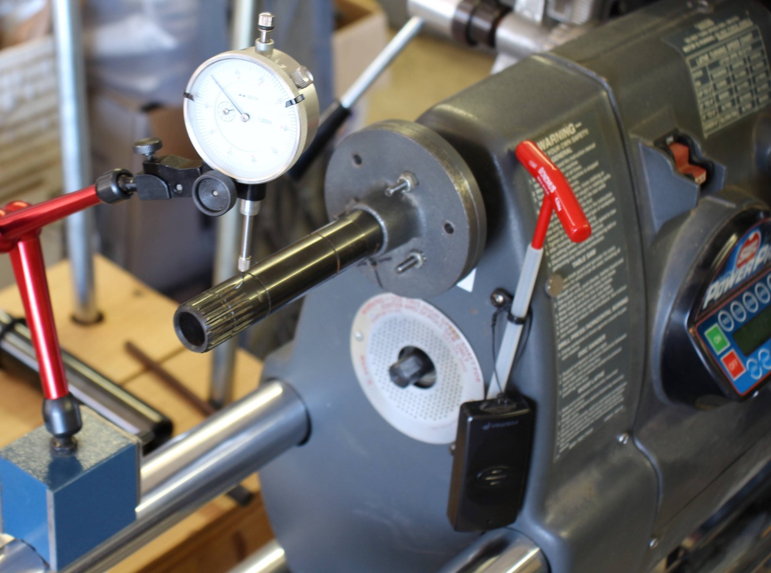

I eventually determined that the runout problem I experienced with the Drive Sleeve was caused by the shaft itself. To confirm I used this setup to measure runout at the approximate center of the bearing location of each of two shafts. (I had a disassembled 'old style' Drive Sleeve in a pile of parts and used it for comparison.)

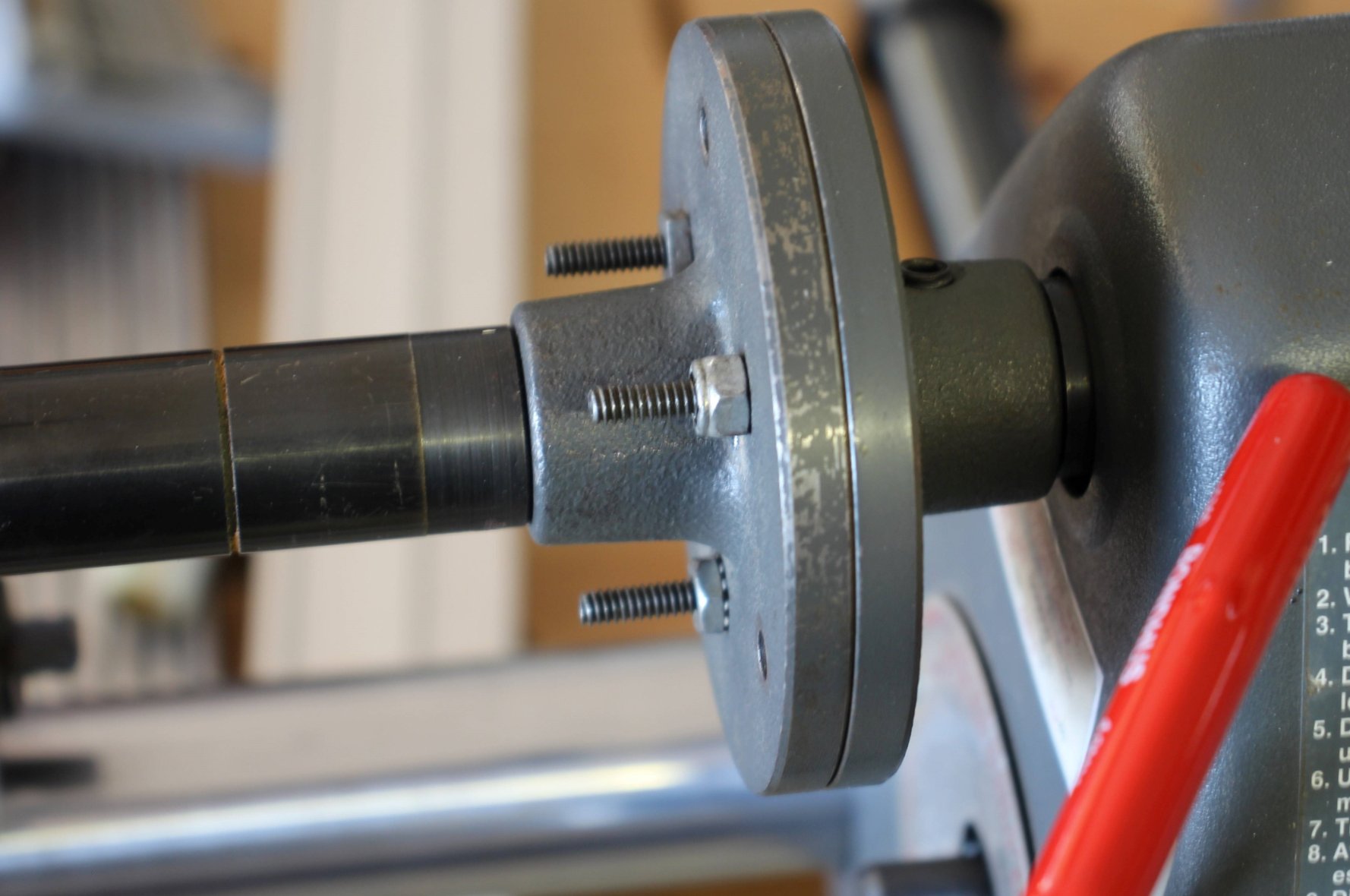

I assembled a shaft adapter from 2 3-3/4" lathe faceplates:

This is no kind of lab setup for measuring, there is unknown runout at the PowerPro output shaft and each of the faceplates, plus how accurately they are assembled, contribute runout. But with a known good shaft for reference it is clear that the suspect shaft is bad. My baseline (old-style) shaft measured 0.009" TIR at the inner bearing location and 0.005" at the outer bearing location. The suspect shaft measured 0.053" at the inner and 0.023" at the outer.
I'm a bit disappointed in the quality but glad to have isolated the cause. Also glad I checked the shaft before installing new bearings on it. I'm reasonably certain that the runout led to premature wear on the Drive and Ring, causing the slight rotational slop I noted and the startup noise I have recently noticed when spinning up a saw blade.
