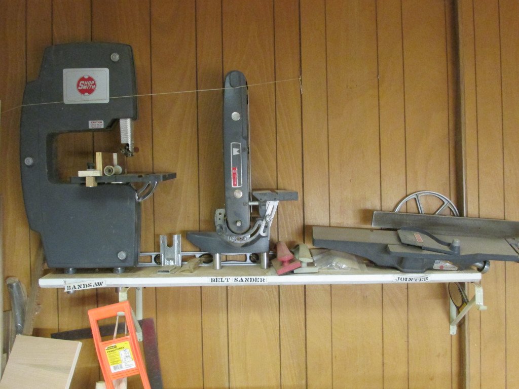

Re: Special Purpose Tool Storage
I store mine on the back wall of my garage, Take note that the jointer is the heaviest and may be difficult to store on a high shelf
Bill V
Bill V
- Bill Vans shopsmith wall.jpg (40.62 KiB) Viewed 3473 times

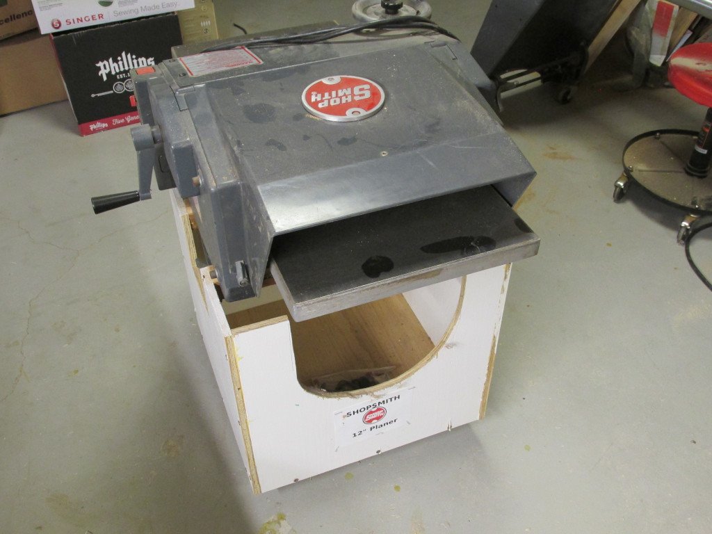

My setup is similar to BillVan's. I have a shelf on the back wall that holds most of my tools. Originally I had it mounted high enough so my Shopsmith fit under it, but last year, I moved the shelf lower because my back would no longer handle lifting things off and on the shelf that high.
My planer doesn't fit that shelt so I made a rolling cart for it. I can easily roll it into any unused space when not needed and roll it out beside the Shopsmith when I need it.
