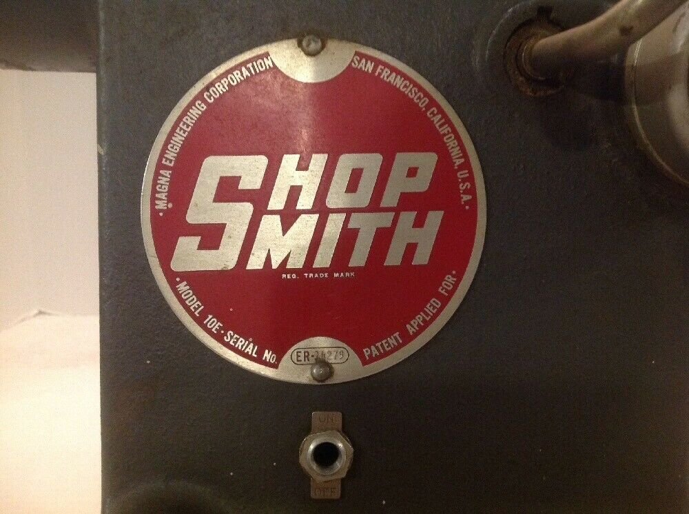

Welcome to the Shopsmith Forum. Shopsmith Model 10E serial number ER14172 was made in the Eastern Plant probably around the end of 1948 (best guess). It should be a Model 10E as is shown on the Logo/Serial Number Plate on the front of the Headstock. Your plate should look like the one shown below but with your serial number. Note the Model Number on the lower left side.
_
10E ER-14279 Pennsburg PA.jpg (129.2 KiB) Viewed 2197 times
As JPG said the reason for the two belts is you have the optional Speed Changer. This is a sought-after option that generally costs quite a bit to buy on the used market. Just for your reference the Speed Changer uses a 22" and a 25" belt. If you want to use your Shopsmith without the Speed Changer, as it came from the factory, it uses a 38" belt and can need a 39" belt to use some of the extra fixed speeds. The Model 10's were advertised as a three-speed tool but by realigning the pulleys you can have 7 fixed speeds. The chart below covers those 7 speeds.
