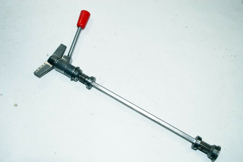

The only area of concern I would have in mounting a Miter Saw to the Main Table is the possibility of quickly wearing and breaking off the teeth on the Pinion Gear with that weight. The Pinion Gears are on either end of the Pinion Shaft which raises and lowers the Table and are shown in the picture below.
_
Mark 5 Carriage table raising-lock shaft assembly early.jpg (58.06 KiB) Viewed 2089 times
I have had to replace a pair on a Mark V I restored that the teeth were broken.
I see you have already removed the Headstock but left the Main Table and Carriage. I would suggest you mount the Miter Saw to the Way Tubes on a wood base and you could use the Main Table on one side of the Miter and the Extension Table on the other side for extra support of what you are cutting. Later if you replace the motor and wish to return the Mark V to its original use you would not have made any changes to the Main Table or other parts that would also need replacing.

From OP. Thanks all for the prompt replies. Good point Russ on the pinion gear teeth as a weak link in the load, photo was helpful. I’ll make a plywood mount to way tubes and use the SS table for an infeed support.
