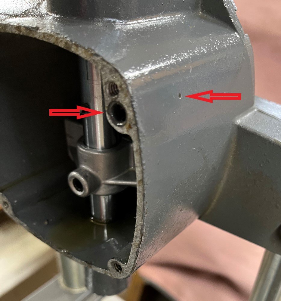

Has anyone considered drilling a small hole into the breather "channel" from the inside of the housing? This could circumvent the problem of blocking the end of the breather channel with a replacement housing cover gasket.
Re: Jigsaw Housing Breather Hole
Posted: Mon Dec 19, 2022 11:17 pm
by JPG
Yeah! That should make a great oil spray source and provide a method of removing 'excess' oil from the crank case.
Posted: Tue Dec 20, 2022 2:41 pm
by chapmanruss
I have not considering doing that since I have or had the OEM Gasket on my Jig Saws I have owned. However, I do not see a problem doing that. The picture below is one I took yesterday for a different thread about the Jig Saw. If a hole was drilled (behind the left arrow) into the hole that the outside vent hole (indicated by the right arrow) connects to it should work okay. This part of the housing is above the oil level when properly filled.
Posted: Tue Dec 20, 2022 6:55 pm
by JPG
Yeah! That'l work!
