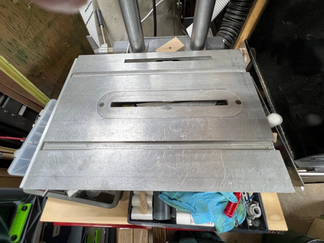

I had a little time this afternoon so I went out to the shopsmith drill press and took a look at the table for flatness.
First off the largest "dip" I could find was not centered of the table or where the drill press center is. So it is unlikely that any distortion has been caused by drilling operations. Second, the table for the most part is quite flat. I took several looks from front to back and found that near the table insert is where the dips showed up. You can not reliably check where the insert is so I skipped that area. The flattest areas were next to the miter slots.
So this is the table I measured. It is from a 1976 shopsmith that I purchased new from shopsmith. It was my prime table for 30ish years. As you can see it has some use over those years.

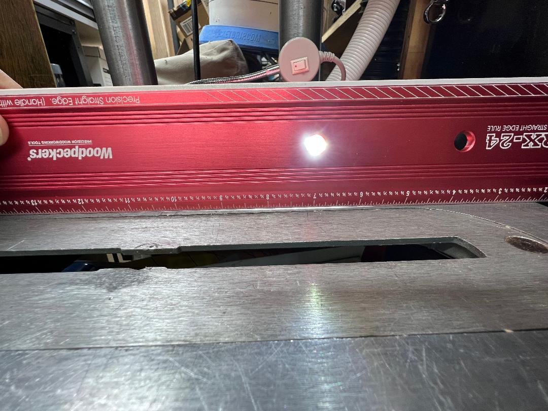

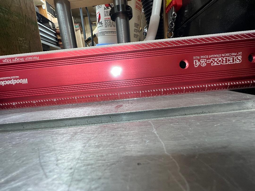

For this testing I used a Woodpecker straight edge, about the straightest edge most wood shops have. I put a light behind so I could look for gaps. For the most part there were not any. In this shot you see a very small gap that is very short, it is just before where the insert goes.
The only large gap was slightly farther back on the table and just on the other side of the insert. The two gaps do not line up so farther proof that it is unlikely caused by drilling operations.
Using a feeler gauge that gap came in at .006" max. It is also a small area so my guess is that it has had no effect on operation of the shopsmith.
I have several more 500 tables but they are not easy to get at. I would think from using them that none are at the point of causing errors in my projects. Perhaps when warmer weather comes along I can check them too.
