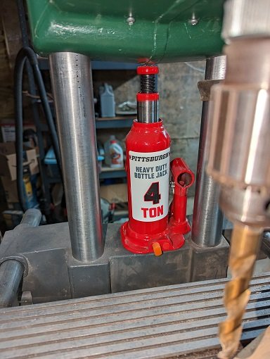

For a short term option I just got the new hydraulic headstock raiser shown below, I can use the same device for raising the table also. One on the issues with changing table height is the weight of the table causing the carriage to jam on the way tubes. This problem is much worse now that I'm using a 510 table because the table is larger and heavier even without adding the weight of a drill press vice and whatever is about to get drilled, routed, shaped, etc. The 510 table makes it easy to add a counterweight using connecting tubes in the rails to hold a floating table on the back side. I have other notions in mind also, but for now looking for simple solutions.

Interesting Headstock Raiser. 4 tons might be a little overkill though.
I think that is especially useful for your Power Pro Headstock to adjust the Headstock position up or down above the Table/Carriage in Drill Press Mode. I would have never considered releasing the Headstock Way Tube Lock even on a conventional Headstock let alone a Power Pro Headstock in Drill Press Mode.

That jack was on clearance at Harbor Freight, it will help for the time being. Because the headstock is so hard to adjust in drill press mode I end up adjusting the table, but I'd rather leave the table at the same height all the time. As someone pointed out to me, I have the heaviest of headstocks because it was sand cast and has the Power Pro in it. So the table raiser isn't really what I was looking for. One day, should I ever find the time and energy I'll figure out how to use the treadmill raiser I have that has a reversible AC motor driving a 3/4" acme screw. I assume I can put a longer screw in it, or even if not connect that device between the carriage and headstock. Then either the table or headstock can be raised or lowered relative to the other by releasing it's lock. The longer screw would allow either one to be positioned at any height with any relative distance between them.chapmanruss wrote: ↑Sat Feb 04, 2023 1:46 pm Ed,

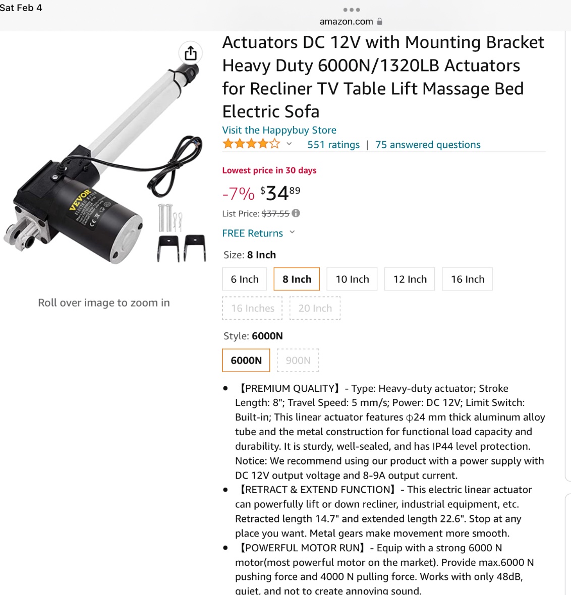

Re: What happened to the Gas Spring Table Raiser?
You can pick up one of these motors on Amazon for less then $50. Looks like they come in a variety of sizes.
