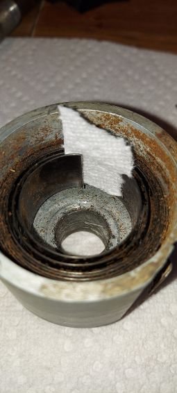

I was continuing to go through the Mark VII I just purchased looking for issues, been watching some videos on maintenance and repairs. I noticed that the quills in the videos all had a return spring working on the quill. Noted that mine didn't return, started looking into it by removing the quill and then quill Pinion shaft, then spring housing. The spring in broken off.
I looked up a replacement spring/housing according to the part number listed in the manual, housing 501310, spring 501315 and SS came back with another number (did not record) calling out the part as Housing with Spring.
So question 1 is:
Is there a difference or will the "Housing with spring" fit my Mark VII?

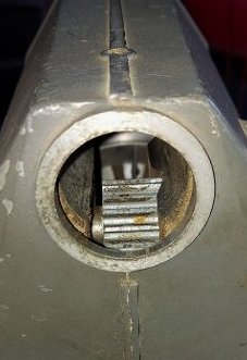

My next question is about the Quill feed pinion gear alignment to the quill rack gear.
I noticed that the pinion gear doesn't completely align with the center of the quill rack. I reinstalled the pinion shaft to see if there was possible a misalignment due to the spring housing, doesn't appear to be. There is a race/stop protruding into the back (spring side), that doesn't allow the pinion gear to travel deeper.
question no 2: Is it normal for the Mark VII that the pinion gear doesn't completely align with the quill rack gear?
Pictures of the gear alignment and the race/stop on the spring side of the housing.
Quill pinion in housing.jpg (15.8 KiB) Viewed 4641 times
Quill gear race.jpg (20.34 KiB) Viewed 4641 times
Quill pinion gear with no clean up, witness marks where the gear is actually riding.

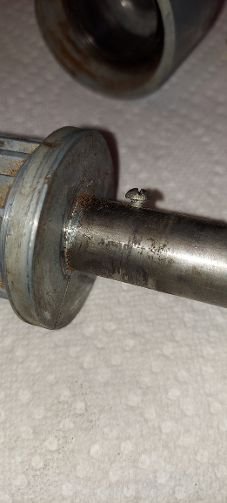

More of an oops than anything else.
Noted that the quill was tough moving from the beginning, but immediately smoothed out when I moved the set screw on the top of the housing as a quill retainer. Well whomever before me installed the set screw didn't use a dog or half dog and used a cupped end. So there is some slight galling on quill shaft on each side of slot. Just showing a picture of what happened when not properly done. FYI I guess.
Quill removed.jpg (22.71 KiB) Viewed 4640 times
Quill damage wrong SS.jpg (10.29 KiB) Viewed 4640 times
john_001
Posts: 251
Joined: Wed Mar 16, 2011 8:28 pm
Location: Chester, NJ
Re: Mark VII Repair questions
Post by john_001 »
I don't own a Mark VII, but I'm assuming the quill retraction is similar to the Mark 5/V. It looks like someone tightened the set screw. It's not intended to be bottomed out in the groove; just protrude into the groove enough to keep the quill from coming all the way out. The spring damage is typical of removing the quill and letting the handle go to snap back by itself. The momentum of the spinning handle carries it until it turns the spring backwards.

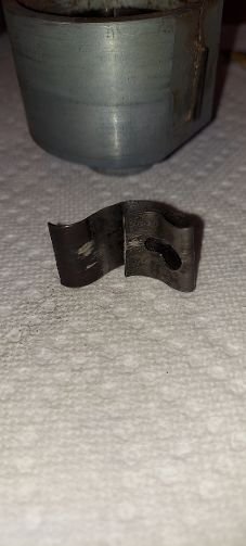

I thought about doing that, since it broke off short. I wasn't sure of the orientation of the bends or if the bends were normal or due to damage. (?) And if after making the keyhole if the spring would tolerate me bending it without snapping.
MichiganTom
Posts: 46
Joined: Fri Jan 27, 2023 9:50 pm
Location: Michigan
Post by MichiganTom »
I took a few more pictures of the damaged spring. I don't know what a good working spring looks like before installation, which made me question which way I would orient the keyhole. The other question I have is if successful at putting the keyhole into the spring, is the retainer screw supposed to lock down the spring to the Shaft?? The screw that is in the shaft now will not go down any further than shown below, possibly the screw is too long.
broken spring.jpg (27.32 KiB) Viewed 4453 times
bent spring end.jpg (18.16 KiB) Viewed 4453 times
Not sure if the keyhole would go this way?
Broken orintation 1.jpg (22.81 KiB) Viewed 4453 times
Or if the keyhole should go as below
Broken orintation 2.jpg (23.07 KiB) Viewed 4453 times
Retainer screw bottomed out.
Spring retainer screw depth.jpg (17.73 KiB) Viewed 4453 times
Any help will be greatly appreciated.
