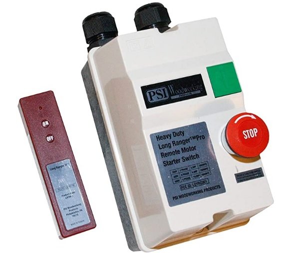

I wouldn't really recommend these approaches. While the DC-3300 is a rather light load due to its small motor, you do have to be careful with switching inductive loads like this using just a relay/contactor. Using such an approach can create a large negative voltage transient that potentially could harm the DC-3300. This is why they make motor starters which include circuitry to suppress inductive load spikes, i.e. they aren't just relays/switches. Larger motors even have arc suppression and are usually magnetic to provide safe dis-engagement should the power fail and re-engage later. The Amazon device first posted on this thread is most likely all solid state, i.e. no internal relays. As such, it likely has built in OV and transient protection. It may even have soft start capability. In short, assuming it has enough current capacity for the DC-3300 load, you shouldn't need to add any external circuitry and most likely adding a relay would only create problems IMHO.
http://www.artisancontrols.com/UtilityI ... 0Loads.pdf
https://www.ciprian.com/wp-content/uplo ... -loads.pdf
https://www.palmerdcs.com/the-integrato ... rotection.
For larger dust collectors, this is what you need, but overkill for something like the DC-3300:
https://www.pennstateind.com/store/LR22 ... wgEALw_wcB
RF Guy
