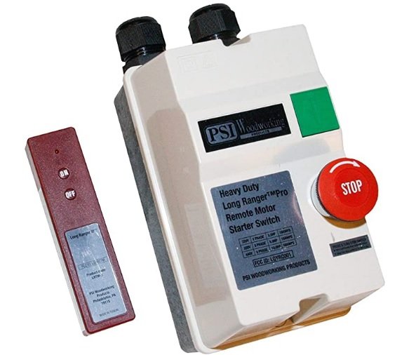

For larger dust collectors, this is what you need, but overkill for something like the DC-3300:
https://www.pennstateind.com/store/LR22 ... wgEALw_wcB
