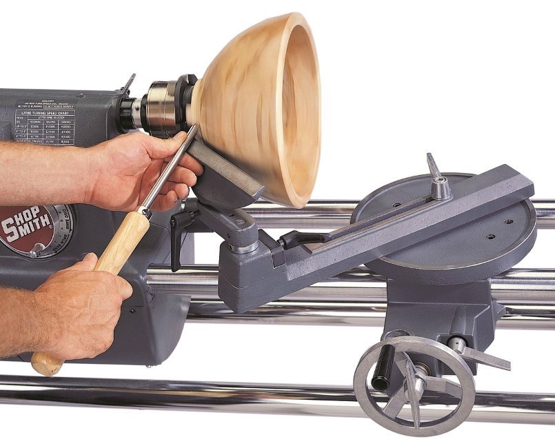

Thanks for the response. Your points are noted, especially about the tool rest improvement. How was the tool rest improved?

RexLumber wrote: Fri Feb 10, 2023 8:54 am Hi Ed,
Rex,
Welcome to the forum! I believe Ed is referring to the Shopsmith Universal Tool Rest (UTR). I am still a woodturning newbie having only gotten into it a few years ago, but have been woodworking for decades. IMHO the UTR is well worth it and is a substantial improvement over the standard tool rest (see link below). It has unfortunately gone up quite a bit in price the last year or so. Mine was around $250 new from Shopsmith, but it is now $319. I agree with Ed's comments above. The one/only disadvantage that I can think of for you in woodturning using a 500 is there is no reverse. So, if you do a lot of woodturning and want to go in reverse for sanding, e.g. to finish a bowl after turning, then you can't easily do this with a 500. There is the PowerPro upgrade from Shopsmith which goes in reverse, but it is EXPENSIVE. Honestly for primarily woodturning...if you want reverse (for sanding) you would be better off going with another brand lathe. Not trying to talk you out of Shopsmith, but just give you some things to think about. Good luck!
https://www.shopsmith.com/ownersite/cat ... olrest.htm

A Mark V (any model) with the Shopsmith Universal Tool Rest will add additional total weight to the Shopsmith and adds stability. There is a difference between the models of the Mark V when it comes to the Lathe function. It is the Table System that makes the difference between the models and the Carriage is part of that difference. The Mark 5/V with the original Table System, aka 500 has a different Carriage and Lathe Tool Rest Assembly than the other models of the Mark V. The Universal Lathe Tool Rest will work on either Carriage. The Lathe Duplicator will work on either Carriage but it is not designed to work on the Model 10E & 10ER or Mark 2.

The 10ER way tubes are the same length at the MK series Shopsmith's. The 10ER head stock is (I believe) narrower than the MK head stocks so the turning length should be the same or slightly longer. I would have to measure mine (I have both) to be sure. The 10ER is heavier than the MK V so that is a plus. As for the UTR, it just clamps to the MK V carriage so I see no reason it would not clamp to the 10ER carriage. The carriage just needs to be flat on top which the 10ER is.
Exactly right. Thanks for posting the picture...
