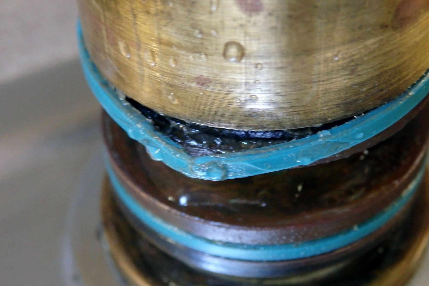

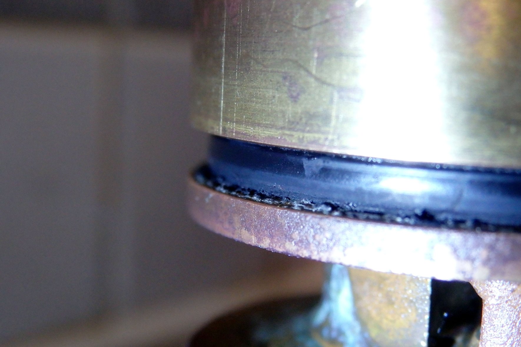

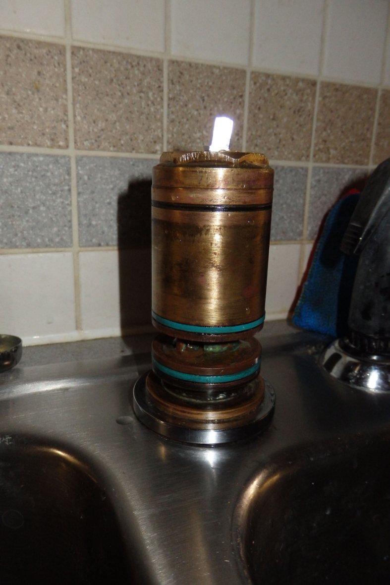

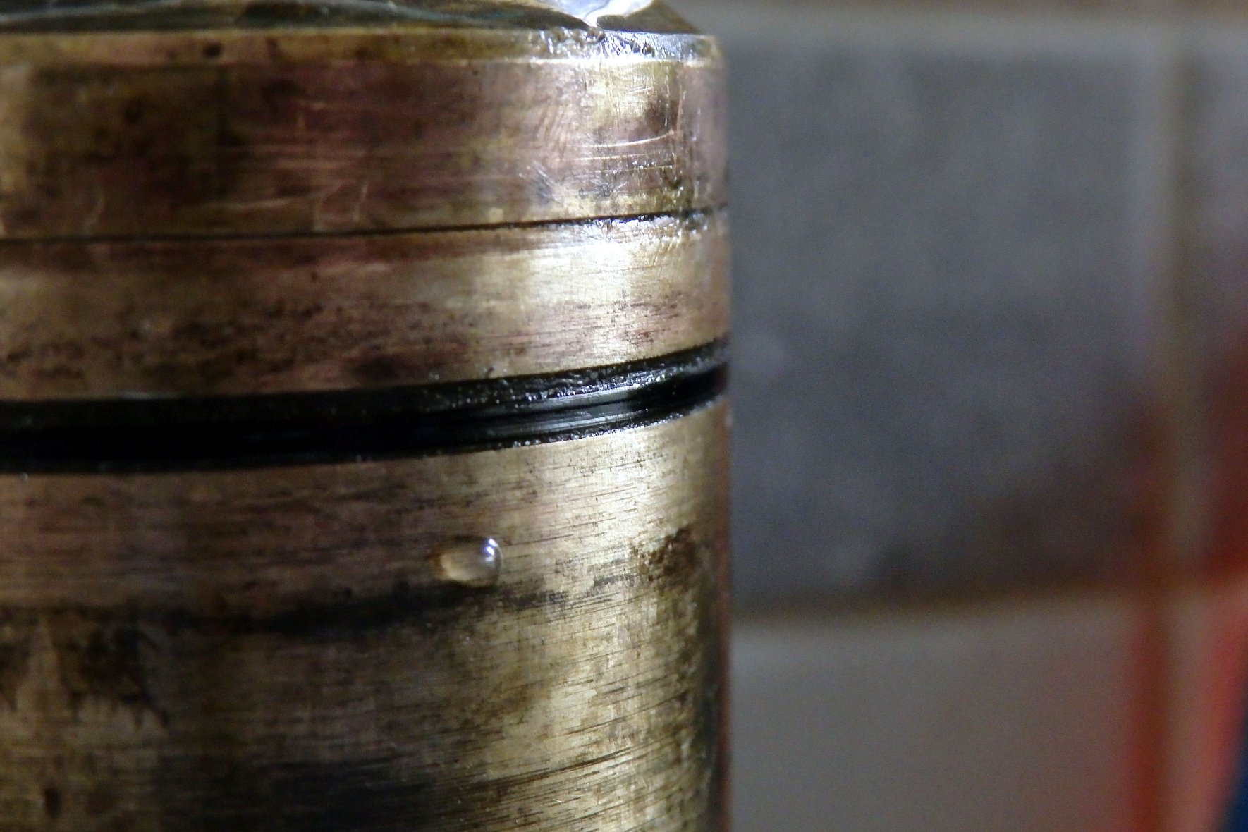

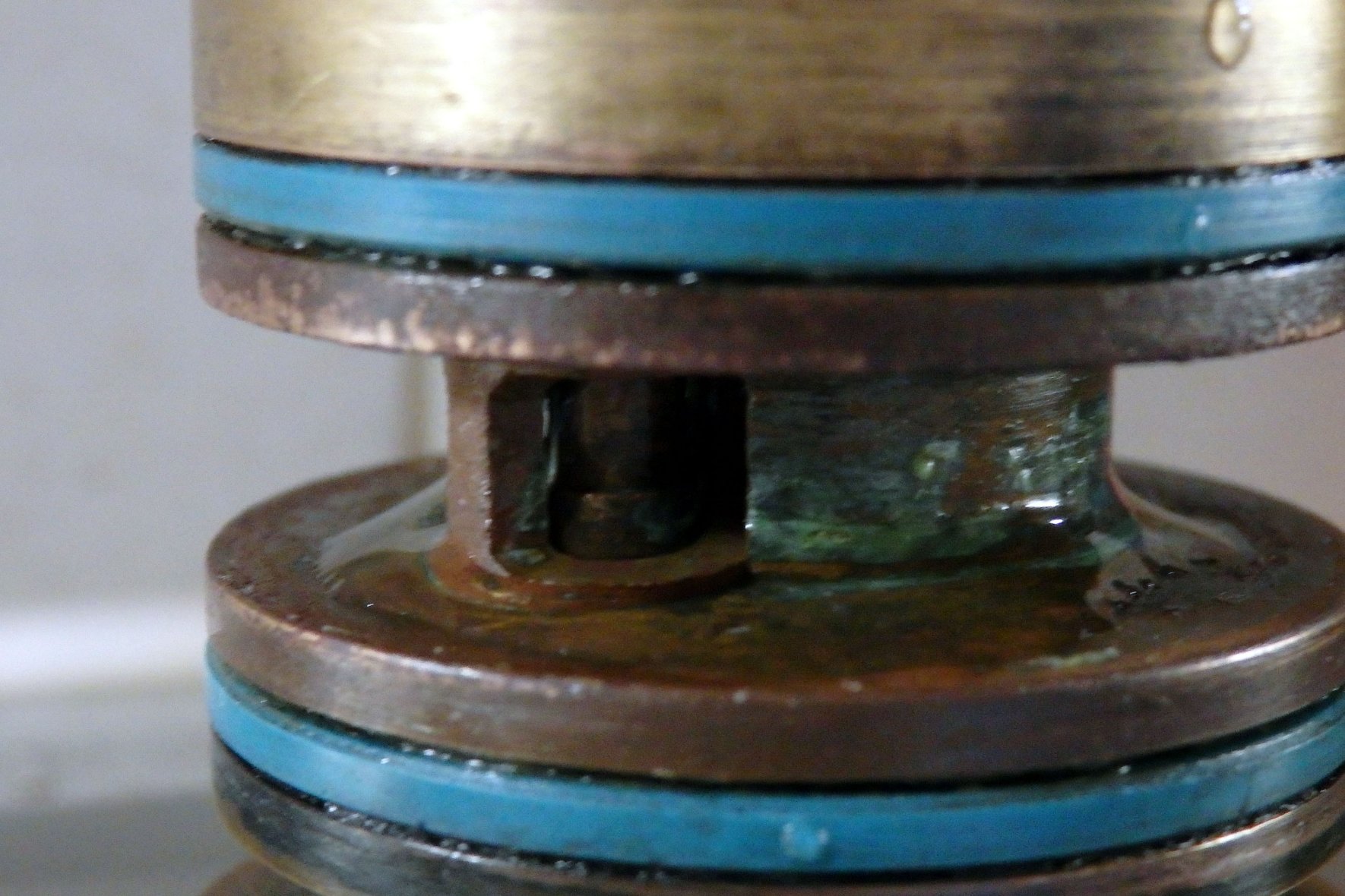

I am hoping the experienced and knowledgeable forum members can help with this non-woodworking subject. I know there are a lot of very smart engineers here, so here goes.
I am trying to replace some O rings on my 37 year old discontinued kitchen faucet. The manufacturer's technical service department has been of limited help.

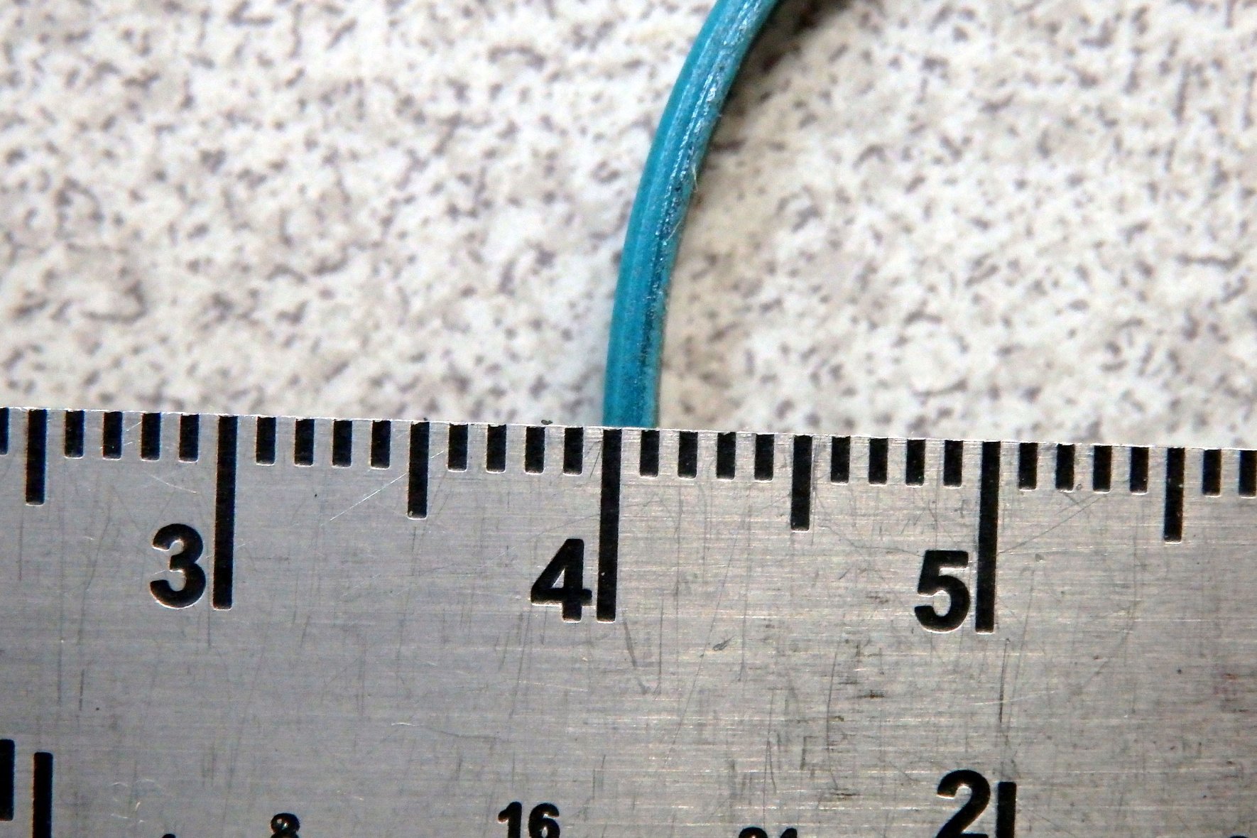

Looking at the pictures below, I am trying to find replacement seals for the two blue rings that keep the water directed towards the spout. I've had leakage at the top of the body, and am now starting to get leakage at the bottom.

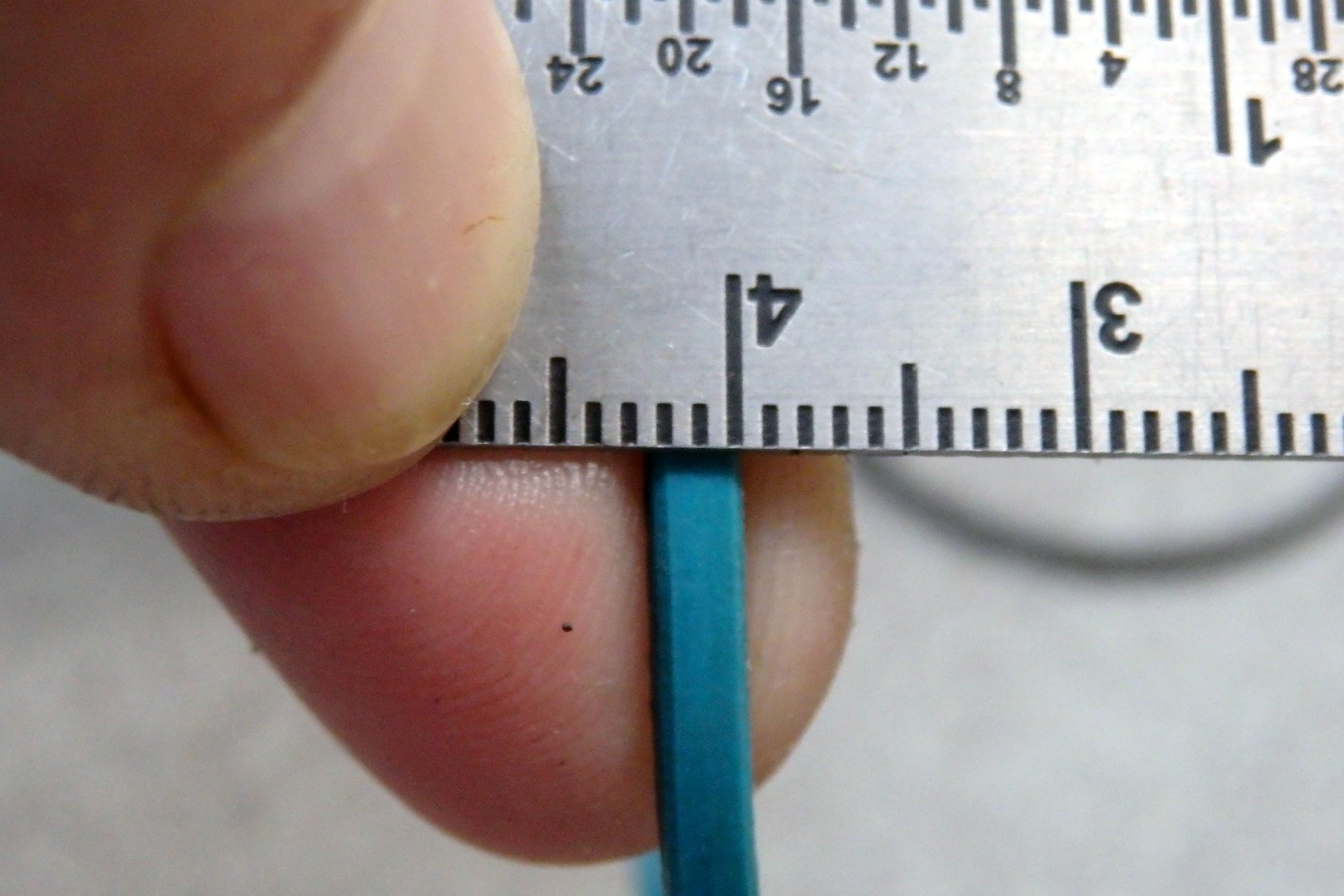

The rings are rectangular in cross section, not circular. Are these perhaps called flat face O rings? In order to measure things, I removed one blue ring only to discover it did not want to stretch or spring back to its original shape.
I had a few hundred words typed explaining the whole saga before trying to re-order the pictures and lost everything I had typed, so will just add the pictures and try to answer any questions you may have.

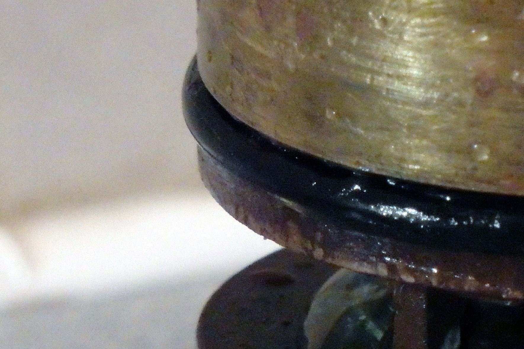

- Top traditional O ring before replacing
- P2031905resized.jpg (273.22 KiB) Viewed 25529 times
- Two blue rings with rectangular cross section I want to replace

- Width of blue ring
- P2082567resized.jpg (367.43 KiB) Viewed 25529 times

- Traditional O ring which manufacturer suggested obviously not right ... faucet body will not slide over it.

I am not a plumber but I can tell you what I know about O rings from working on large shipboard systems. To find replacements, measure outside diameter, inside diameter and thickness. O rings dry out over time which is why they fail. A lubricant is often used to help keep them from drying out or if dry to help them to become pliable. The lubricant is normally a type of grease based on what the system is being used for. Grease for salt water system is not the same as grease for a fresh water system or steam system. It may be possible to salvage these by use of a food grade grease. We used to rub the grease along all the faces of the O rings to make sure the ring was covered completely then add as much as the possible to the O ring grove. The flat O rings can be replaced by round ones if needed as a temporary fix. Let the O rings soak in the grease for a bit before use. Similar process to using a belt dressing to keep belts from drying out.

I agree with everything Brenda said. I don't think those o-rings were originally flat though. I have replaced my fair share of o-ring seals on pool equipment, faucets, etc. and I have seen them get flat like that due to compression over service life. As Brenda suggested remove them and use calipers to approximate the diameter and cross section diameter and find a suitable replacement either at a big box store or online. When the new one is put into service it will deform slightly making it flat, but it typically takes years for that to happen, I believe.

I've still gotten no response from three faucet distributors or two O-ring distributors, so am going to try ordering another size O ring, this time with a 1.5 mm cross section and 37 mm inside diameter. It will need to stretch to a 45 mm inside diameter to slide over the brass body, and then snap back to 42 mm inside diameter to fit in the groove. If this amount of stretch seems excessive, please let me know. The O ring that I already tried was the same 37 mm ID but 2.5 mm in cross section, and it seemed to handle the stretching OK ... once installed, it just projected too far to let the faucet body slide over.

I hesitate to weigh in here because there are so many variables. One thing I am confident in saying is that color has nothing to do with o-ring ID, OD, or cross section.
While color alone is not enough to determine material, in my experience, blue o-rings tend to be composed of fluorosilcone.
O-rings often take a set, so as others have noted the cross section may not have been rectangular originally. The o-ring material, the durometer, the design compression, the o-ring gland, etc. all play a roll here.
McMaster is a great resource. So is Apple Rubber.
