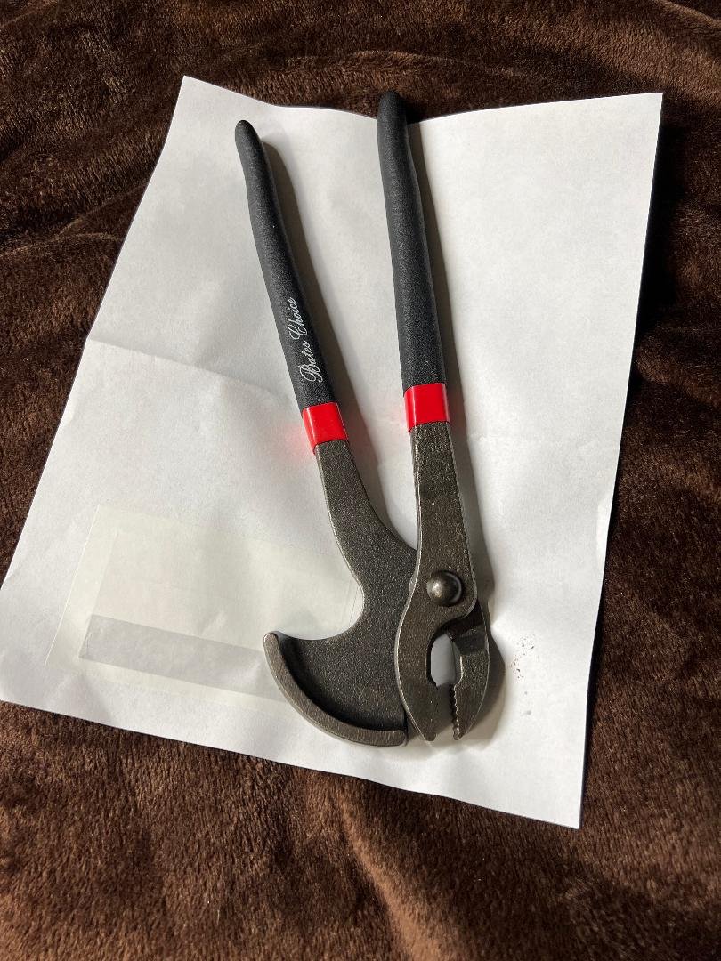

I recently had some brad nail that decided to stay in the base piece and pull through the trim piece. Nailers use a nail that is much softer then the ones you put in with a hammer and if you are not careful they brake off rather then pull out. Also some are headless or almost headless so tools that grab the head have nothing to grab. As I age doing a vertical pull has become more difficult so I use the twisting method which is another reason stuff doesn't go as well as expected.
So when I came across this tool and the price wasn't going to brake the bank I ordered it off Amazon. It was a little larger then I expected but added leverage might be useful at some point. It appears to be will made and works well for that I wanted it for. I have not tried to remove larger nails but then I have other tools for that. I do wish they had a 3/4 size model for sale but hey you can't have everything you want.
For reference the tool is on an 8-1/2 x 11 sheet of paper.

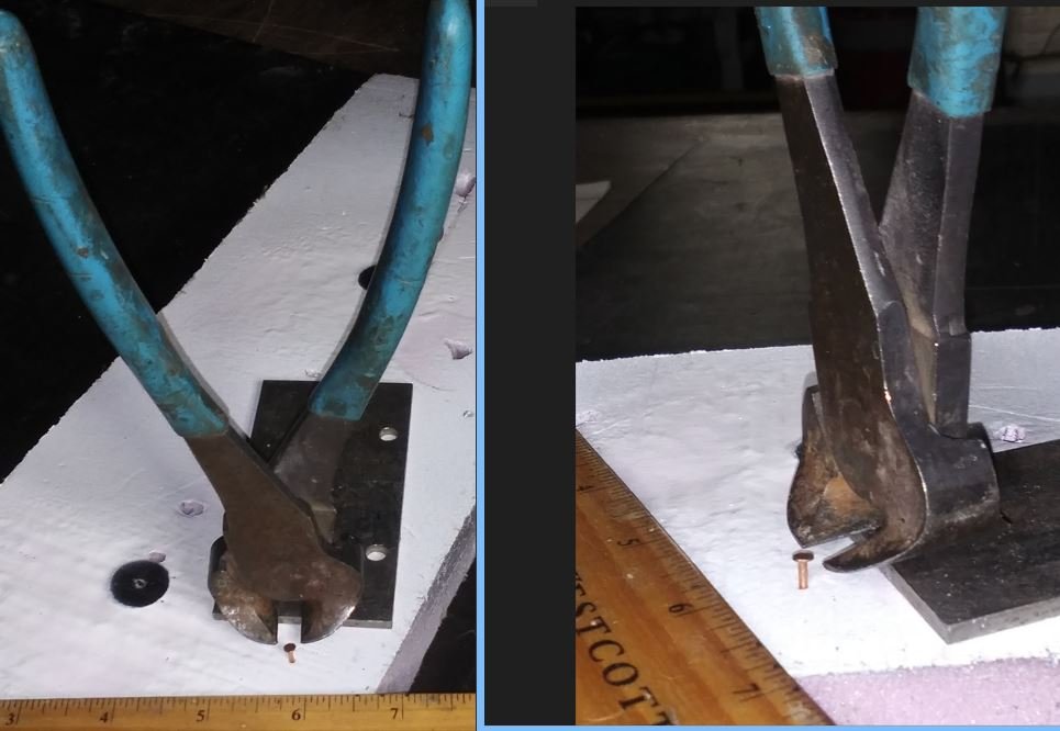

One of my all-time most useful tools is a Channel-Lock #357. They call it an "end-cutting plier". This tool will get under or pullout most any size nail or brad as long as there is anything it can grab on to, including headless nails. I use it with a steel plate under it to avoid marring surfaces when pulling.

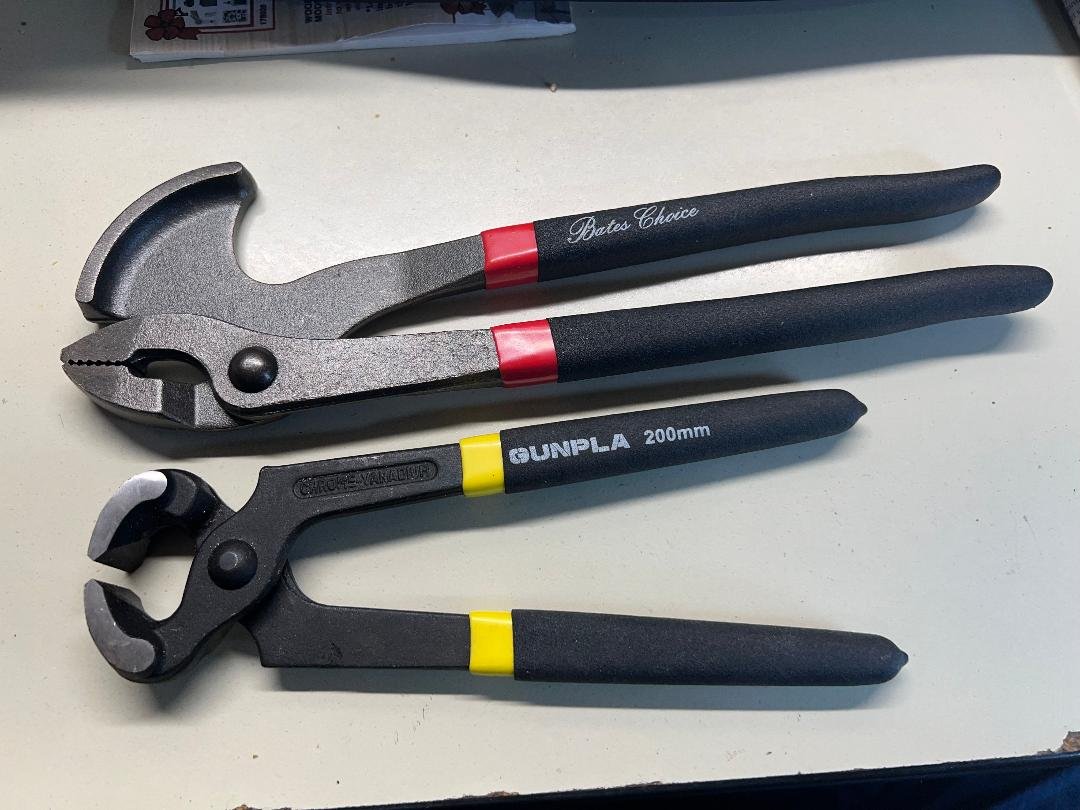

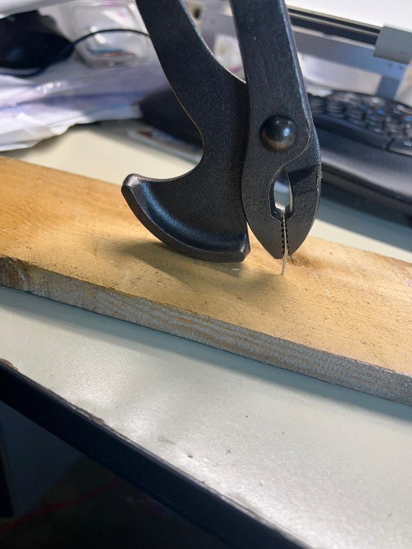

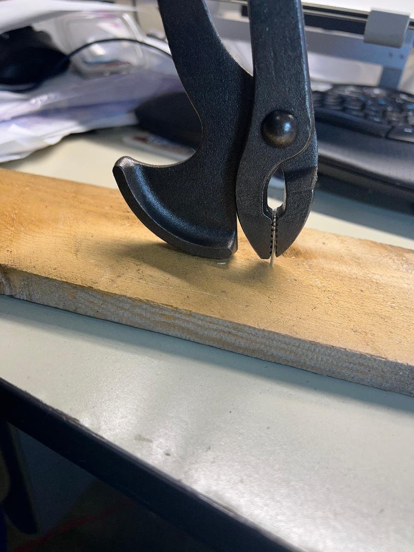

I shot a couple of pictures in case people are having trouble figuring out how this tool works. It uses the same principal as a standard hammer with the curved claw.
I have a tool similar to the one shown above and here is a shot of the two of them to reflect the differences:

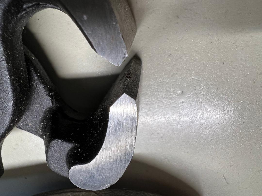

This is the one I have problems with with softer nails. The tighter you grip the more likely you are to just snip the nail off. Maybe I just don't have the control I need but I don't see this improving anytime ever. The jaws have a sharp edge as seen here:

I have had good success with channel lock pliers. Very much similar to yer new one.
