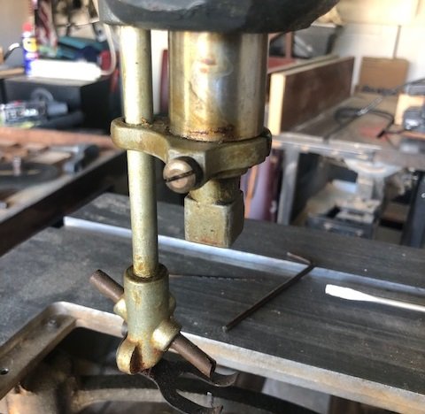

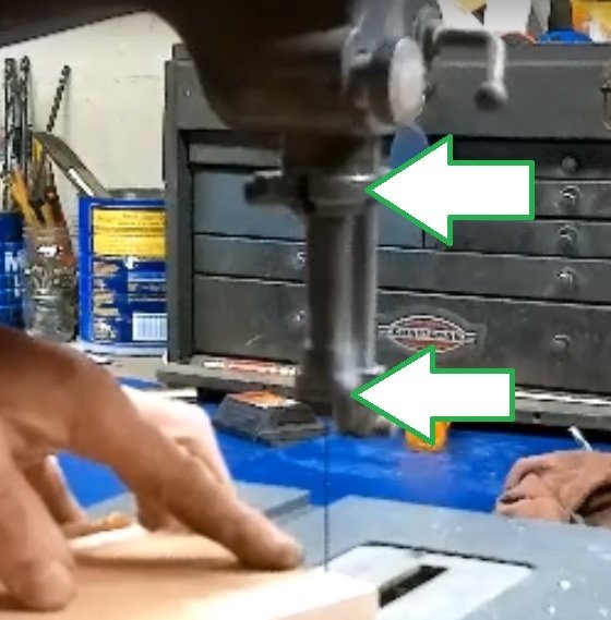

Also: I observed from a youtube video that the spring cylinder and upper guide bearing should remain static during the sawing, while the upper chuck does the 'sewing' motion. I'm not getting the same separation on mine; it stays firmly together -- probably why I've broken two blades now. Any advice on how to carefully separate them?

You have to lock the spring cylinder in place. The video kind of shows that at around 15:00 but he never explains it. The way to install the blade is put it in the lower chuck, loosen the spring housing lock ( the lock knob on the main saw frame), lower the assembly and attach the saw blade to the upper chuck. Then raise the spring housing fully up and lock it in place. That puts the tension on the blade and keeps the spring housing and blade guide from moving.
The video is very confusing and not correct. Do you have the manual? It will tell you the proper way to install a blade

Thanks for your fast reply! I do have a manual, although I think I may have a different issue - freeing up the spring cylinder and upper guide bearing from the upper chuck.

Thanks for your fast reply! I do have a manual, although I think I may have a different issue - I uploaded a small video depicting the issue here:
https://youtube.com/shorts/taQrew_fq6E?feature=share
I suspect the spring cylinder is gummed up with old oil that has polymerized over the years. I would disassemble it and clean it up. Add a few drops of oil to the leather seal on the air pump while you are in there.

Yes, it is all gamed up and stuck. The upper chuck and rod should move independent of the spring housing that is held in place by the locking knob.

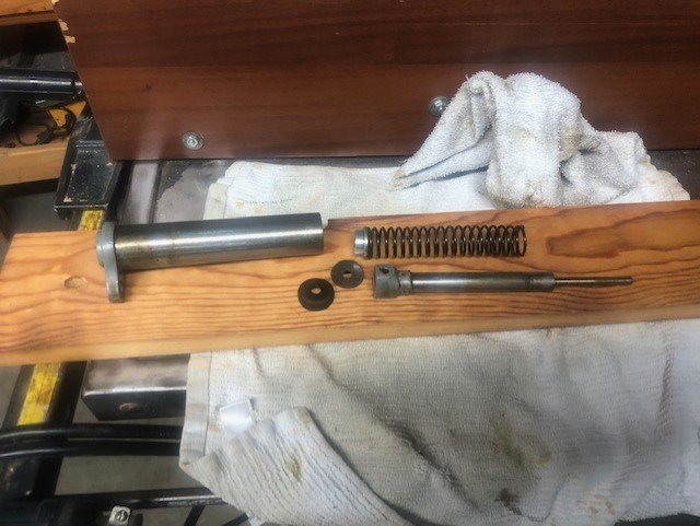

There were two versions of the Model A-34 Jig Saw for the Shopsmith Model 10E and 10ER just as there were two versions of the Jig Saw Manuals. The differences between the two versions of the Jig Saw included the Lower Frame, Drive Housing Cover and the number of screws for the cover. There were also two versions of the Table Insert with the first one being a closed keyhole and the other the open keyhole. Other parts were the same and the two versions of the Jig Saw worked the same. Like all part numbers at the time, they changed in November 1951. An example is the Guide Shaft Screw referenced below.
I have had a couple of the Upper Chuck Assemblies stuck in the Spring Cylinder Assembly on the Jig Saws I have restored. I would recommend removing the Cylinder from the Upper Arm. On the top you will find a Nut, Washer and the Leather Seal. Be careful with the Leather Seal as it can deteriorate over time. Remove these three parts before adding any lubricants to free up the Upper Chuck Assembly from the Spring Cylinder Assembly. It may be as simple as adding a few drops of oil down the cylinder or as difficult as using a penetrating oil of some type to free it up. In some cases, patience is needed to allow the penetrating oil to get things free. One I had was very stubborn and took days to free up. Removing the Guide Shaft Screw (P/N 134-29 in early manuals and P/N A 2217 in later Manuals) can help and allow the Upper Chuck to be rotated in the Spring Cylinder Assembly to help in removal. It is that screw which keeps the Upper Chuck from rotating during normal operation. You can remove the Spring Guide that is threaded on the end of Upper Chuck shaft under the Leather Seal to disassemble the parts once freed and clean out any residue before reassembly and use. Follow the maintenance recommendations by adding a few drops of oil in the top of the cylinder to help the leather seal work and lubricate the assemblies.

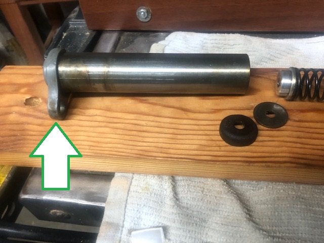

Excellent! I did succeed in carefully separating the two after a few hours of it soaking in some penetrating oil. I decided it could use a solid once-over so I took the whole thing apart and will be cleaning it and reassembling as per the advice above.
and here as well - although it's the earlier version of the A-34:
viewtopic.php?t=26016
One question: Should I try and separate the Upper Guide Bearing from the Spring Cylinder for cleaning?
