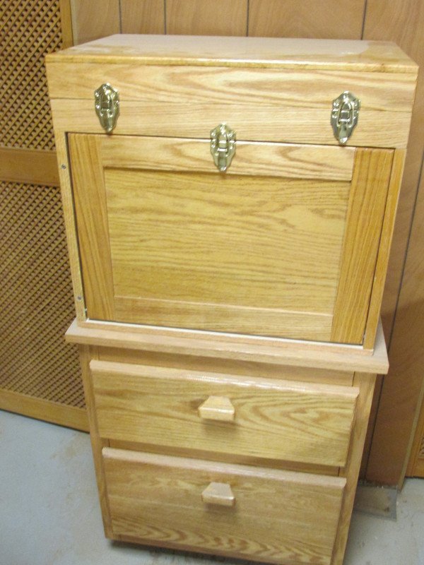

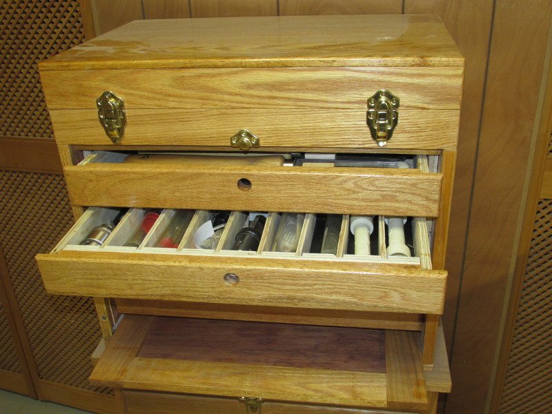

I considered adding a shelf years ago, but decided that it would add a lot of weight to an already heavy tool. That would make the Shopsmith more work to move around the shop.
Instead of a shelf under the Shopsmith I decided to built a tool chest on wheels that stays out of the way when working. My chest looks like this.

garys wrote: Thu Mar 30, 2023 8:59 am I considered adding a shelf years ago, but decided that it would add a lot of weight to an already heavy tool. That would make the Shopsmith more work to move around the shop.
REALLY NICE
