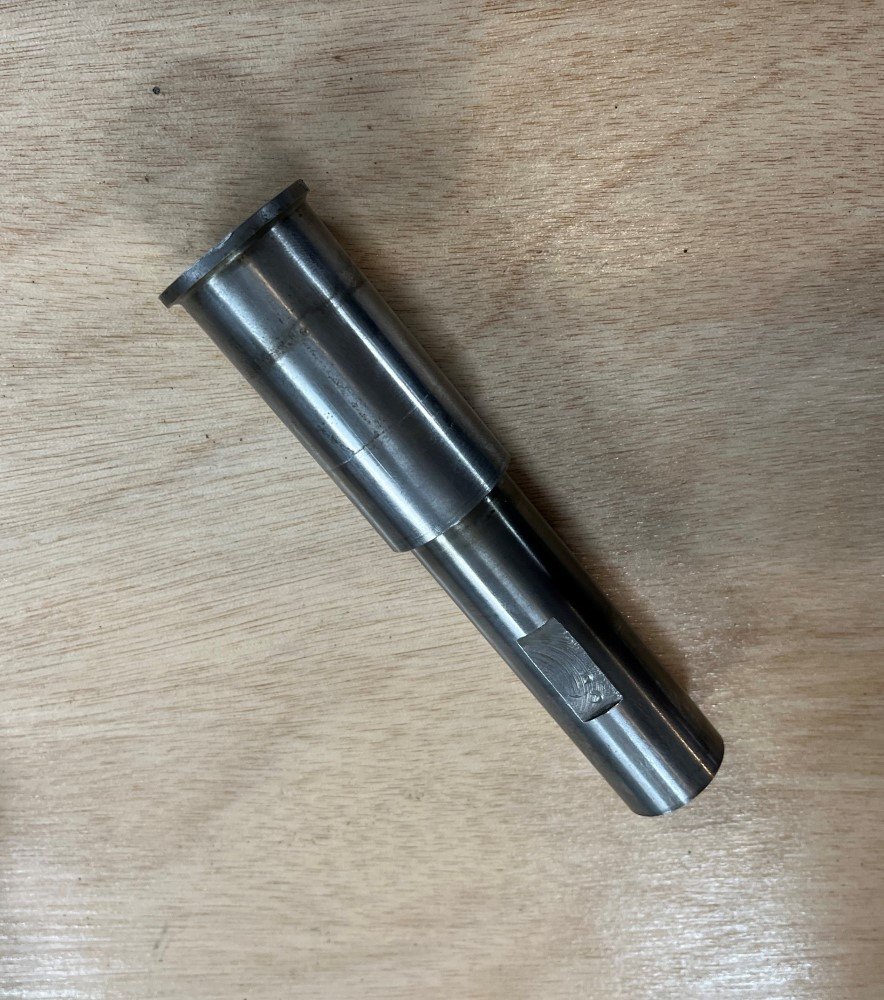

You said you were able to hold the Spindle still, but the Pulleys kept turning. If the Drive Sleeve Assembly Pulley kept turning instead of the Belt slipping on it, I would suspect the Set Screw for the Drive Sleeve Assembly Pulley is not tightened properly allowing the Pulley to turn on the Shaft. Did you happen to notice if the Drive Shaft was turning with the Pulley or not turning? The picture below shows the Drive Shaft from an early 10E. The flat spot is where the Pulley's Set Screw should be tightened against. The length of the flat spot on the Drive Shaft will vary somewhat depending on when your Model 10 was made.
_
102-15 Drive Shaft.jpg (207.3 KiB) Viewed 860 times
The only way the Quill's Spindle could be slipping with the Drive Sleeve Assembly turning is the Quill would have to be extended to the point where the Spindle begins to disengage from the end of the Shaft of the Drive Sleeve Assembly.

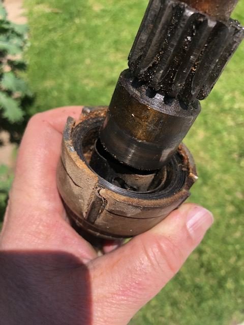

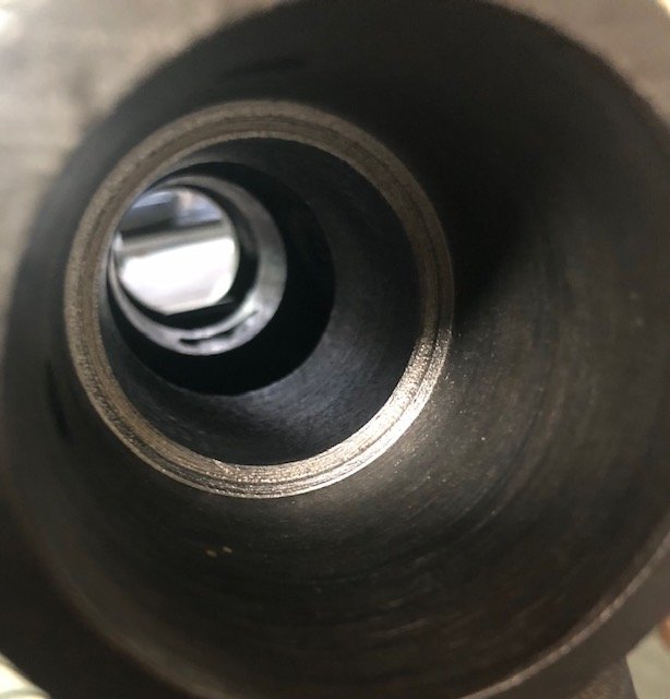

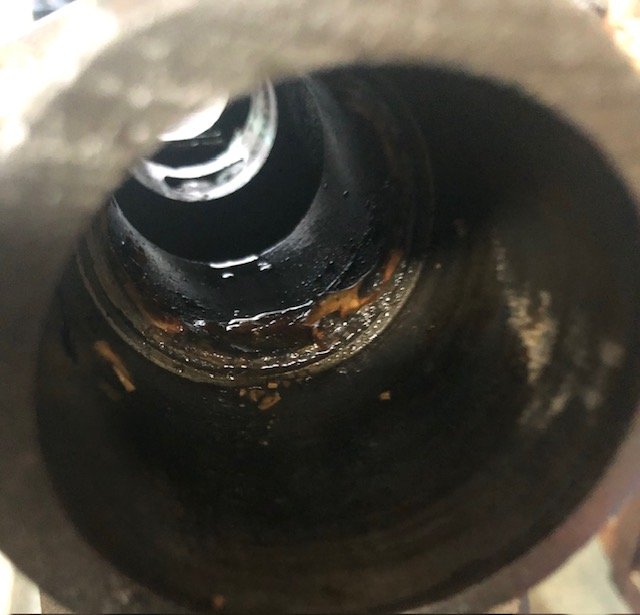

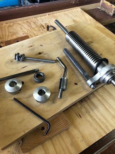

I've taken point to investigate by pulling out the drive pulley housing and quill and decided - what the heck - start cleaning everything involved here. I really haven't done much cleaning with my 10er since I bought it a over a year ago, and I'm getting comfortable enough to have a go.
First thing was the gummed up headstock inner bore - hard sawdust crust had accumulated to the point where it needed a wire brushing -
Next stop was to clean up the quill and handles

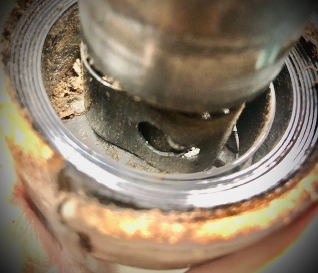

and the last step is to clean the pinion shaft and quill housing with its serious sawdust packing -- it also looks like the spring has also come off the retaining nub.
Spring nub off.jpg (65.73 KiB) Viewed 835 times
So I'll buy some locking pliers tomorrow and finish this off, I'll update with progress.
Scott E.
Posts: 3488
Re: 10er jigsaw intermittently working - but where is the disconnect?
The cleanup looks good. In the last picture above the end of the Quill Return Spring looks a little bent where it attaches to the pin on the Pinion Shaft. Should not be a problem with function once you get it back on the pin. You could try to carefully reshape it if you desire. While you have things apart do the bearings turn smooth and freely on the Drive Sleeve Assembly and the Quill Assembly? If not, you should replace the any bearing that does not turn smooth and freely. After both the Quill and Drive Sleeve Assemblies are cleaned up try inserting the Quill into the Drive Sleeve while still out of the Headstock to check they go together freely. I suspect the Quill did not want to retract all the way because of dust and debris but it is a good time to check the fit anyway.

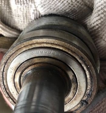

1) Tested the current bearings/bushing on the drive sleeve and found them dirty but solid for now. I also took note of the bearings # in case I need to replace them: ND C88505

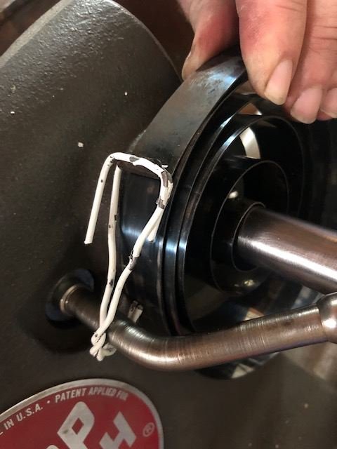

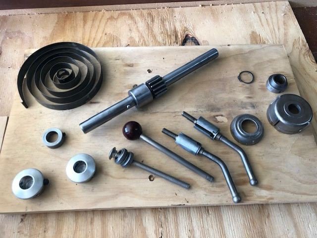

2) Wire-brushed every piece and applied SC Johnson Paste Wax on the teeth of the quill and a light touch of 3 in 1 machine oil on the rest - I also curled the inner center of the spring a bit more to try and ensure connection with the holding nib as per your advice.
3) Cleaned out the return spring assembly - and the sawdust of ages. Placing the spring back, I made a variant of this wire jig:
https://youtu.be/KQQhq6pBoro
But mine was just a coat-hanger, cut and twisted for strength. Worked OK; gloves, glasses and all.
In the end I learned a whole bunch more about my little 10er just by getting my hands dirty, had a few setbacks but worked through them. I think I earned my Tinkering merit badge along the way. Slowly this 10er dieselpunk beauty gets less arcane and more and more accessible.

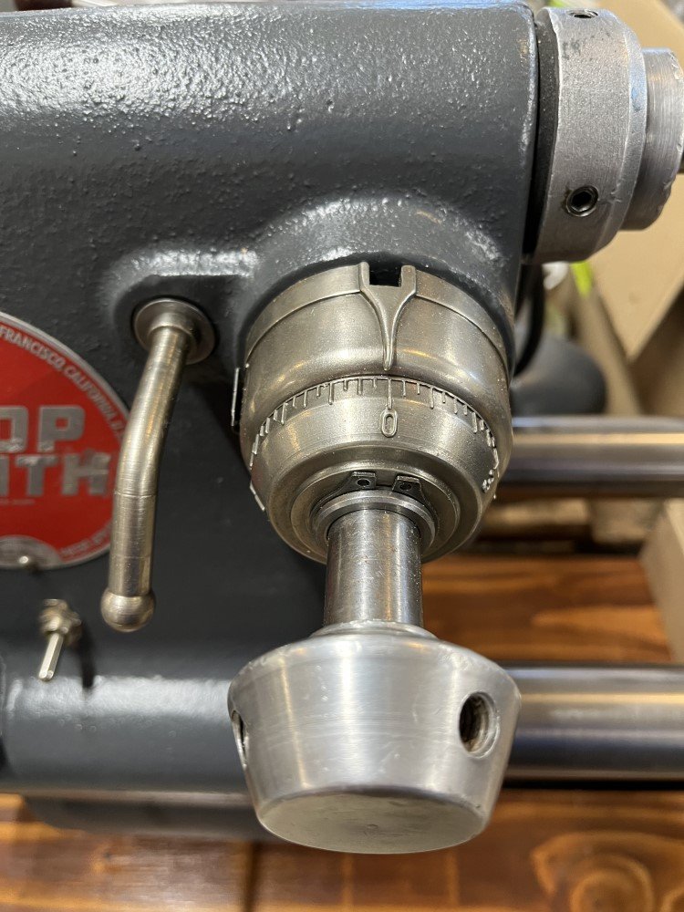

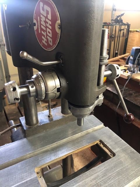

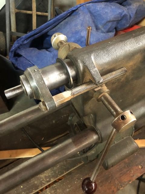

It's looking better, shiner and likely works better too. As I already posted in your thread about the Dial Indicator I said

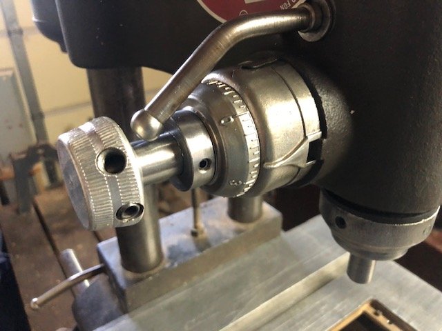

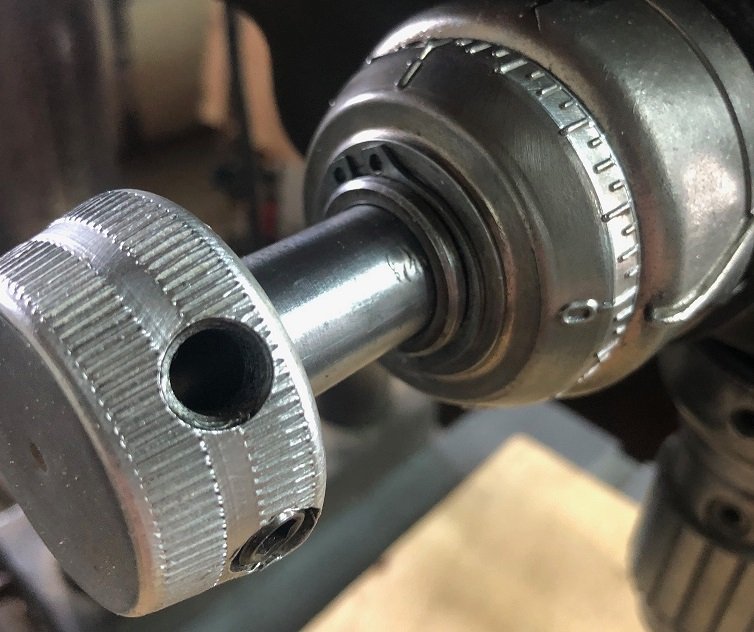

I noticed in your second picture you have the Collar turned around. It should go on first against the Spring Housing to hold it against the Headstock Casting. The Depth Indicator then goes on held in place by the Retaining Ring.
It is also shown in pictures 5 and 6 above. That's an easy fix. Don't feel bad, I have put parts on reversed before even after I know better and ended up scratching my head wondering why it doesn't work right.
With the work you have already done you are well on your way for the complete restoration.
Below is the picture from my post in the Depth Indicator thread showing the correct order.
