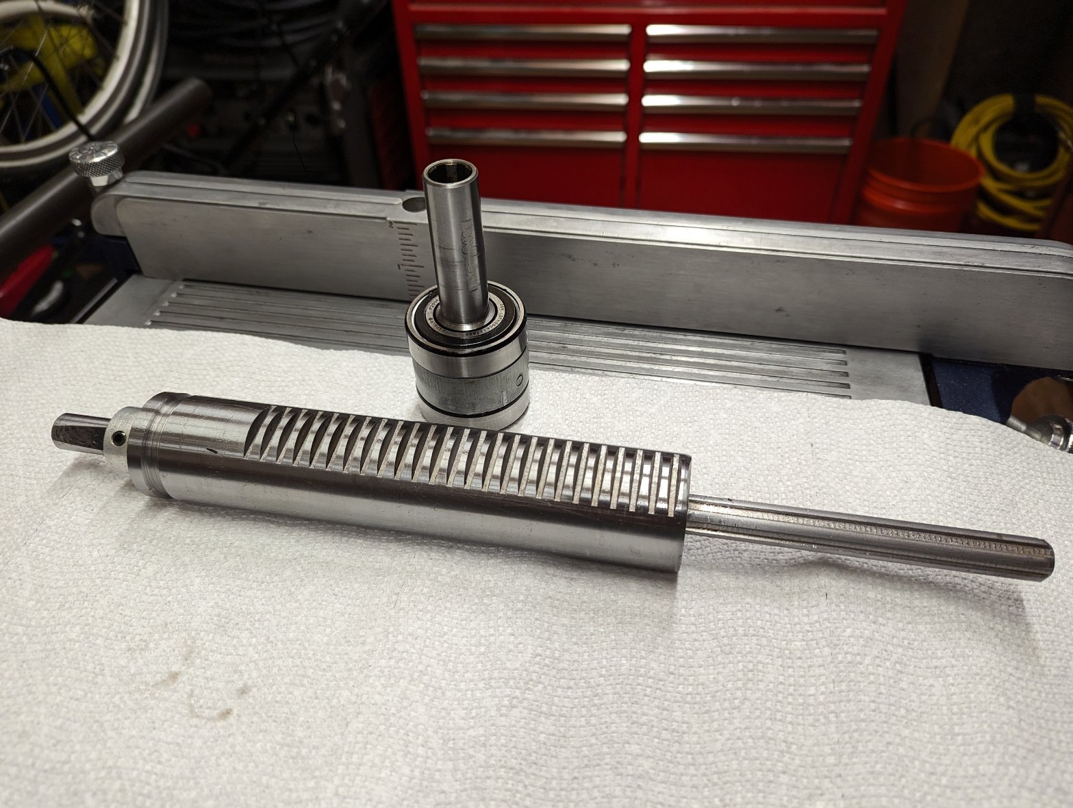

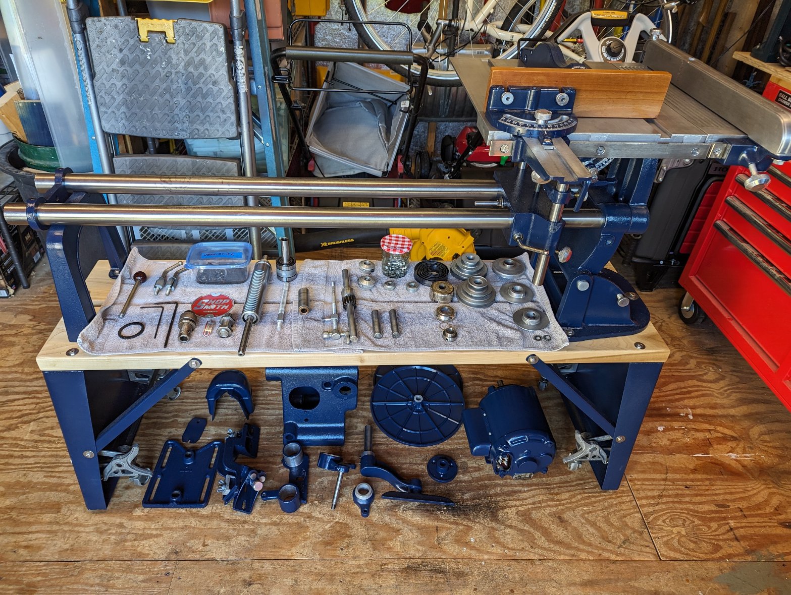

Feeling pretty good about the SS restore so far but I have run into a small problem replacing the drive bearings that I hope someone here can help with.
I watched the SS YouTube videos on bearing replacements and all went well with the Spindle bearings but the new drive shaft bearings are stiff, after thinking about it I noticed the spacer looks like it is shouldering on the outside race not the inside race therefore the last strike with my dead blow hammer would have transferred pressure to the outside race and damaged the bearings, any thoughts on this? hope I am wrong as those bearing were original part numbers replacements and expensive.
PS: To help me out a little bit I put the shafts in my chest freezer at -10 deg. to shrink them a bit and the spindle bearings went on with very little pressure.

Re: New Shopsmith Owner
