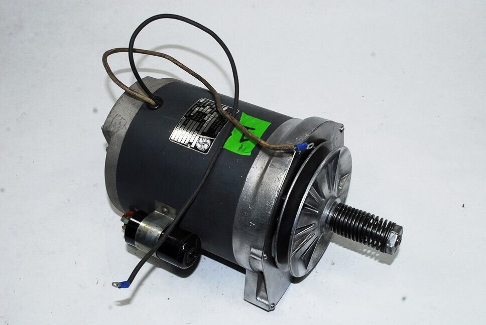

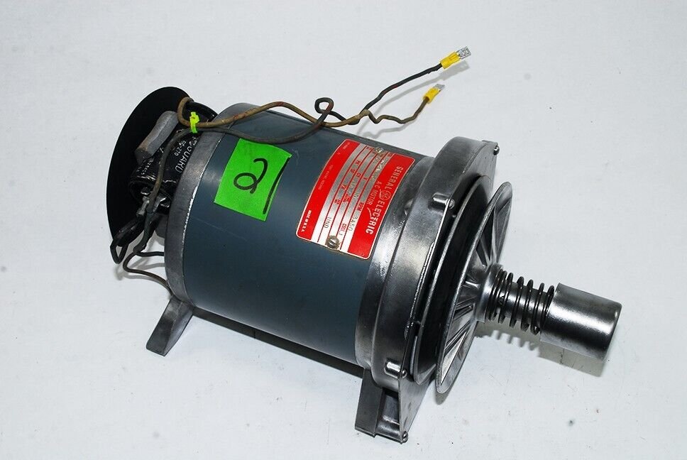

I am guessing it is a Mark 5 Greenie from the 1950's or an early Goldie Mark 5. They used the Gilmer Belt as opposed to the Poly V Belt used since the early 1960's. The original motor would have been a 3/4 HP motor. If your Shopsmith has a made for Shopsmith motor the parts should work but you may need more parts than you ordered. The 1st picture below shows an A. O. Smith motor from a Mark 5 Greenie. You will notice in the picture there is a spring and a bolt on the end of the shaft to retain the spring. It is this spring that keeps tension on the movable sheeve to make the speed adjustment system function. The 2nd picture below shows a G. E. Motor and notice the cap used to help retain the spring. Emerson motors were also used in the early Mark 5's.

- Motor A O Smith 3-4.jpg (80.3 KiB) Viewed 10101 times

- Motor GE 3-4.jpg (79.54 KiB) Viewed 10101 times
