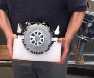

My impression is of two piece mounts consisting of Gen 2 - Upper and Lower Vs Gen 1 Inner and Outer. Here is a telling view of the mounts:
When he does the belt tension, you can see that there are studs or bolts in the upper and the position and tilt (pitch) of the motor is set by two nuts on each stud. It's hard to see the studs in this picture against his dark shirt. Adjustment is similar on Gen 1, except that when you are done adjusting you lock the inner and outer mounts together with machine screws.
- David
