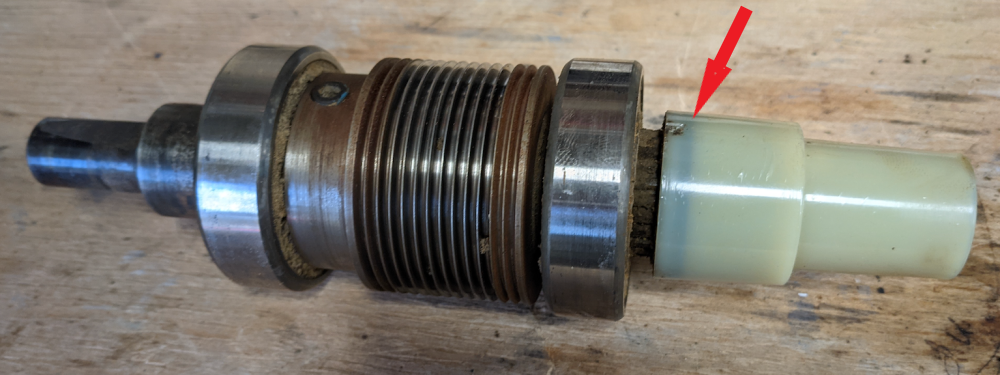

I believe, as others do, that the problem may not be the Quill Assembly since you have tried a different Quill and the problem persists. It is hard to believe that two different Quills would have the same issue. Use the suggestions others have given trying other attachments on the Quill's Spindle to see if it still "judders." Beyond that check the Drive Sleeve and especially the plastic part called the Drive & Ring for excessive wear. The Drive & Ring is indicated by the arrow in the picture below. The Ring is the metal band just under the arrow that holds the Drive on the end of the Drive Sleave Assembly.
