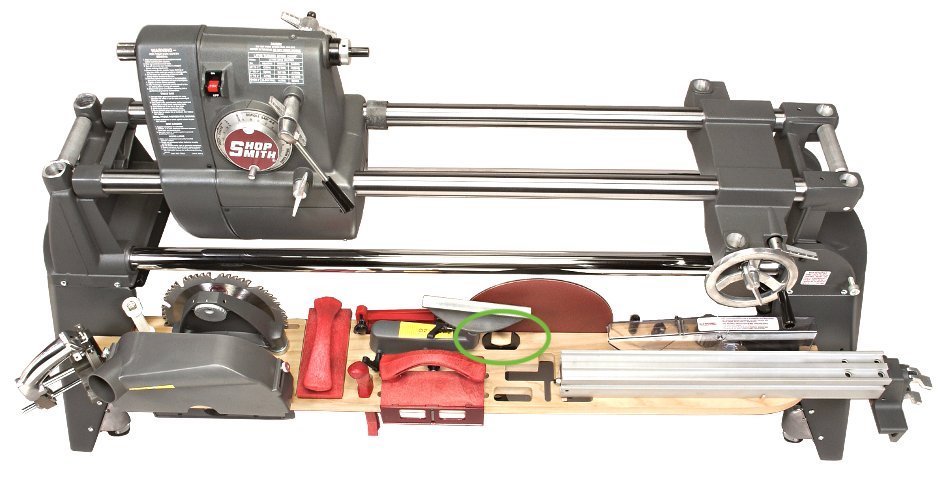

Since I've upgraded my Greenie to a 510, I need to make a new accessory shelf. I'm using the official one as a starting point. There are two slots in front of the sanding disk. In the photo from the SS website there seems to be something stored there. What is this object (circled in green)?
Thanks!

Arbor wrench?

Ah yes! I see it now. Obvious now that I know what it is ;-)

My mind wanted to try to make it into something lying flat. But it's the jaws of the arbor wrench sticking up. The rest of the wrench is hidden from view.

I blew the pix up and tweaked it. I now 'see' the edge of the wrench.
What goes in the smaller slot to the left? Clearance for the quick lock handle on the tool rest? NOPE!!!!

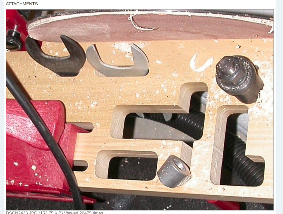

This earlier discussion shows another wrench in the smaller slot.JPG wrote: Mon Aug 21, 2023 10:13 pm I blew the pix up and tweaked it. I now 'see' the edge of the wrench.
viewtopic.php?f=9&t=378&start=10
--Keith

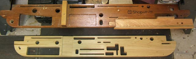

Thanks, Keith! That answers that! Makes sense to keep two wrenches together. That thread you linked led me to finding this:
A slightly different arrangement than the one I pictured but similar enough.
I find the shelf very handy. Yes stuff gets buried in sawdust pretty quickly but I usually blow the whole machine off with compressed air before I put it away, so I blow off the shelf as well then sweep up the floor.
That said, on this one I'm going to staple a piece of cloth across the inside edge which I can pull forward and over to cover the shelf. Not sure if I'll like or not, but I'll give it a try.
