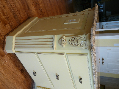

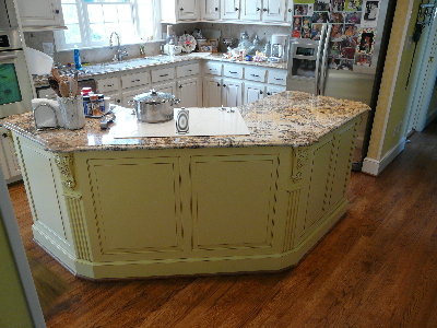

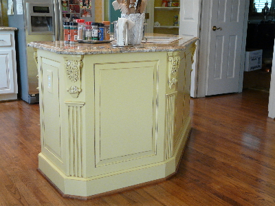

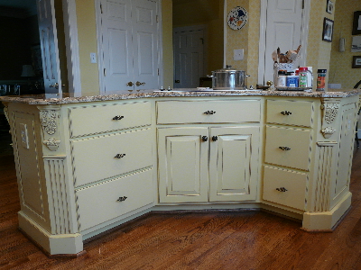

These pictures are of a recent island that I built for a customer.
Thanks
Mark
PS
Sorry about the rotation I still can't figure it out. I can turn them any way I want in my PhotofunStudio, but the ones I take with the camera rotated always come out rotated when I attach them.
Thanks
Mark
PS

GREAT work on that island. I can't say I like their taste though.

It is just tinted Precat MLCampbell lacquer with a dark brown glaze around the cracks and crevices and then a clear coat. I did not pick the yellow, they paid an interior decorator big bucks to come up with that.

Wow! Customers all have different tastes. However that is one show piece of workmanship! Loads of detail work! Congratulations, Mark! I can only assume you were handsomely rewarded.
After enlarging to 300% we (my wife and I) could more clearly see your customer now has a stove top in her island. Is that a marble top? Beautiful!

Thanks for all the complements. The top is polished granite done by a local granite shop.

First what are you saying here. "It is just tinted Precat MLCampbell lacquer with a dark brown glaze around the cracks and crevices and then a clear coat." Are you saying you tinted the lacquer with dark brown glaze or did you tint the lacquer with I think white (but perhaps yellow since you mentioned it)? Then applied the glaze and then a clear coat.
I guess my next question would be what yellow to me the cabinets look like an off white that is so popular in todays cabinets. Or is my monitor colors off?
