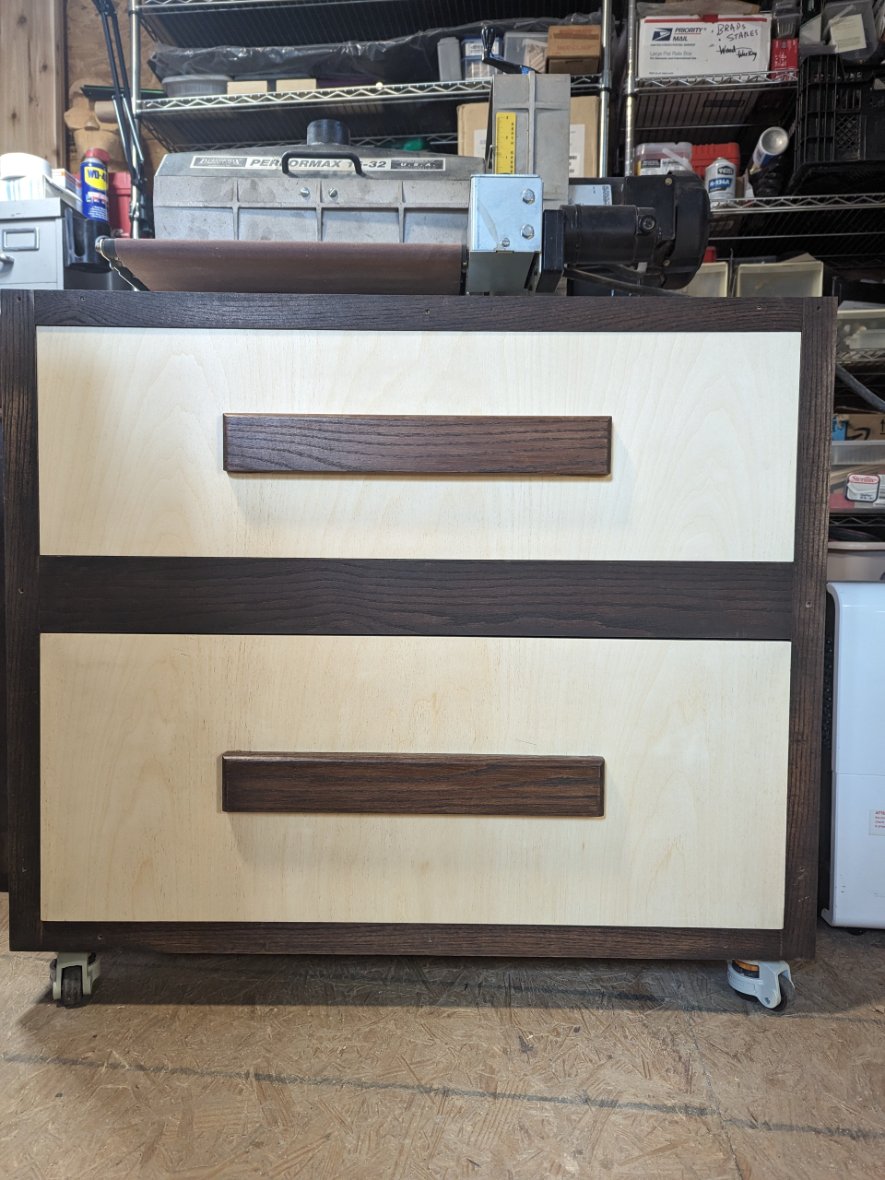

Following up on this discussion; I've finally got a cabinet base 95% complete for the drum sander. I wanted the ability to level the sander up with the SS or my table saw as infeed/out feed tables, but most of the time, I just want to roll the thing wherever needed. Oh, and I needed a lot of storage space for SS stuff.

I found casters which have an integrated leveling foot. They wouldn't be the ideal solution for leveling up a bench against a wall where the back feet are inaccessible, but they should do for leveling up to other surfaces in the center of my little shop. If I'd realized how heavy this beast is, I might have gone for the heavier-duty version. Link to Amazon: https://a.co/d/9LkrUWS
The amazing thing is that both drawers can be fully opened without flipping the cabinet over. Every time I look at that SS jointer, I think "aircraft carrier."
Next up: clean up the belt sander and joiner (yeah, I've been reading the joiner thread...my backup is a Bailey #6.
