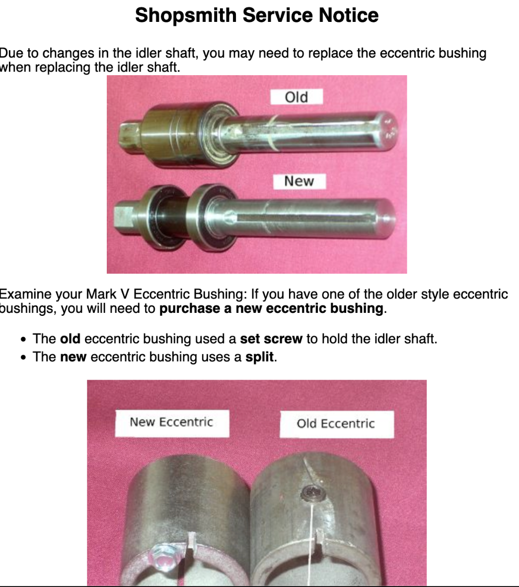

Posted: Fri Sep 01, 2023 9:12 pm
by HopefulSSer
The same info on the current website
https://www.shopsmith.com/ownersite/cat ... r_note.htm
Screenshot 2023-09-01 at 9.12.20 PM.png (940.3 KiB) Viewed 2302 times
