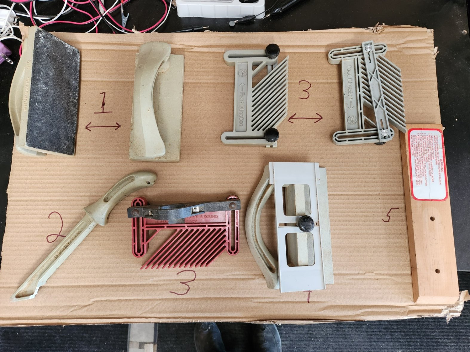

Again, what are these used for.

Thank you all so much for helping me identify parts. I looks them all up on SS and you tube so i can see how and when to use them. I have a few more parts I don't know about. Which ones i should used for what. I just turned 77 last week and this is all very new to me, lots to learn.
Thanks in advance.

These are largely safety items.
1. Push block -- safety tool good for controlling stock when jointing/sawing.
2. Push stick -- another safety tool good for controlling stock when jointing/sawing.
3. Grey one is a feather board. Used when rip cutting to push stock against fence.
3. Red one is a quill mounted feather board for shaping operations used to hold stock down to the table..
4. Fence riding push block for 510 fence; hooks over fence and pushes stock -- good for thin rip cuts
5. One wing of the shaper fence. This is part of the shaper fence.

OK, thank you very much. I'll look at some videos now.
