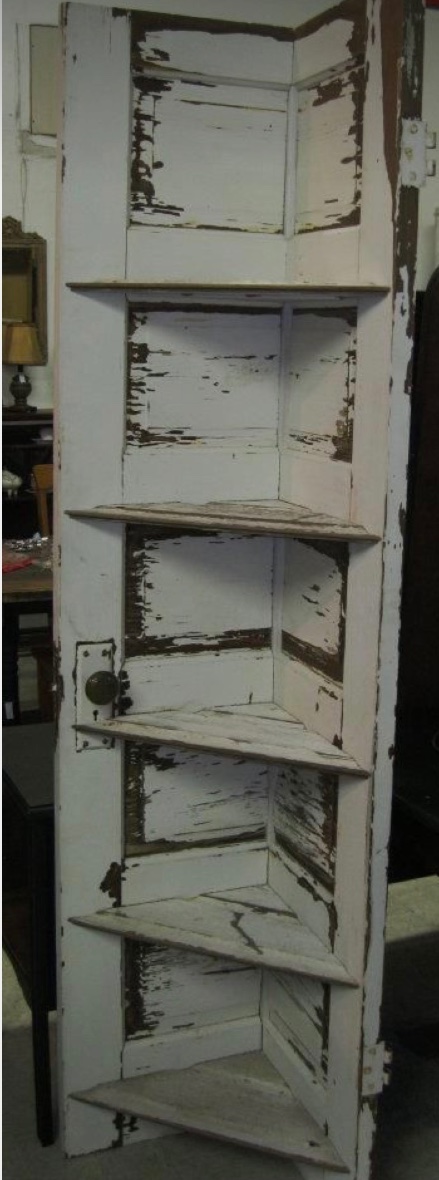

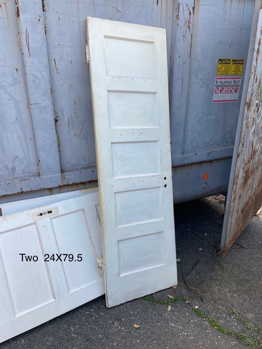

I’m cutting old 5 panel doors down the middle and making corner shelves. With the 5 panel doors, the saw surface is uneven between the panels. These doors are about 1 1/2 inches to 1 3/4 inches thick. (See photos). Any suggestions here would be much appreciated.
this is a door I will be cutting
this is an example of what I'm making

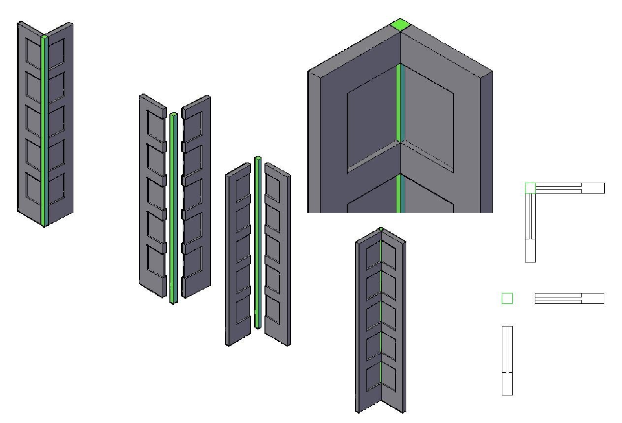

What if you rip the door in half then make a filler piece 1.75x1.75 to fill the inside corner. If you can duplicate the ogee trim you could cope pieces to cover the panel edges. No miters required. If you want to miter the long edge I think I would still rip the door in half and then have a lighter piece to work with.
I didn't take the time to make the trim pieces but hopefully you can see what I mean.

larryhrockisland wrote: Sun Oct 29, 2023 11:31 pm What if you rip the door in half then make a filler piece 1.75x1.75 to fill the inside corner. If you can duplicate the ogee trim you could cope pieces to cover the panel edges. No miters required. If you want to miter the long edge I think I would still rip the door in half and then have a lighter piece to work with.
Larry,
I like your simple solution, I’m thinking I’ll try that first. I don’t think that people who are interested in buying this style of corner shelf likely wouldn’t pay much attention to which method was used to attach the sides! Keep it simple stupid, Doh! 🙄
