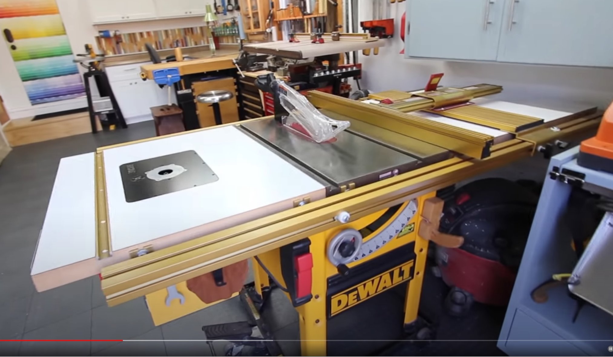

Only coming out of lurker mode for this post, because a forum regular asked me to return to the forum recently and because I think I can help on this specific thread. Playing the "What If?" game, I have often thought about what I might do differently if I never had my Mark V. Having watched too many YT woodworking videos, I really like the concept of having a solid TS (high end would be a cabinet TS, but it doesn't have to be), but with the Incra rails and positioner and a router wing dropped in. One of the YT woodworkers that I admire is Blake Weber and below is a pic of his DeWalt DW746 table saw. I believe this saw is very similar to the Delta 36-725. I believe these are, or were, called "hybrid" tablesaws. Basically the manufacturers took their best contractor grade tablesaws and put a solid cast iron table of good size on them and beefy legs to make them stationary saws. So, not quite a full cabinet TS, but perhaps a notch just below them. Posting this because I like what Blake did with the router wing, his own custom dust collection box on it, the Incra rails and of course the Incra setup. The Incra LS positioner can be used both for the TS and for the router in this kind of setup, i.e. dual purpose. The SawStop dust collecting sawguard is nice as well. The difference of what you are looking for is in making it one solid cabinet. Unless the legs on the Delta 36-725 are weak, I would consider something similar to Blake's setup and have rolling cabinets perhaps that can be nestled underneath. That way if you ever have to replace the Delta 36-725 due to it breaking, too expensive a repair because of that motor, etc. that you just swap whatever you added as features to the TS and simply move them to a new one. Then hopefully the cabinets will fit under the new one. Dedicating an entire cabinet to a custom build to fit the Delta 36-725 may come back to bite you later, should it finally break one day. IF yours has seen better days, perhaps consider the DeWalt DW746 if you can find one locally, or look for similar hybrid type tablesaws. On the used market, they should be inexpensive and I believe several manufacturers competed in this market for a while. Maybe some still do. Hope this helps.
IF the Delta 36-725 has add-on cast iron wings then they might make sense to bolt on. Other than this, wondering why you are considering a cast iron router wing to add instead of a good quality laminate router work surface? I see those cast iron router tables on the market and they seem like overkill to me and I don't think they sell very many of them.
With regard to assembly table, if your shop is large enough, what I would suggest is to build a separate assembly table and make it an outfeed table for your TS. Almost every YT woodworker has a SawStop cabinet TS and have built assembly tables behind it to perform the outfeed function. Lots of examples, but if you would like inspiration let me know and I will post some pictures. Would love to see what you create with it, so please post pics if you give it a go. Good luck. Going back to lurker only mode again now since most of the forum doesn't want me here.
- DeWalt_DW746.jpg (234.74 KiB) Viewed 85711 times
