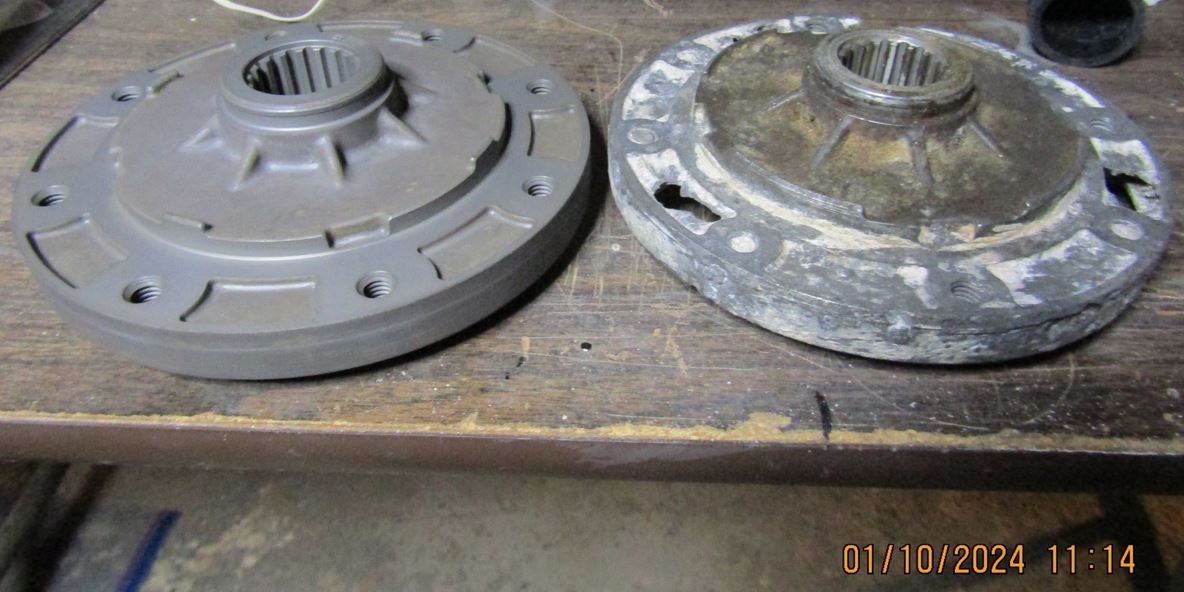

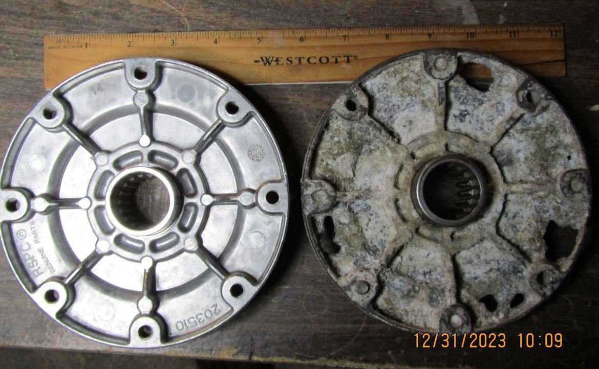

The Speed Queen was filthy, but the brand is highly recommended and the price was right so I bought it for $140. Took the inner tub out (the perforated one that spins around) and found much crud within (in-between this tub and the outer tub - yuck). Also found that the inner tub was mounted on a cast aluminum flange hub that was severely corroded (see pic).
No way was I going to re-use that corroded hub - I will replace it, and I want some kind of protection on the new hub to keep it from also corroding. I am very surprised that a quality brand like Speed Queen would put such a component into severe service without some corrosion protection.

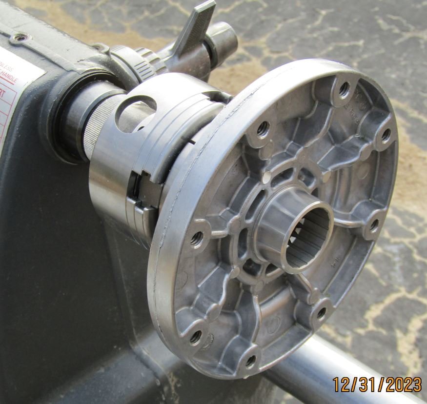

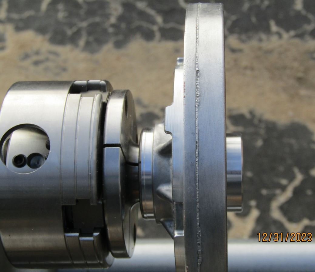

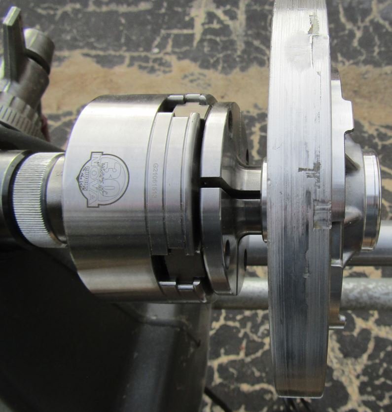

Bought a lovely new hub and solvent-cleaned it. OD had some ragged flashing so I used my trusty Shopsmith and my Nova G3 chuck to lathe-sand the hub (see pics). Next step is to apply corrosion protection - but not paint, and not "black oxide".

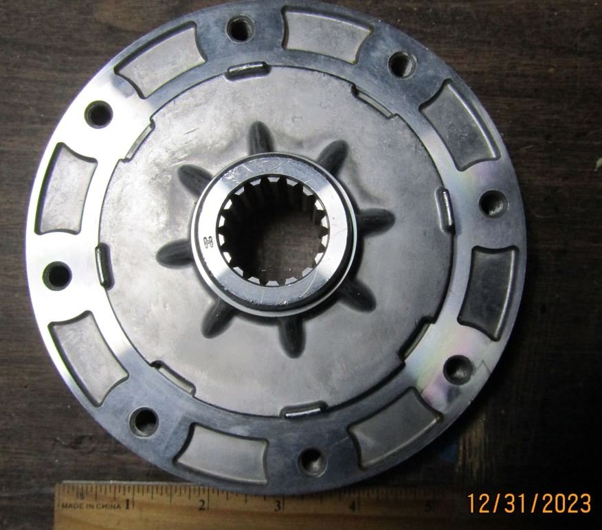

- NEW HUB
- P3.JPG (103.21 KiB) Viewed 75120 times
- NEW HUB AND OLD HUB
- P4.JPG (152.41 KiB) Viewed 75120 times

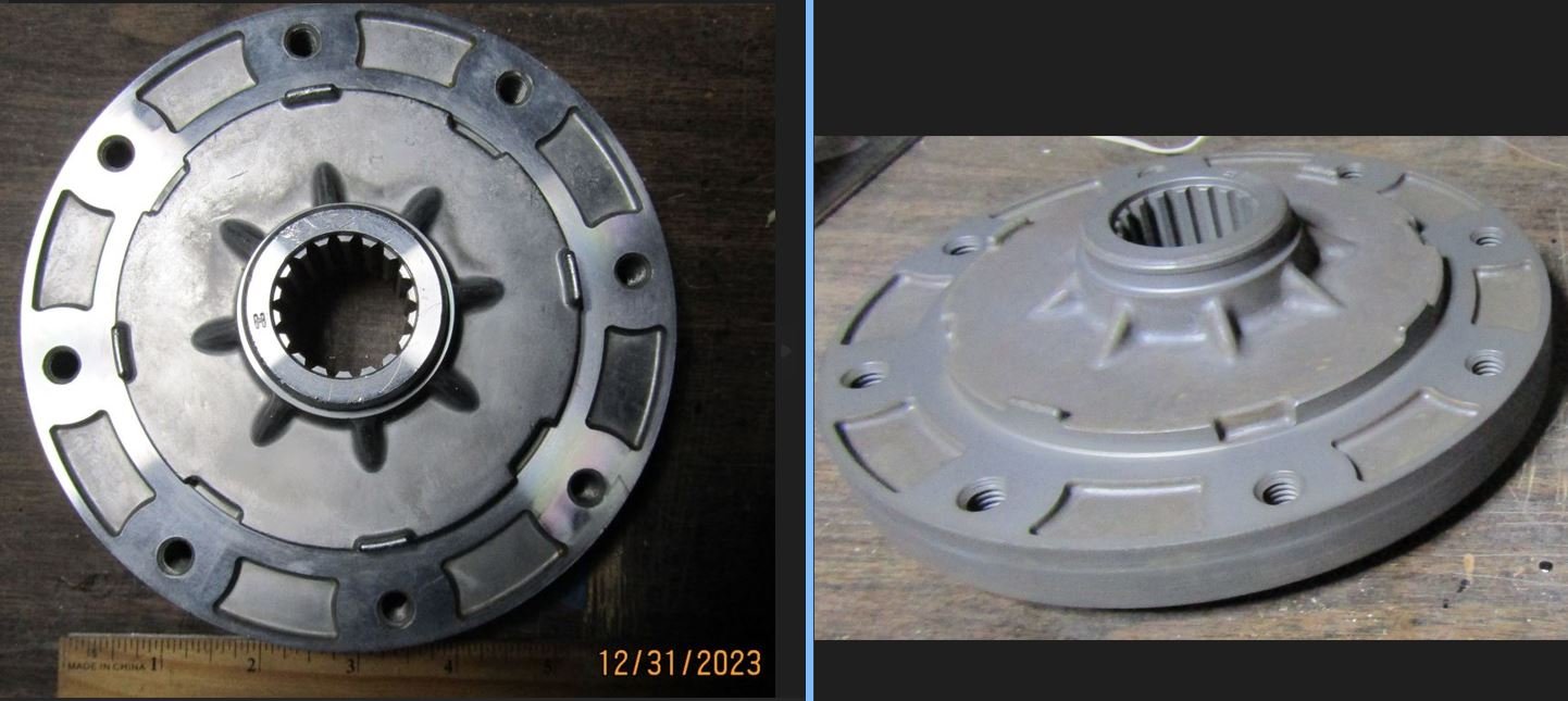

- NEW HUB MOUNTED ON SHOPSMITH
- P5.JPG (96.55 KiB) Viewed 75120 times
- FLASHING ON OD
- P6.JPG (88.54 KiB) Viewed 75120 times
- OD MOSTLY CLEANED UP BY SANDING
- P7.JPG (82.83 KiB) Viewed 75120 times

Anodized hub arrived, and installed. Anodized per MIL-A-8625 Type II Class 1.This is a clear anodize, and less thick than Type III "hard" anodize. I chose Type II because I did not want to risk using the thicker Type III and then have problems with thread and spline clearances. $125 from Maryland Plating and Servicing Inc. Photos below.
The anodizing process creates a porous surface structure, which is then filled/sealed with nickel acetate, thus providing the anti-corrosion surface.
Alodine maybe would have been a sufficient anti-corrosion process for this application, but I guessed that MIL anodizing would hold up better in a hot/wet environment. Time will tell.

- ANODIZED HUB 1 WITH PRE-ANODIZED HUB.JPG (124.55 KiB) Viewed 73650 times
- ANODIZED HUB 2 WITH OLD HUB.JPG (110.65 KiB) Viewed 73650 times
