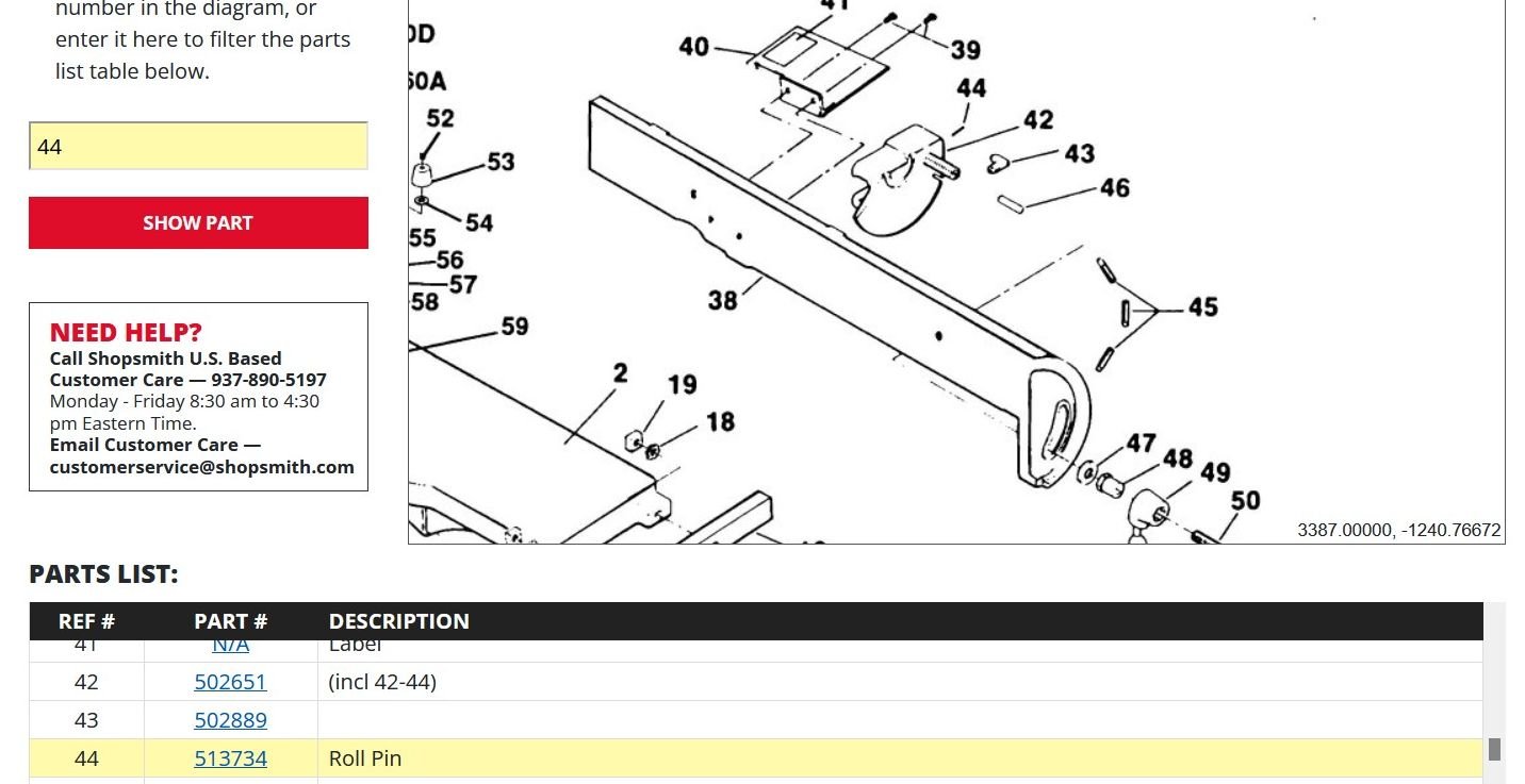

Current version should fit a 4E.(#42) >$50
- joiner quadrant.jpg (121.32 KiB) Viewed 17612 times

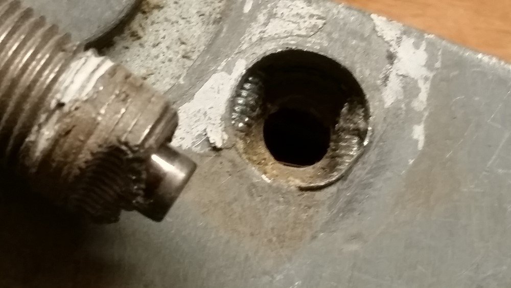

For those wondering what damage happens to the Jointer Quadrant it is shown in the picture below. This can be caused by over tightening the Fence Lock stripping the Internal/External Threaded Sleeve out of the Quadrant casting.
_
- Quadrant Damage.jpg (81.42 KiB) Viewed 13874 times

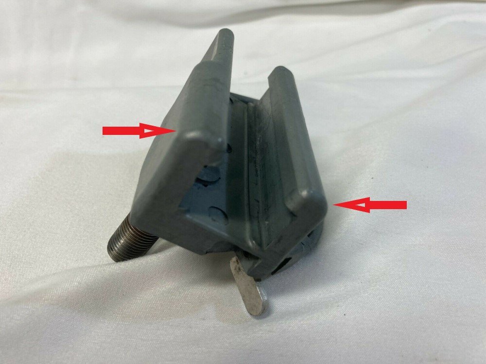

Over tightening can also cause the Quadrant to spread apart at the opening that goes over the Fence Bar indicated by the arrows in the picture below.
_
- Quadrant end arrows.jpg (105.45 KiB) Viewed 13874 times
NOTE: the Quadrant pictured above is not damaged.

If you refer to JPG's first post showing the parts diagram you are looking for some or all of the parts that are reference numbers 42 to 50 if I understand you correctly. As I said in my first post, all changes and upgrades can be added to older Magna/Shopsmith 4" Jointers except the Dust Chute to the original Model 4E Magna Jointer. Some parts can be replaced as individual parts while others require being replaced as assemblies.
You said,
I have an old Magna jointer that the bolt stripped out of the quadrant. I see the new version has a stud that is hollow, a bolt that tightens the inner dowel, a different handle, and a part or two I missed.
The stud I believe you are referring to is part of the Jointer Quadrant Assembly part number 502651 (reference # 42 to 44) and has always been hollow with threads inside and outside. The Bushing nut (48) locks the tilt of the fence threaded on the outside of the stud while the bolt (50) locks the fence to the Fence Bar threaded on the inside of the stud. Depending on the age of your Jointer it may have different parts reference numbers 47 to 50 for the lock parts and handle. That change occurred in the 1950's. If yours had the earlier parts, than 47 to 50 will replace them. On the Jointer service parts page all the parts I listed appear to be available.
