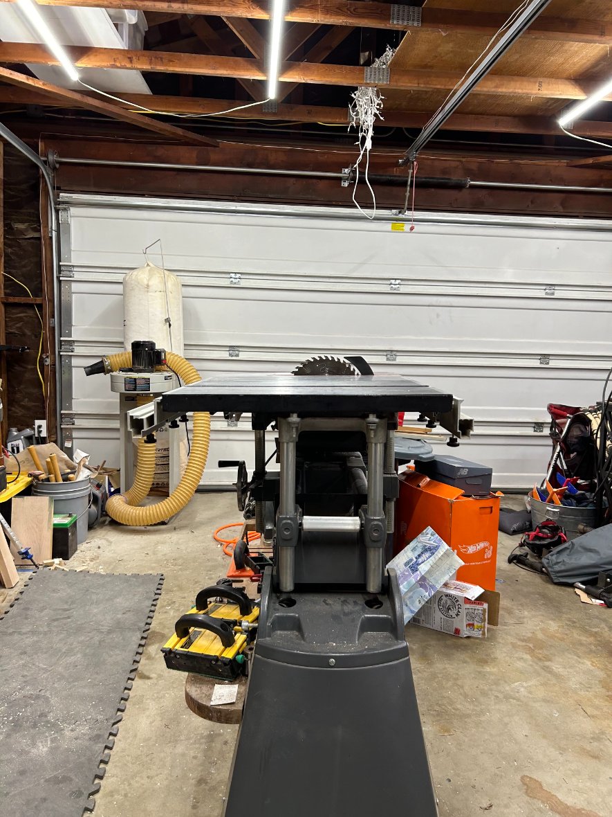

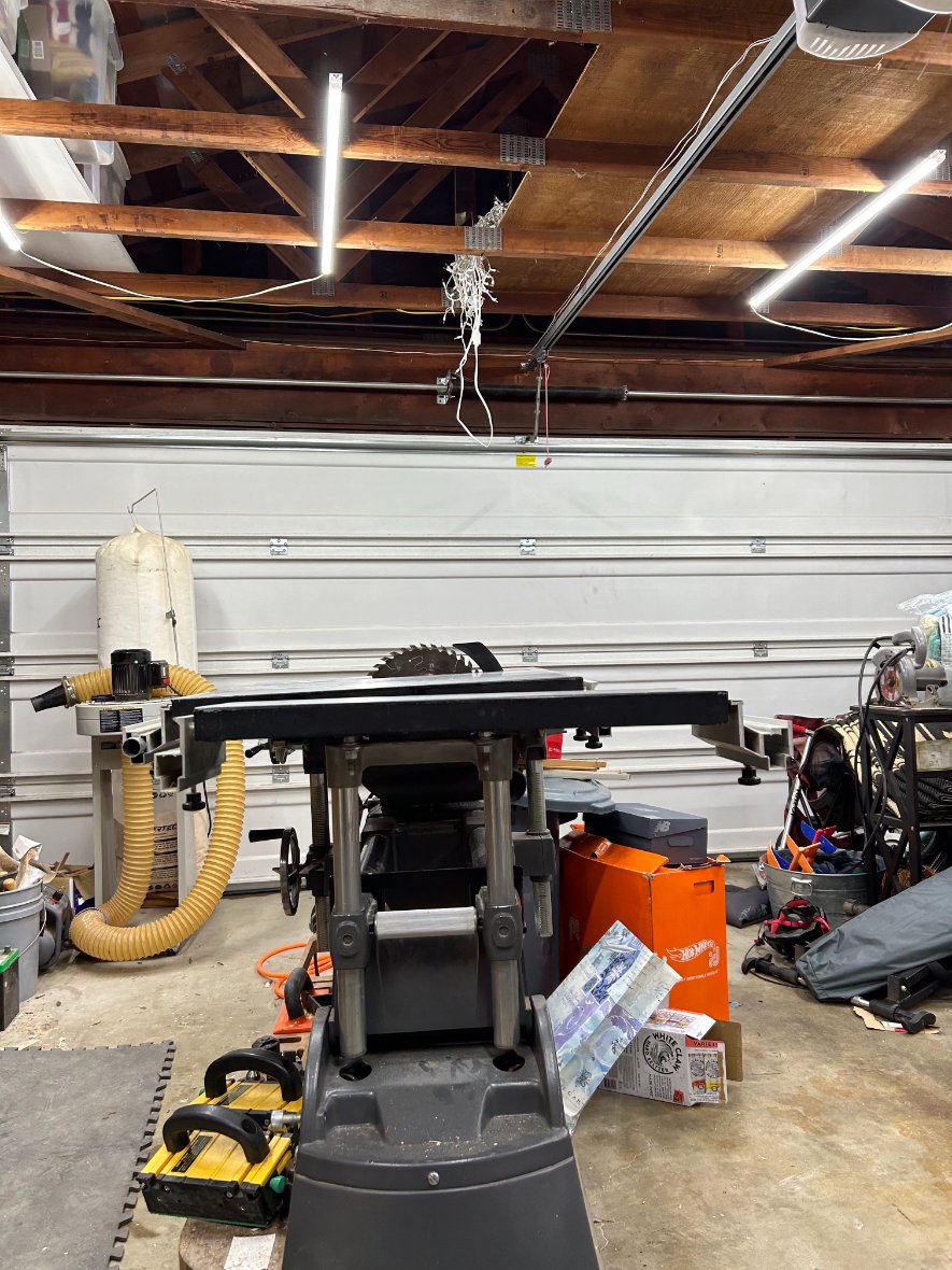

Whenever I need outfeed support, I do the old school way of using the extension table on it's base mounted to the Mark V backward, then using a rail to attach another extension table. Like in this video (https://www.youtube.com/watch?v=mg9JazGDRag). But every time I do it, I notice that something isn't right. I have my the table that is on the base aligned to the main table perfectly. But when I turn it around backward, it is sloped downward. All of this tells me that the main table is somehow not aligned right. But I don't know of any adjustments for the front to back slope (see photos of table mounted regular and backward). I've looked through my alignment dvds and can't find anything.
So maybe an internet expert will know what is wrong here.

Get out thy trusty spirit level.
First check the way tubes both side to side and front to rear. If they are not level both directions, then shim the legs so they are.
Now check the saw blade(or sanding disk). The face should be plumb.
Then check the main table to be level(perpendicular to the blade/disc). Level both left to right and in/out.
And then, check the aux table to match the main tavble both left to right and in/out.
If all that leveling is correct your 'problem' should not exist.

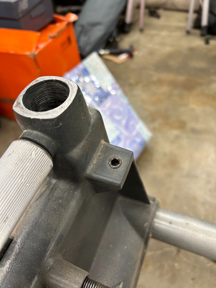

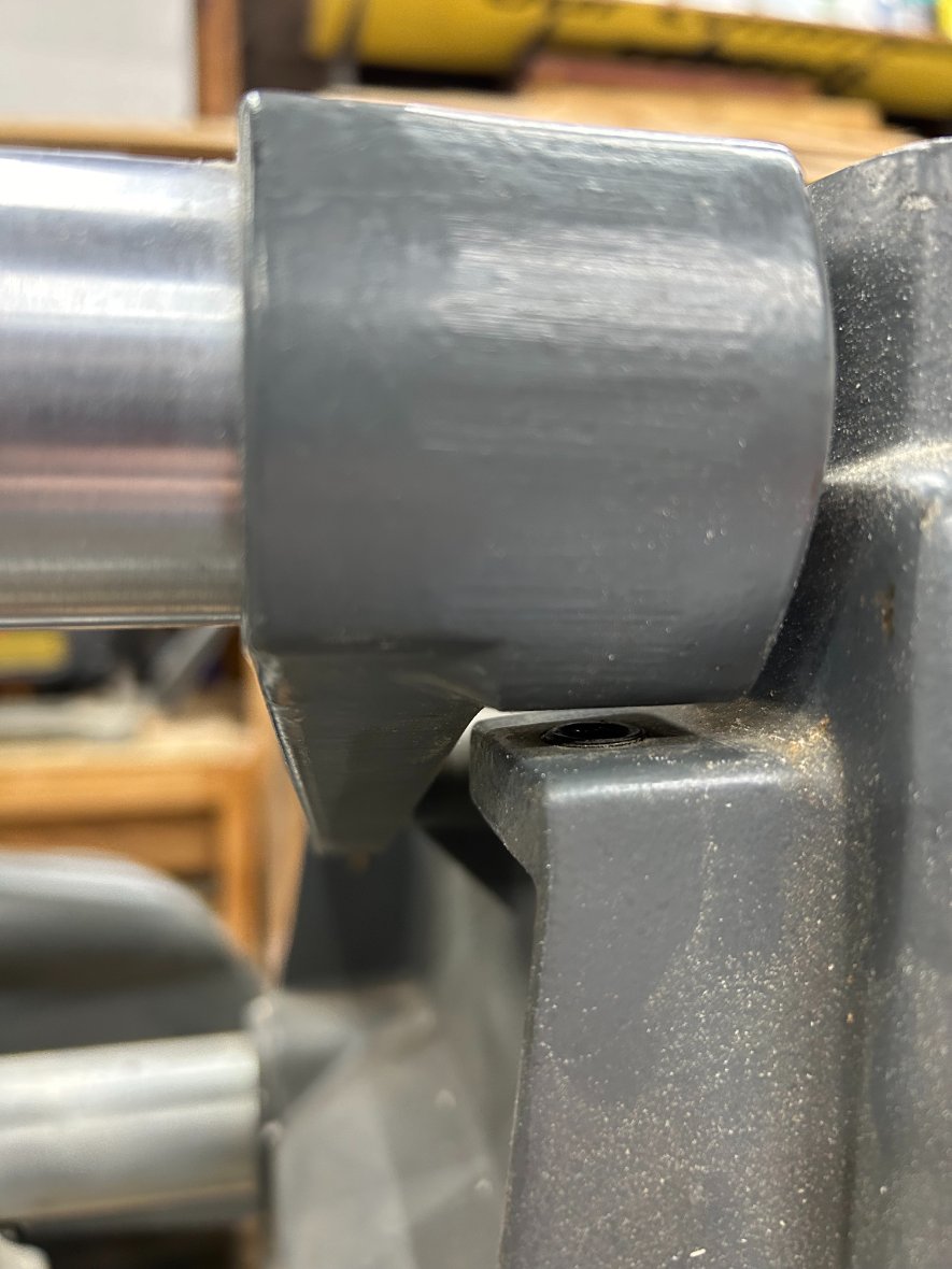

Ok, so the top way tubes definitely seem to be what is out of alignment. But I have no idea how to adjust this. The "back" (when standing as if operating table saw) is higher than the front. But it doesn't seem possible to adjust this. On the left side that lifts there is a screw on the Mark V legs that appears to be for this adjustment (see photo), but when the way tubes are down in table saw mode it doesn't even touch this screw (another photo). So I don't know how to get the backside of the way tubes lower, and there isn't a similar adjustment for me to raise the front.

The 'big set screw' is both upside down and out of adjustment, but evidently not causing the problem. IIWM I'd next check the lower bench tubes to see if they are similarly out of level. Assuming they are level front to back, I'd shift my focus to the Base end of the machine. When checking pairs of tubes for level front to back, it is helpful to check near both ends.

#1 The purpose of that big set screw is to place the way tubes in a non-twisted plane.
So adjusting it to do other things will screw that up.(I do not care if both Nick and Scott say otherwise!!!)
So apparently the way tubes are in a twist. That can be observed by the changing front to rear tilt(off level) as the main table is moved left to right...
To correct the twist loosen the tie bar and the screws retaining the way tubes at the hinge end. This should be able to cause solid resting on the headrest(including the set screw). It should also put the way tubes in a plane parallel to the bench tubes plane. If not all later adjustments will be futile. Retighten all 4 way tube set screws(leave that big un alone).
As for the big screw adjustment, I would only attempt it with a laser level that projects a vertical plane of light from the center of the aux table, over the center of the headstock onto a reversable reference(aux table tube mount with the center between the two mount tubes marked so it can be referenced both orientations. That procedure with subsequent proper alignment of an aux table will make the aux table usable on either end(with proper alignment of the end castings to the way tubes). Yes it ALL needs to be correct!
As for the headstock changing the twist, I surmise tightening the headstock lock will pull the way tubes to a different twist. If they are not twisted to begin with that should not have any effect.
This might take a week(end?) to correct.
