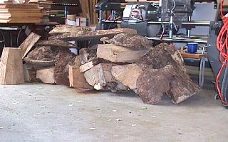

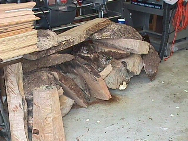

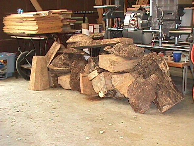

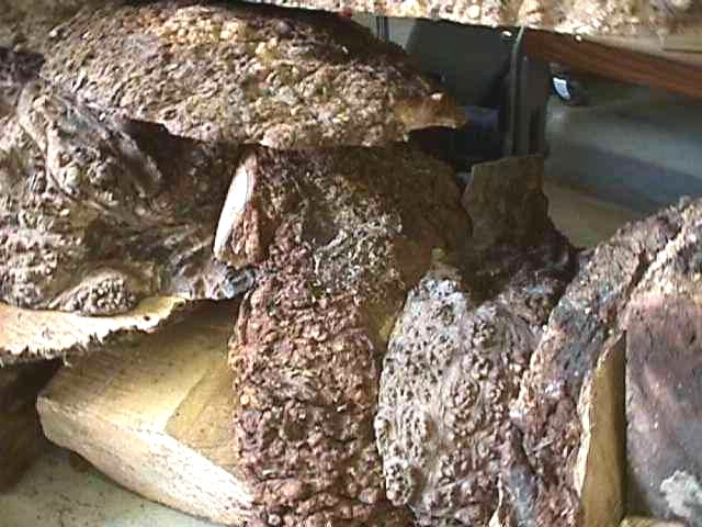

I have a few peices of spalted maple. I resawed 3 or 4 small slabs that I could cut pen blanks from. I would like to know about the process for stabilizing spalted maple. The natural spalted maple looks as if it maybe hazardous to work.
I had a pretty good size stack that set in the shop 4 or 5 years. I was at an auction that sold the stack of maple to a fellow where I worked. A couple of years later I ask if he had made any thing from the maple. He said he had not and was moving and need to get rid of it. If I wanted it I could come pick it, so I did. At the annual retirement party 04 or 05 I set at a table with another retiree and got to talking about woodworking. I ask him if he would like some spalted maple burl. He sure and I said come by and pick it up. This past December annual retirement party I ask if he had used the burl. He said that his wife wanted it to be gone and that he had give a few peices away to fellow making duck calls. I will ask at the next party if he is still storing the stack.

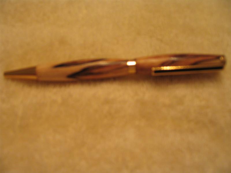

tom, i reccomend a backer piece and drilling with 135 degree split point bits. as far as stabilizing spaulted maple ca glue is the woodturners friend. drench the blank with thin ca glue turn a little and drench again. when you are done turning to final shape sand with micro-mesh , wax it and done. this is a spalted maple pen from last year. bad pic but good pen. fwiw the same method works well for turning corn cob pens.
