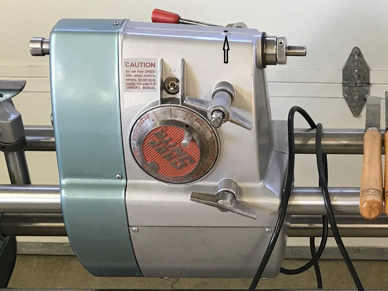

The picture below shows the set screw location indicated by the arrow which needs to be backed out to be able to remove the Quill.

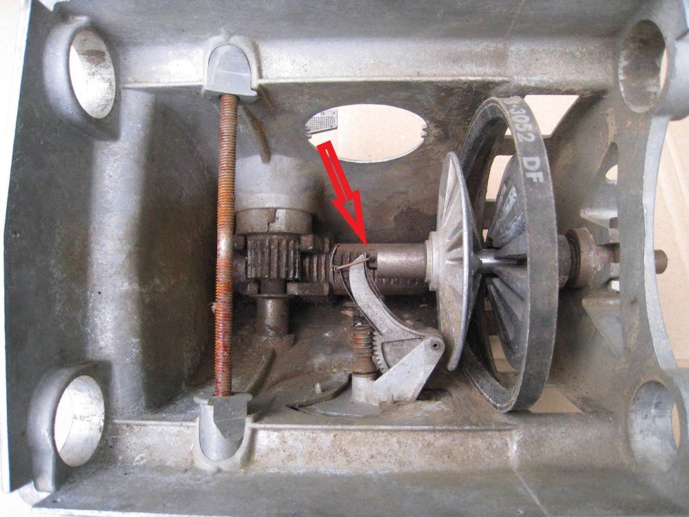

The picture below shows the loop from the back of the Idler Shaft Assembly indicated by the arrow that needs to be removed from the "porkchop" of the Speed Control Assembly. This view from the bottom has the Motor Pan removed.

The above casting is a "B" Headstock with the access hole (at the back end of the arrow) which allows lubricating the Idler Shaft Sheave and the gears of the Speed Control Assembly.

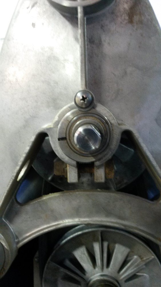

The picture below shows the end of the Idler Shaft Assembly held in the Headstock Casting. This is a later "B" Greenie Headstock and earlier "A" Headstocks will not have, unless modified, the screw at the top of the mounting hole. Remove the Cap Screw and nut at the bottom of the opening to allow the Idler Shaft Assembly to push back into the Headstock to remove. Some "A" Headstocks have a Bearing Retainer (P/N A3274) that the Cap Screw goes through to help keep the Bearing/Eccentric in place. This was an addition not in the original production of the Mark 5. It can be found in the second edition of the Owner's Guide 7:54 on page 26.
