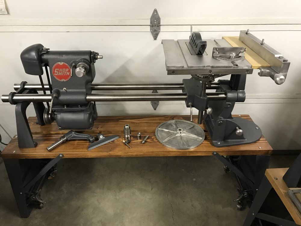

As John said serial number E-3099 would be from 1948 and is a Model 10E made in the Eastern Plant. It should look very similar to the 1947 Model 10E shown in the picture below.
_
1077 Reassemblied.jpg (120.8 KiB) Viewed 5209 times
This one has all the accessories shown that originally came with a Model 10E except a 5/8" Arbor plus it is on a bench (not included with the tool at purchase) that has the Metal Bench Ends and Retractable Casters that came out later. Pictures of your Shopsmith and accessories will help us better identify what you have.
