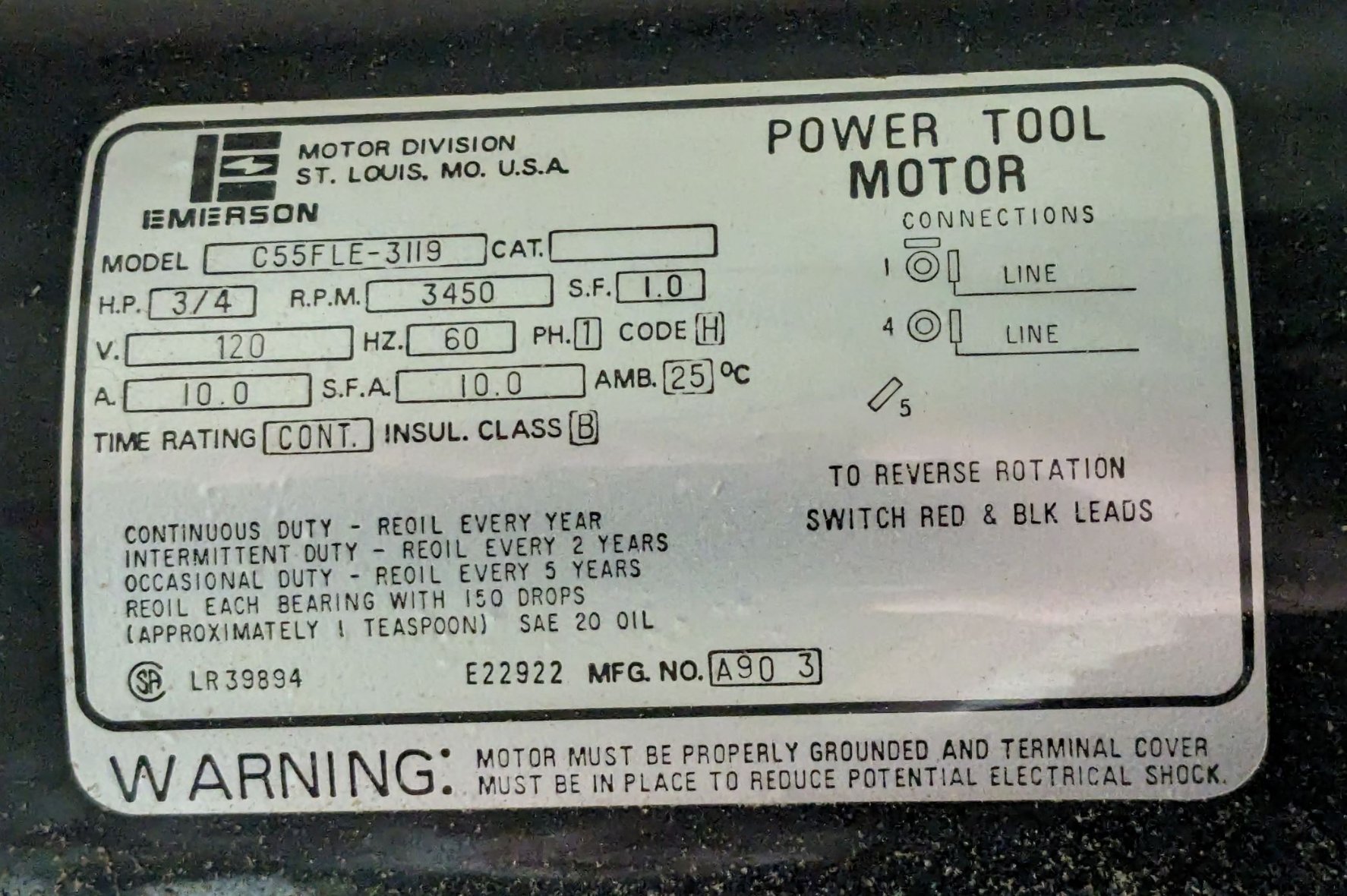

I recalled that the label on my Power Station motor specified lubrication intervals, but didn't see that on glarson's motor label. So here's a pic that I just took of mine.
Motor label.JPG (344.6 KiB) Viewed 5829 times
Note that the motor model number is exactly the same on both labels. Yet glarson's label declares that THIS MOTOR HAS PERMANENTLY LUBRICATED BALL BEARINGS NO RELUBRICATION NECESSARY", whereas mine specifies oiling intervals. This is inexcusably sloppy documentation / version control by Emerson.
In the "POWER STATION MAINTENANCE SCHEDULE table in my printed copy of the manual (from Sept. 1989), in the "Lubrication" row it states: "No additional lubrication is required, because the bearings are permanenty lubricated throughout the machine." "Sept. 22 '90" is handwritten on the front cover, presumably by the original owner to note the purchase date. So it appears that Shopsmith failed to update their manual after Emerson changed the label, and possibly the bearings, on that motor model.
When I purchased my machine used in 2012, the motor bearings felt and sounded a bit rough. So I disassembled it, and discovered that it had sleeve bearings, not ball bearings. And that they were running dry. But after I cleaned, oiled, and ran them in a little, the bearings felt and sounded perfectly smooth.
All this reminds me that my bearings are way past due for re-oiling, even for "OCCASIONAL DUTY". It's been 10 years now, but I filled the reservoirs with the specified 150 drops of oil at the time, and the bearings still seem happy.
So Dusty, I definitely don't think that you are "wasting your oil"!
